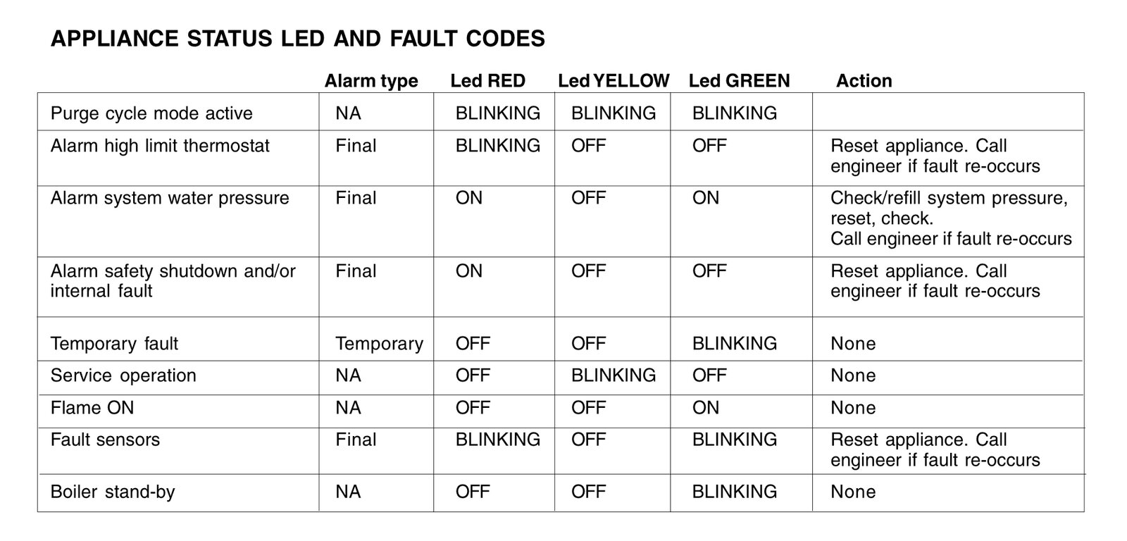

Noisy Vokera Compact 29 boiler
Not much more you can do on your own Im afraid, you will have to get someone in
It sounds like it. Thanks so much for your help, much appreciated.
No the boiler is on fully.
Ok, thanks. Looks like you’ll have to heed Ian’s advice then, he knows these boilers extremely well. I was just going from the manual:
