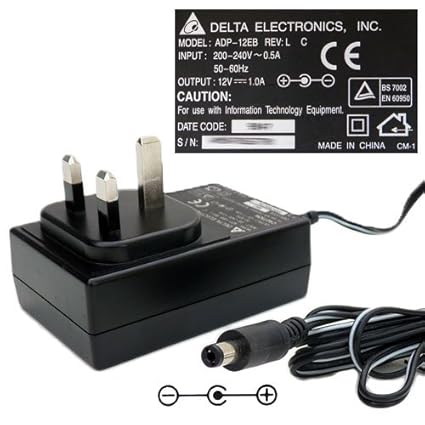

yes sorry my initital post was not complete its the adaptor from the mains to the control box
i added some pictures if it helps explain what i mean
Yes you just need to match
- voltage
- current (or greater)
- polarity (see the graphic to the left of the CE mark)
- plug.
Beware that there are a few similar-looking plugs that are actually slightly different sizes, both in internal and external diameters; in particular the 2.1mm vs 2.5mm internal diameter is hard to distinguish. The wrong one can seem to fit but not work reliably. Do you have a micrometer or calipers? Otherwise it's not easy to measure the internal diameter.

As John said above, you should be able to get an extension but there is no standard size for the plug. You will need to measure (preferably with a micrometer) the diameter of the plug, and the diameter of the pin which goes into the plug then find an extension to match. As an example this one is 2.1mm internal and 5.5mm external http://www.ebay.co.uk/itm/1-5m-DC-J...for-CCTV-/291155711375?_trksid=p2054897.l5662

In that case, as I said, you ought to be able to get hold of a plug-in extension. Your problem is that those sort of plugs come in all sorts of sizes (both internal and external diameters vary). Although eBay would undoubtedly be a cheaper source, it may be easier/safer to take your plug into a shop (like Maplins) to make sure you're getting the right thing - or you could be brave, do some measuring and try your luck on eBay!

Regulated power supply adaptor.
Model: Delta ADP-12EB.
Input: 200-240V, 0.5A, 50-60Hz.
DC Output: 12V 1.0A, Max.12W.
UK plug. Round tip connector, 5.5 mm / 2.1mm
assuming the plug size is correct (off to find my caliper) this is suitable ???
Yes (assuming it is 'reputable' and not a fake!!) - although, as has been said, the plug size is the $64,000 question, and the inner diameter can be very difficult to measure, even with a caliper (you probably need to find something which just fits into the hole, and then measure that).
