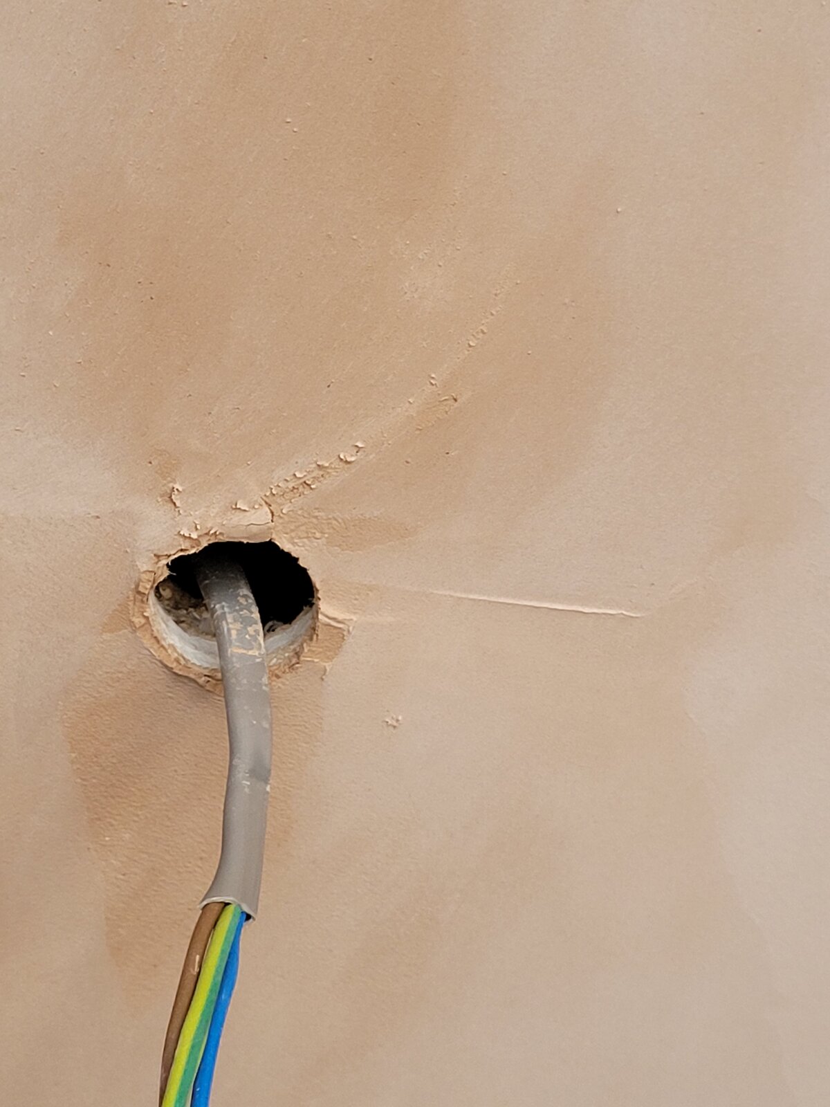

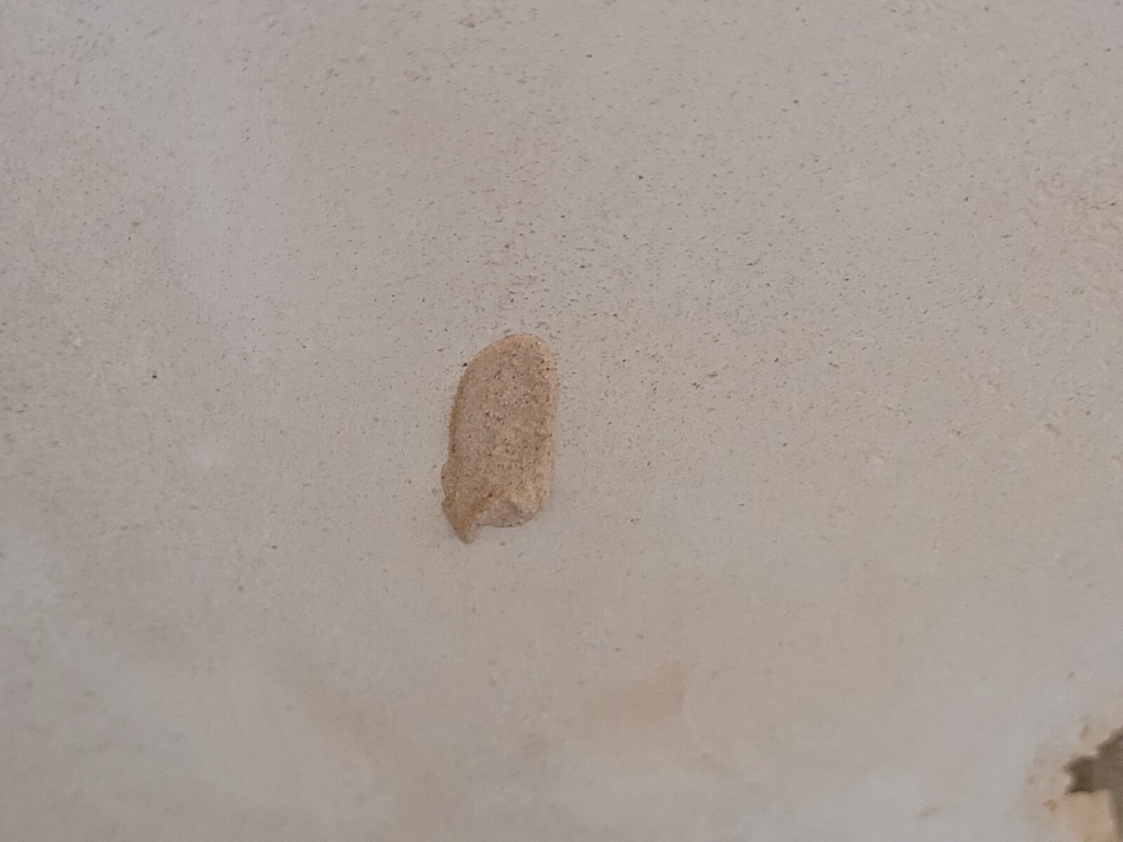

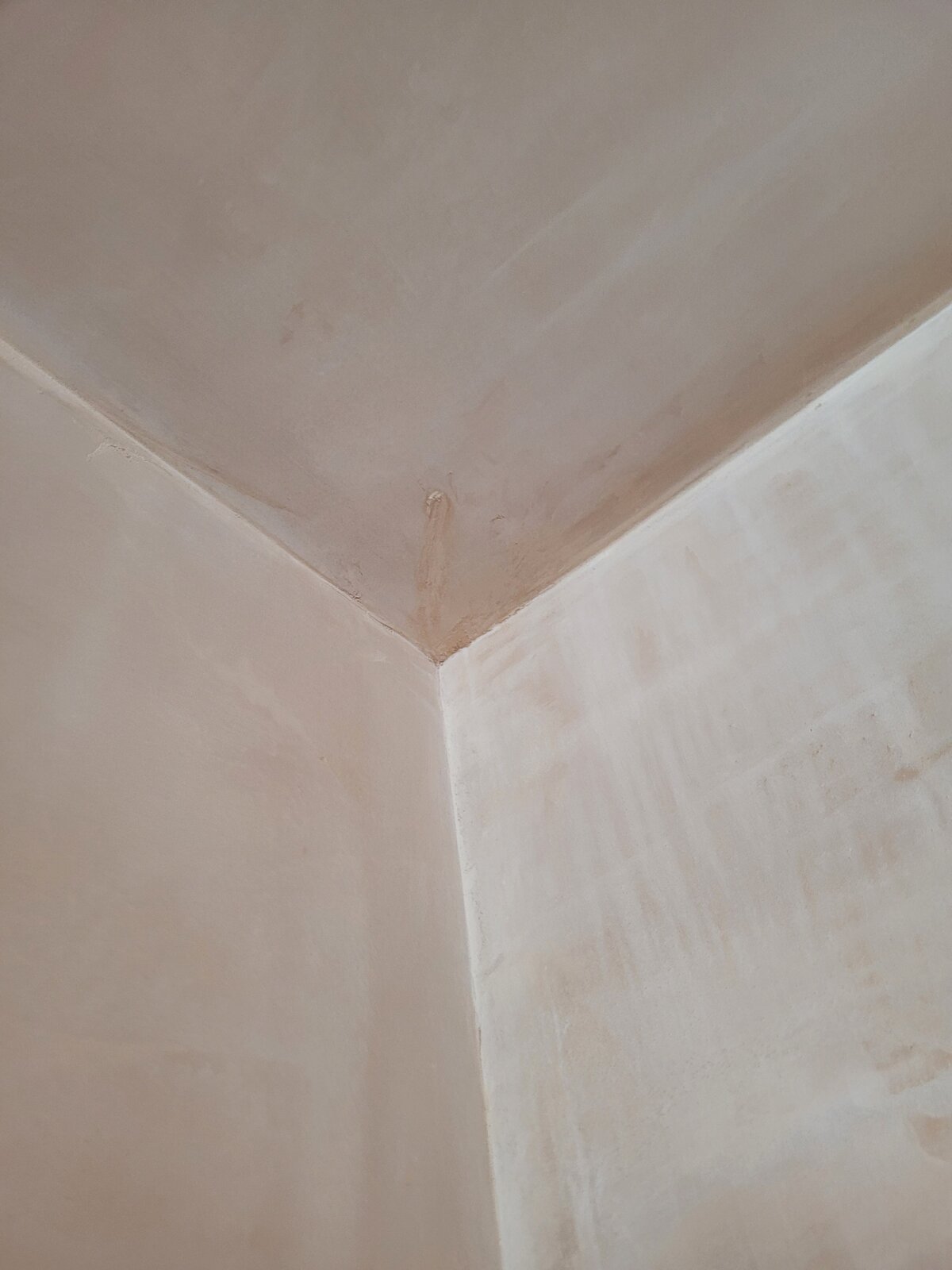

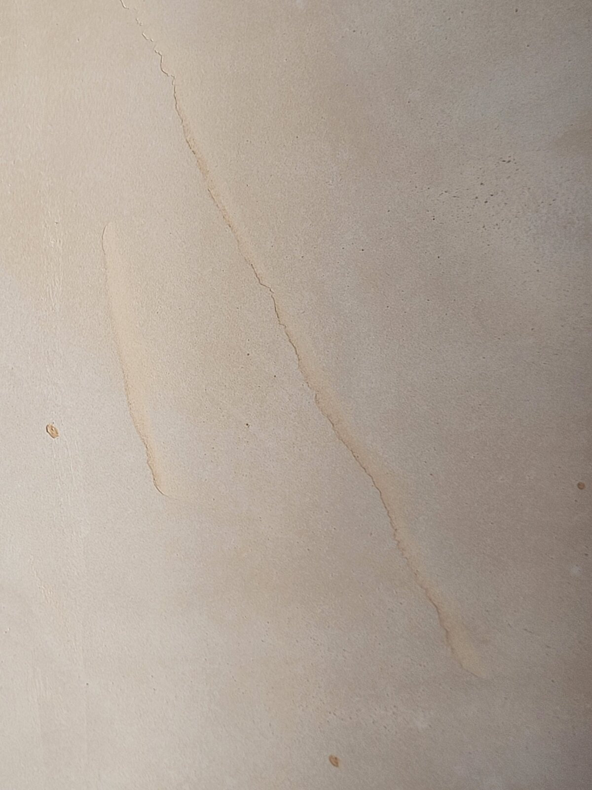

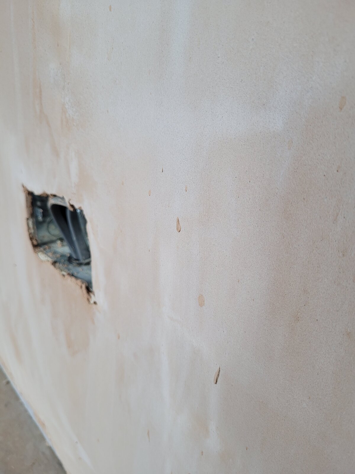

Hi all,
I got a plasterer in recommended by a friend. He wasn't the most expensive but also not cheap (3.5k for about 7-8 days work on a one bed with his workmate, South London). I went to have a look today and he said they'd finished the upstairs. I'm not sure what to expect as this is my first house but there are some small bobbles on the surface and trowel marks visible around light fittings. Should that be there? Is it normal that I get to point it out and he fixes it at the end, like a 'snag list'? If I accept the work then can I do anything to make a better surface before decorating? Apologies if this belongs in the decorating forum..
Rachel
The odd snot on the surface and some finishing work at edges isn't unusual, post some pictures up that'll give a better idea
Hi all, this is from upstairs - some 'snot' and some trowel marks. Most of the plastering looks okay though.

The snots of plater will come off easily when you sand the walls prior to painting.
Around light cables, same, just needs a bit of sanding.
The trowel mark shouldn't be there, but very easily rectified with filler.
Ask them to fix the trowel mark.
The rest will be done by the decorator.
As a decorator, I could deal with those snots pretty quickly.
Image number 2 is a bit pants though. I hope it is not indicative of the rest of the work.
As a London based decorator, I would probably charge a day or two to sand the walls back- up to £400. Possibly slightly less given that I would allow a min of half a day regardless of the quality of plasterer.
In short, the decorating costs will be higher if the plastering is not up to scratch.
