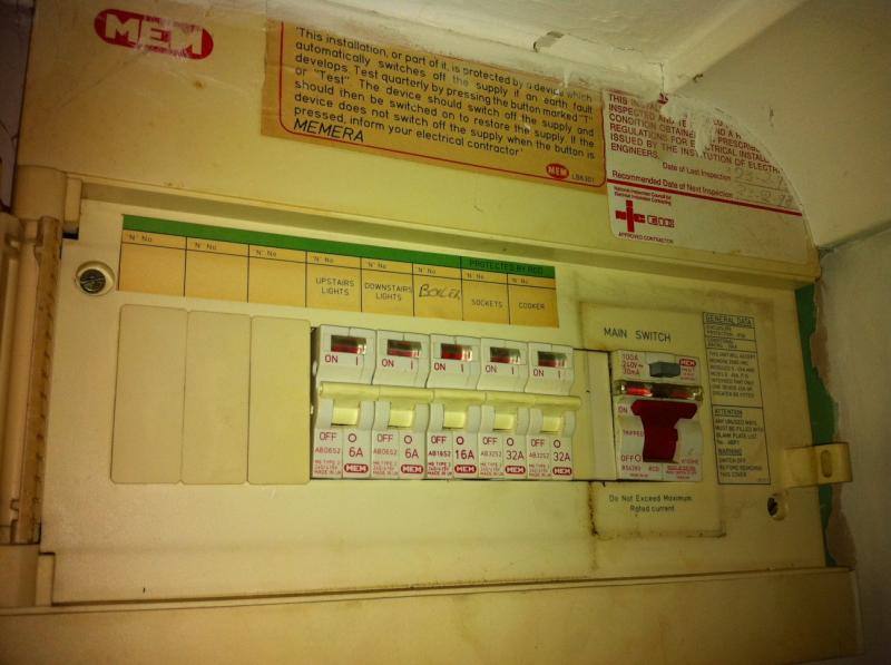

Meanwhile, just to clarify - is this RCCB (it's not a RCBO) also your main switch and therefore the only RCD in the installation?
Could you provide a picture of your consumer unit for us please?
If you have room perhaps a reconfiguration of the CU could alleviate the situation by sharing the loads with another device.
you have an A100HE which is a 100A 30mA RCD (it is not an RCBO), I will guess it is used as a main switch or perhaps you have a split load.
This is not now considered best practice, as you are likely to have a bit of background leakage from all the appliances and all the circuits in your house (especially watery ones like CH boiler and pump; immersion heater; kettle; washing machine, shower) and although none of these leakages might be much, all of them together may be approachiong the trip current of your RCD, so it takes little extra to trip it.
If you have a modern Memera 2000 or 2000AD CU, it can be fitted with RCBOs, which means each circuit has its own RCD combined with its MCB, so there is no accumulation of leakage from multiple circuits. This can cost a bit though as they are usually about £30 each.

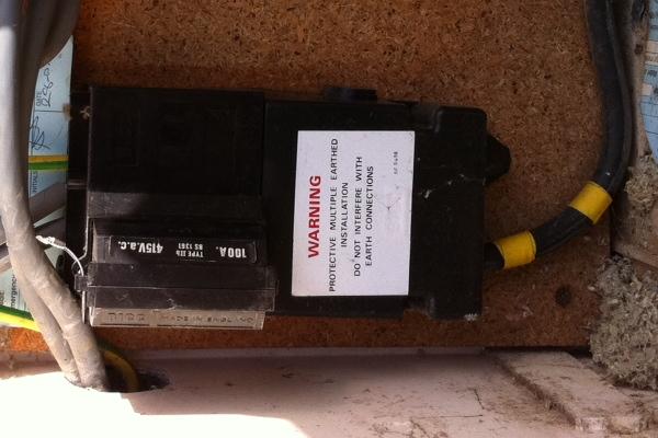

My UK Power Networks neighbour told me it was protective multiple earthing system, which is what the big sticker on the company fuse says too.

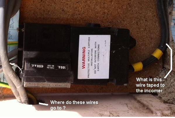

Pictures attached.

Is your consumer unit next to the meter ?
If so where do those wires go to ?
Looking at the incomer. Is it a thick cable with a thinner cable taped to it or is is two cables about the same size ? Could that cable be one of the network neutral earthing bonds to a rod in or close to the house.
Is there is a "deficiency" in the earthing of the neutral in the network ?
If yes then possibly the start up in-rush current of the motor in the strimmer could be bouncing the network neutral above ground and the bounce is affecting your RCD. But it would have to be a large motor to cause enough bounce to trip an RCD.
