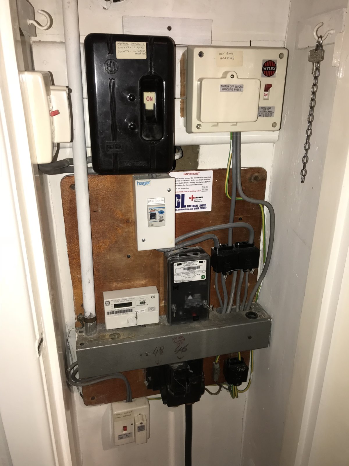

Which Unit
20A socket circuit and the cooker over to the RCD and then an RCBO on the lights and the other socket circuit. Job done. About £50’s worth of materials for two RCBOs
That sounds like a more laudably concise version of what I just suggested :)
Kind Regards, John
Yes, they did. They said otherwise I would not comply with the new regulations.
There were, of course, correct. What they don't seem to have also told you that there is no requirement to comply with the new regulations, which are not 'retrospective'.
Kind Regards, John
Thanks All, I will try to find out why they are not suggesting this way forward.
Exposed insulation where cable enters ccu
won't be fixed by changing the CU, should be fixed separately
Ring circuit arcking - one of the terminals is rattling
he should have tightened it when he found the issue! Are all the terminals faulty in the same way? if not move the wire.
some terminals not properly tight on buzzbar
tighten them or replace the MCB if they can't be tightened onto the bar
Earth wire on electric meter not standard
electric meter shouldn't have an earth? and it won't be fixed by changing the CU, the earthing should be corrected separately
The electrician is saying if the current consumer unit is updated to a RCD there may be more problems than if it was updated to a RCBO.
well, if he's making a markup on them, at 30 quid a circuit he can't go wrong! All RCBOs is indeed the silver standard where dual RCD is bronze, but totally unnecessary. You'd be better spending your money on a maintained (battery backed) emergency light on the stairwell and scrap the RCBOs. Then you'd be covered for power cuts which affect all circuits regardless, really the gold standard.
As a layman, it looks like the original install was lacking. Was it done by a shower/plumber installer? In my opinion, there is no need for RCBO's etc. You just need an electrician in for the day to test and sort it out. Rough estimate £25 per hour, you supply the coffee :)
If it were me, and I were letting it out, I think I would want to see RCD protection on at least the sockets circuits - not that I really think that it makes much difference, but it would be good to be able to indicate that such protection had been provided in the incredibly unlikely event that somone came to harm as a resulty of electricity in the flat. However, as I've said, that could be done by simply shifting the sockets MCBs to 'the other side' of the CU, without the need for any RCBOs.
As you say, it clearly needs a bit of attention from an electrician, but it certainly does not need a new CU, and the Op would be advised to steer of any 'electrician' who tries to convince him otherwise.

This, on the other hand, DID need upgrading

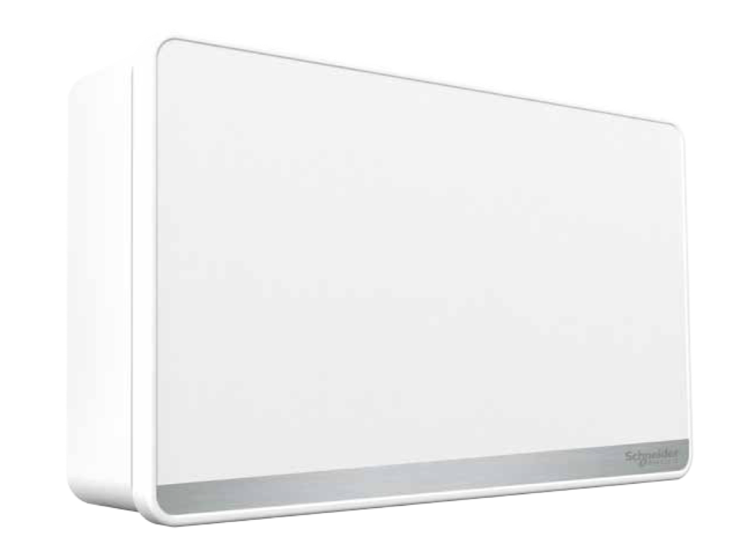

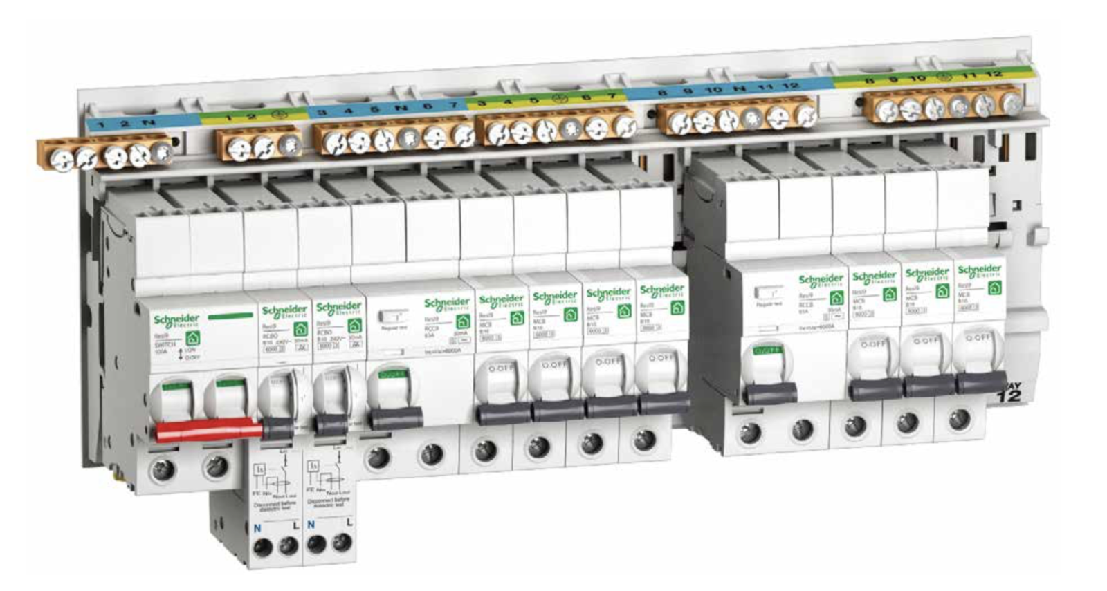

I think the Schneider Resi9 boards are as close as well engineered as you're likely to get to a Wylex Standard these days. They're based on the old Square D stablok style boards, the MCB pan is entirely shrouded, you can't touch the terminal screws with your fingers - you can with hager, as I've found out quite painfully once or twice. And as a consumer unit, they're not too ugly. Justharder to get your hands on for some reason.
