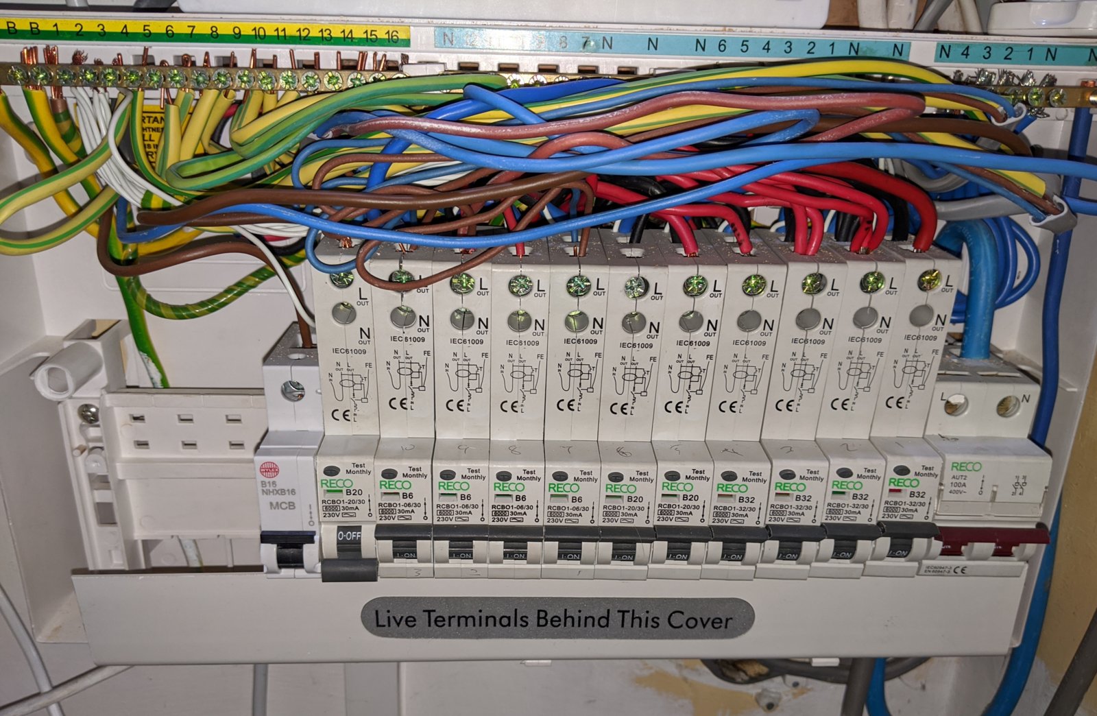

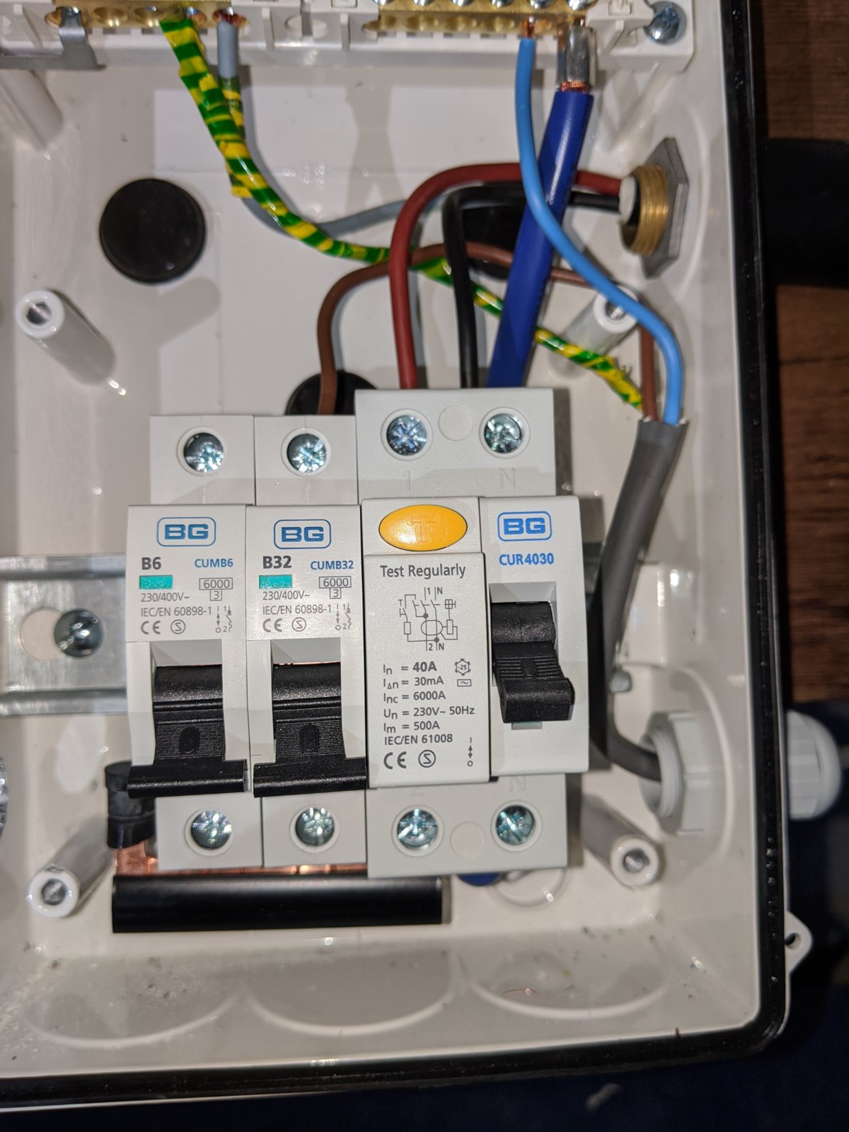

Trying to add Garage consumer unit and having an issue I was hoping for direction on. Previously garage feed was from house consumer unit via garage RCBO to socket in the garage with no problems. Was looking to get some lights & extra socket so purchased garage consumer unit kit so can have light and socket circuits and tidy the whole thing up.

House CU via Garage RCBO = 20A-30mA
Armored Cable 2.5mm 3 Core
Garage CU via RCD 40A-30mA
Garage CU via MCB 32A
Garage 2.5 Twin & Core to single socket

3: However, if I plug any load in it trips the "House garage RCBO only."
So looking for any advice on what could cause this? Nothing changed on the house side, and everything worked when was just armoured cable to the socket so am hoping its a relatively straight forward solution.
Was actually wondering if the trip was being caused by the lower-rated house garage RCBO which is 20A? Was looking to swap it out anyway to match both sides but could this also possibly be the root cause of the tripping?
Have provided some pics FYI and thanks in advance for any advice given...

One would not, except for marinas and caravan sites, feed a 30 mA RCD/RCBO from another 30 mA RCD/RCBO with SWA cable feeding garage normally in the house only a MCB is used.
However I would expect you have a neutral earth fault, while no current is drawn the neutral will be same voltage as earth, so there is no current flow between the two, when you put a load on the circuit the neutral voltage raises slightly so now current will flow.
So step one is turn off the garage RCD and test between neutral and earth it should be more than 1 MΩ and you should use an insulation tester which uses 500 volt to test, or 250 volt if you think the 500 volt may cause damage, but 9 volt of a multimeter may not be enough.
If fault not in garage then need to test house, likely you will need to remove the neutral wire to test, as the majority of RCBO do not switch the neutral. Again using a 500 volt tester.
If you find the fault with a multimeter then OK, but if multimeter shows no fault then there may still be a fault.
Thanks for the swift reply and guidance on tester I will look at swapping out the house RCBO for MCB as suggested. Regarding the problem I have traced it to exactly what you mentioned, I found a junction box I didn't know existed in loft that joined armoured cable to 2.5 twin and earth for consumer and sure enough it was the earth & neutral cables swapped. I have now corrected, and I have no more nuisance trips and can finally see the light :-) in the garage.
