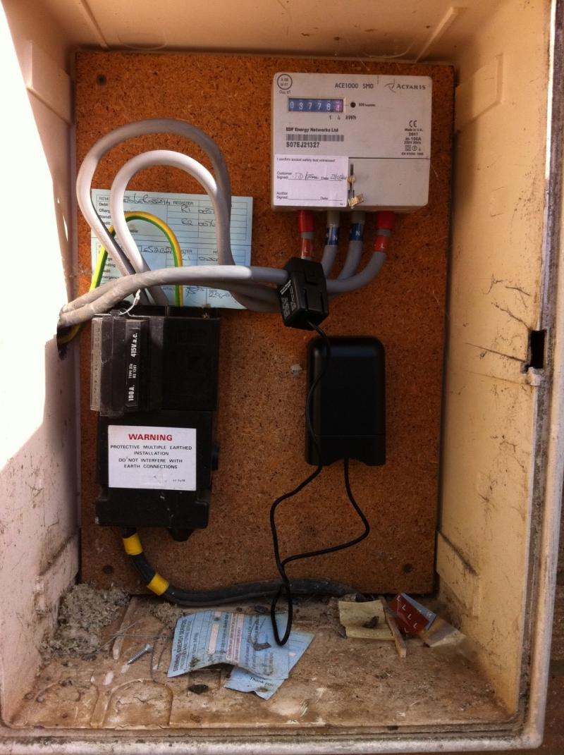

Nuisance tripping when neighbour strims grass
My consumer unit is in the kitchen, the meter is in an outside cupboard.
Attached another photo which hopefully shows where the cables go.
The cables that exit to the left go to the consumer unit AFAIK.
I guess the cables that exit to the bottom are the earths?
I'd say there is a 50-75% of my RCD tripping when my neighbour strims the grass.
That's a pretty strong link, but the fact that it's not 100% is also an interesting part of the equation.
I'd say it doesn't trip immediately, but usually happens after a few minutes. Last October when I was actually at home, I remember my RCD tripping three times in about 5 minutes of strimming.

Well, the whole thing is obviously rather mysterious. Even if your neighbour's strimmer were faulty (and we know it's happened with two different strimmers), that shouldn't affect any of the currents in your installation, and therefore should not cause your RCD to trip. However, as others have said, whatever the explanation, if other appliances in your house were running and already creating small amounts of earth leakage current, it would take less additional leakage to get to the 30mA or whatever needed to trip your RCD. So, yes, other appliances could be part of the equation - and that may, indeed, explain the fact that the strimmer does not always trip the RCD (e..g., the fridge compressor may, or may not, be on at the moment the strimmer trigger is pressed).
It would certainly be interesting to get an electrician to do some detailed testing to see if (s)he could get to the bottom of this. As has been suggested, replacing all your MCBs with RCBOs (and replacing the RCD with just a 'main switch' might solve the problem, but it might not - and would probably cost you around £170 in materials (for 5 RCBOs plus a main switch). Pragmatically, if one were going to do anything 'empirical' without actually having discovered the cause (not ideal, but there might be no altenative), I would have thought that the simplest and cheapest thing to try would be having the RCD replaced.
