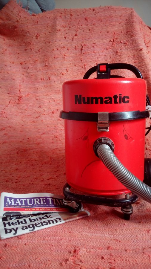

Hi anyone out there know anything about these amazing machines?Ive had this one for 25 yes TWENTY FIVE YEARS and it has never gone wrong ...until 3 weeks ago when it stopped.No smoke ,just stopped.Actually ,thinking about it,it was switched off but would not restart when switched on again.An electrician checked it and changed the flex.It was louder and more powerful than before weirdly .Then it would not turn on again.I looked inside the handle where the switch is located and it turned on again.Did I wiggle a loose connection?It worked for 15 mins then stopped by itself,whilst I was happily thinking my house would be clean again. Numatic are a big company who say they have a spare for every machine they ever made and this model is known to last 30 YEARS!!!!I tried to get them to take it for diagnosis but they did not reply.I asked them as all sparkys Ive asked told me to dump it.But why?Clearly the motor is good.It is working brilliantly....when alive.Help please.If there is an expert near to Ross On Wye that would be great.

Many thanks,will keep this link as may yet need a switch.ta..As I am not a engine/motor tech genius(lady -spanner-amateur) I took it for a free diagnostic at a local vacuum sparky.They said switch ok,cable ok,motor overheating.I have doubts they even bothered looking at it ,as due to age its not a big earner to fix..as obsolete bits....a museum item!!I thought these oldies at 25 years did NOT have an automatic thermal cut out,which is the problem the diagnostic person came up with.The next thing is I have a feeling it could be due to erratic, then none ,motor working, the carbon brushes? that numatic told me are obsolete.I have found that you can buy carbon and cut it to size though how it can be replaced and resecured inside the plastic housing I do not yet know.I know it must be spring loaded.Is it glued onto a plate beneath which lies the spring?Worth a try.
A replacement brush can be made by filing down a larger brush of the same general type. One thing to be careful about is the hardness of the brush. If it is too hard then the copper on the commutator will wear quickly. Too soft and the brushes will wear faster and create more carbon dust. Too soft is acceptable as brushes can be replaced easiily and dust removed.
Some brushes come with a pigtail ( flexible copper wire ) moulded into the carbon to make the electrical connection to the brush. When filing down a large pigtailed brush ensure that the end of the tail inside the brush is not exposed by the filing.
yes it is.a steel one with bigger wheels at the back castors at the front.Carbon is very cheap.are the brushes hard to replace?
