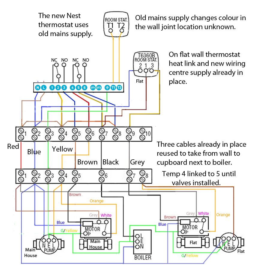

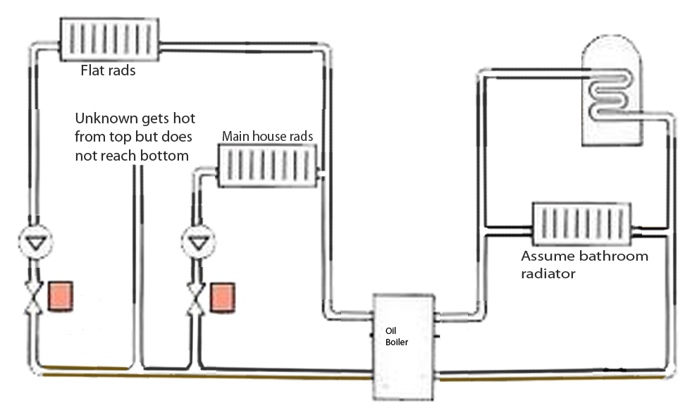

Praying on my mind are a number of items connected with heating my domestic hot water using my oil fired central heating boiler, thoughts welcome.
1) Plumber tells me I should not fit a motorised valve to the domestic hot water as there is no over run built into the boiler, so it could over heat if the thermo siphon is prevented, due to fitting a valve, the bathroom radiator and cistern hot coil can’t be turned off as it stands, except by turning lock shield valve on bathroom radiator, which only stops radiator working, hot coil is heated whenever boiler fires up, is he correct in what he says?
2) He says a by-pass valve is not required, the pump is on the return from radiators, and it has been found if one zone pump runs it causes the water to reverse flow in the other system, plus upstairs radiators heat up with thermo siphon even when no pump is running, so he is fitting motorised valves which will be electrical linked to pump so until valve is open pump will not run, unless the micro switch in the motorised valve sticks, is he correct that by-pass valve not required when every radiator is controlled by a TRV?
3) There is no thermostat on the cistern, so in the summer only control is time boiler runs for, at moment set to ½ hour a day, it would be hard to run wires between the cistern and the boiler heat link to control the temperature of the domestic hot water, and even if run, since no motorised valve it would only do anything in the summer, I note even at just ½ hour a day the boiler cycles off/on as the temperature hits 81°C when boiler turns off and 55°C when it turns back on again, so it would seem not needing full ½ hour, but that is the smallest time slot Nest will allow. Years ago I bought a wireless tank thermostat, but can’t seem to find any now, at least at a reasonable cost, I can buy a wireless room thermostat for £20 so to pay over £100 for a tank thermostat seems OTT. I am sure one can buy some wireless relay at under £30 but not found one that would not need an enclosure making for it which clearly lifts the price. However the first question is do I need it anyway?

In the mean time I needed to sort out wiring, so pair of wires between flat and main house now used to connect Nest heat link to wall thermostat to give it 12 volt power, the heat link fitted in flat, and all power now taken from a single FCU and all ready to wire in the motorised valves when the plumber returns. The new arrangement gives house priority the flat thermostat will run motorised valve and pump, but not the boiler, it is likely to be rarely used, and if house has turned on the boiler it should be enough to heat flat when we have visitors, the main house central heating and hot water will be controlled by generation 3 Nest.
Honeywell don't find this a problem! Here's their diagram for a C Plan showing the valve in the return from cylinder to boiler. If the valve is closed when the boiler turns off there is still a path through the heating circuit for any thermo-syphoning which occurs.
It's against the rules to have every rad controlled by a TRV. There has to be one rad without a TRV in the same room as the wall thermostat. Reverse circulation is normally controlled by a gravity valve in the return. Does the boiler manufacturer say that a bypass vlve is required?
Fit one . It controls the motorized valve which you will be fitting to the return. Here's the wiring diagram. You will notice that the motorized valve has a 2-way microswitch, so a 6-wire cable is required to the valve from the wiring centre.

There is a problem in that the central heating will thermo siphon so unlike your diagram there will be also a motorised valve in series with the pump to stop both thermo siphon and back flow when only one pump is used. So there is no flow if a motorised valve is fitted to the domestic hot water.
It's against the rules to have every rad controlled by a TRV. There has to be one rad without a TRV in the same room as the wall thermostat. Reverse circulation is normally controlled by a gravity valve in the return. Does the boiler manufacturer say that a bypass valve is required?
Nothing in the boiler (Wosrcester Bosch Greenstar Utility 18-25) instructions, the room with wall thermostat has a Energenie MiHome TRV head paired with it so both always set to same temperature, also the two joining rooms to hall also have the TRV heads paired. I have tried to work out what I have.
This is as far as I got, there are pipes going into loft space where there must be a top up tank, it would seem connected to the hot coil, but so much is behind plaster board a lot is guess work, you can see the unknown pipe, not a clue where it comes from?

I have included an extra triple and earth from heat link wiring centre to boiler wiring centre to allow for a motorised valve and thermostat to be added, however it is the route between the cistern and flat which is the problem, I remember years ago fitting a wireless tank thermostat for my dad, but can't find one now, at least at a reasonable price. Have looked at some sort of wireless relay but as yet not found one.

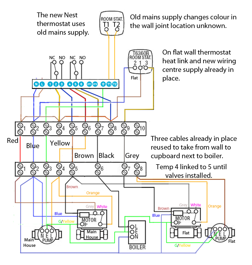

This is how I have wired ready for valves to be fitted, being careful to include colours so he knows how to wire, there is I know a fault that the flat heating will only work when the main house is calling for heat, however the flat will in the main not need heating, it is now a store, we will make it so visitors can stay, but it seems to heat faster than house, so don't see a problem.
Oh yes there is! "An automatic bypass valve must be connected between the heating flow and return where TRVs are used on all radiators, fitted to give at least a 3 metre circuit when activated.

Fit a non-return valves after each MVs. This will prevent any back-flow.
Why is the flat valve's brown wire connected to terminal 5? Normally it would go to terminal 1.
I have considered this slight variation which will reduce the load on the heat link relay contacts, running the pump direct from thermostat would release the micro switch in the motorised valve so the flat could run independent from house, but felt need to ensure the valve is open before pump starts?
Yes found it, I suspect that is why plumber says must not fit a motorised valve to the DHW as with no valve fitted there will always be a flow even if all TRV's are closed and all motorised valves are shut. However it does not protect the pump, only the boiler, so with TRV's on all radiators there must as you point out be a by-pass valve on both pumped systems, and with by-pass valves fitted then using the micro switch in the motorised valve to turn on the boiler and having valve and pump in parallel in the flat is not quite as bad, must ring plumber tomorrow to ensure he brings by-pass valves.

I have not found any by-pass valves, and not sure they would work with pump on the return? I am having two motorised valves fitted, as tests showed when either of the pumps run, then we get reverse flow through radiators, and top floor radiators get warm, not hot, when the boiler only runs to heat domestic hot water.
Plumber is due Monday to fit motorised valves, if some thing else needs doing, now is the time, the system will need refilling with inhibitor on Monday, so don't want to drain it again.
