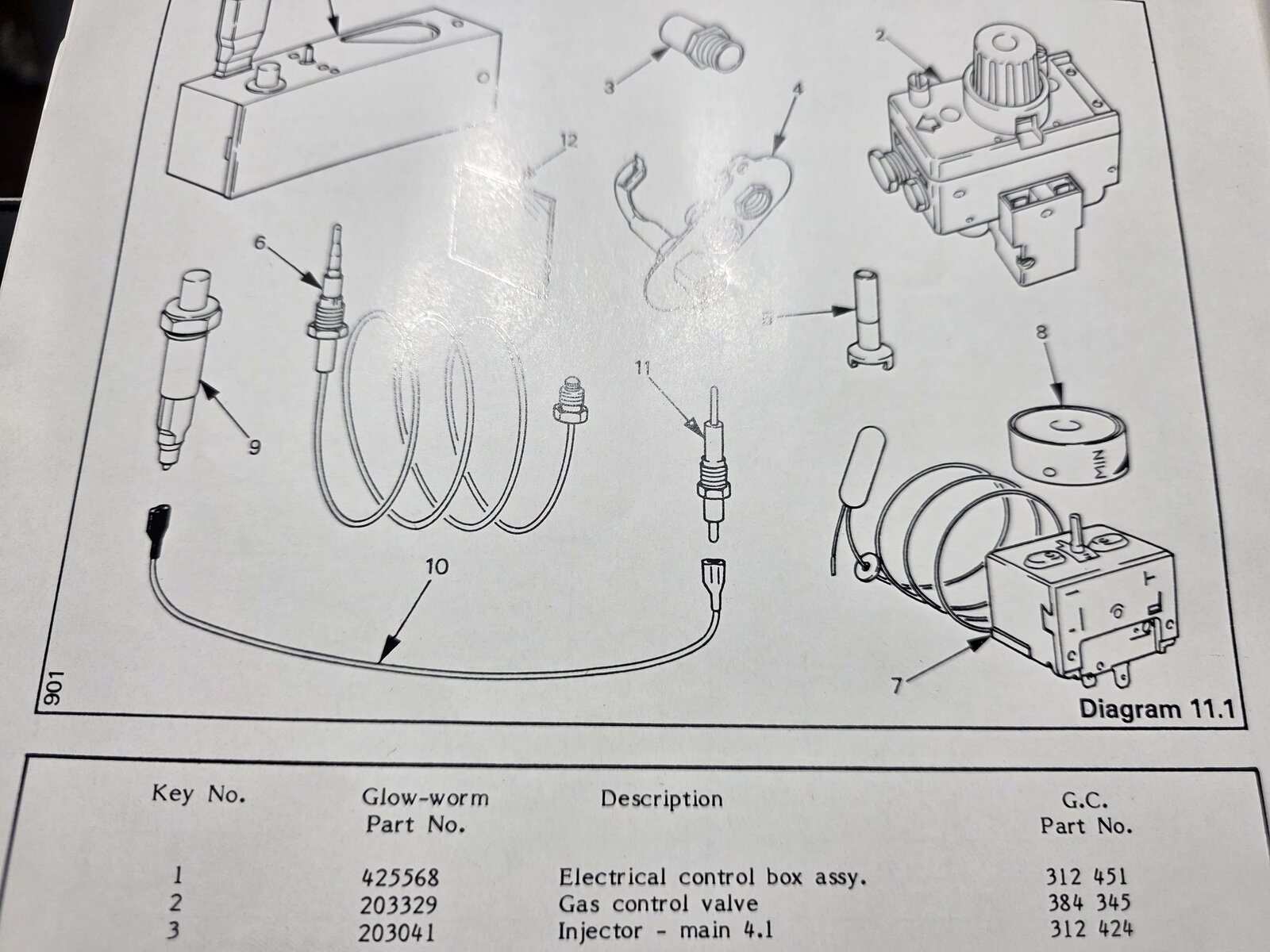

We have a glow worm Hideaway 60b and I suspect the gas valve is faulty - the pilot does light but that's about it. Checked the thermostat and thats okay.
The valve is part number 203329 which seems to be obsolete.

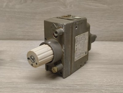

Look around eBay etc - there are some "new" old stock gas valves around. Some people bought a spare and never needed it !
Check the part numbers and photos.
PS Is that the manufacturer part number ? Should have a bit more detail manufacturer's name etc,

This is the original valve and the part number is what it says in the manual shipped with the boiler (Item 2).
One day working - next day not.

You need to look for the sticker on the valve itself to get the original manufacturer's part number.
I cant see a sticker - maybe its on the back of the valve. I have tried a couple of suppliers and they have said the original manufacturer ceased trading about 10 years ago.
