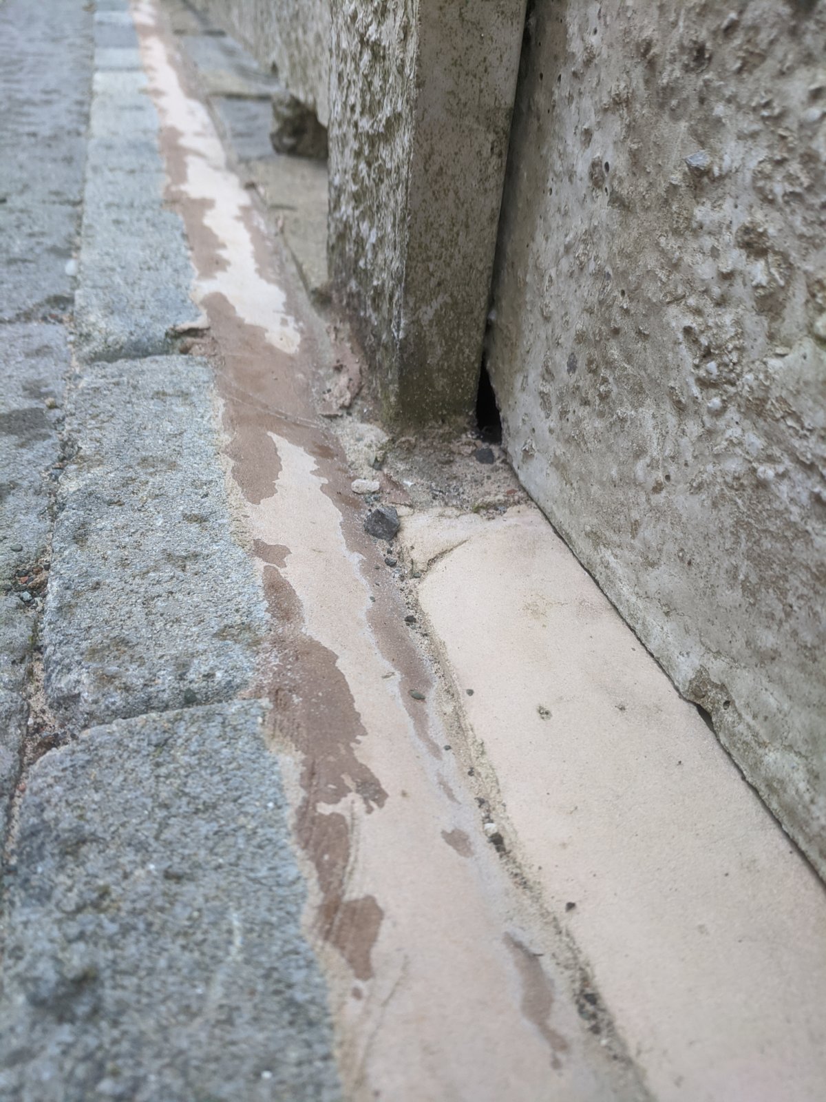

We had a brand new block paved drive laid last October and although this has been like this for a while, it's been dark going to work/coming back and wet.
This week when coming home I've noticed the below photo.
Thoughts please?
Thank you

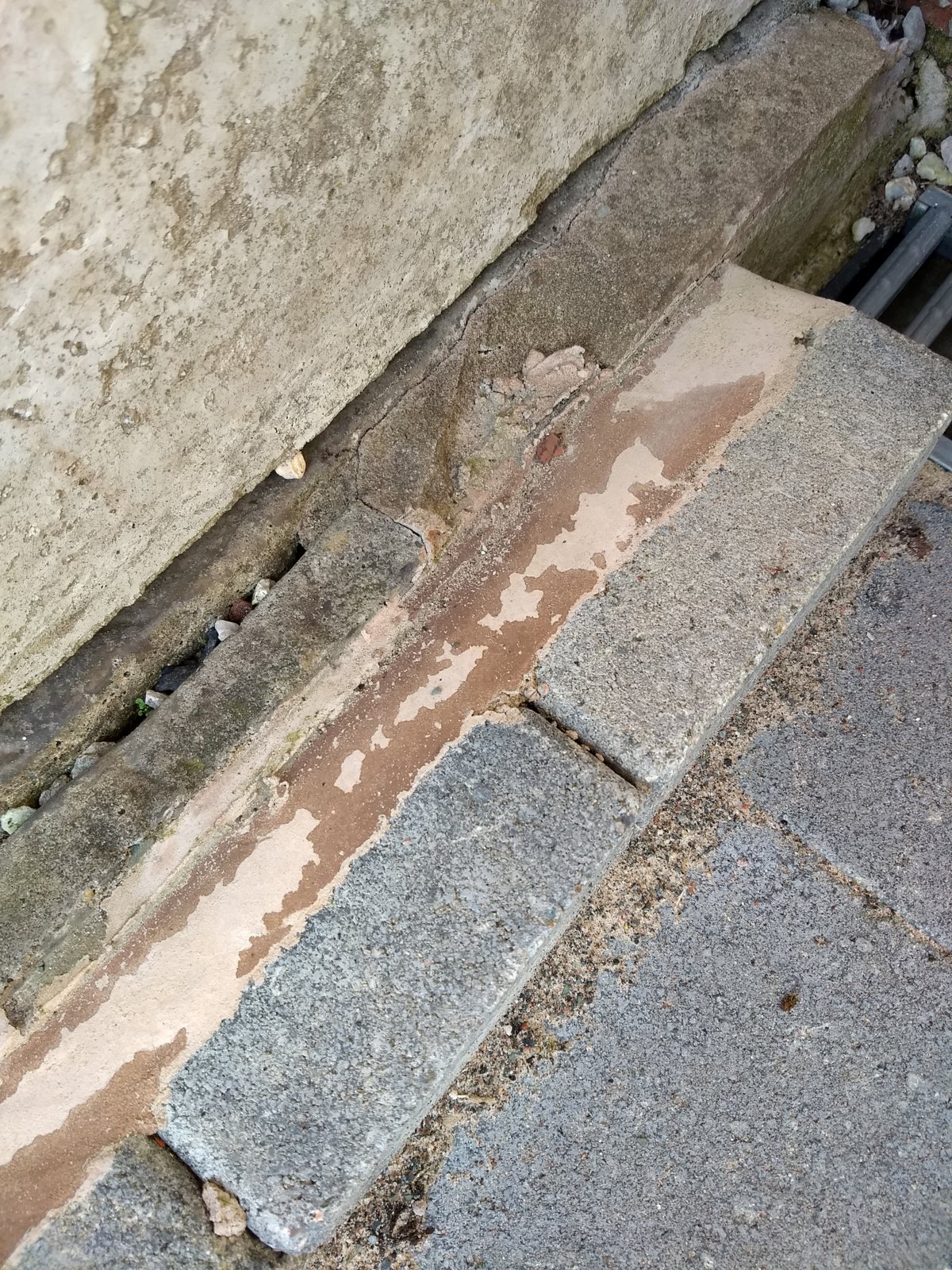

Yes driveway.
We have a fence between next door, so he halted a block and turned them up on there ends as the gradient changes about 2 ft before the garage door.
Just looks like a zebra styled mortar job! :confused:
I don't know any builders who have control over how their mortar behaves or looks during wet/dry periods. I don't know many clients diligent enough to care either.
Maybe the photo wasnt the best, I've just never seen any concrete I personally have ever mixed behave like that hence why I asked.
It looks like you have a mortar fillet as opposed to a concrete fillet. Not the end of the world but more susceptible to water ingress, especially where the mortar is more compressed in places than in others (zebra).
