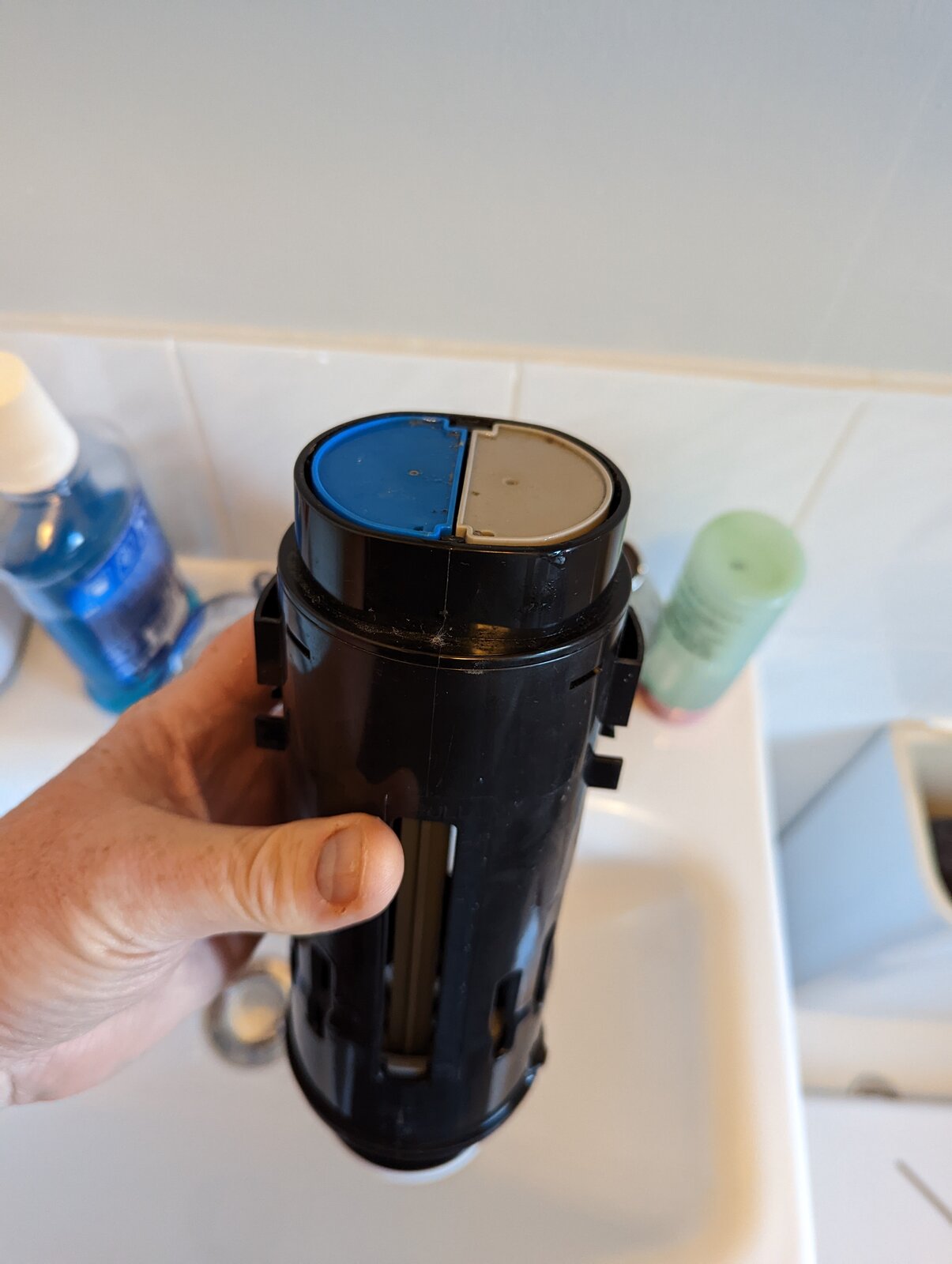

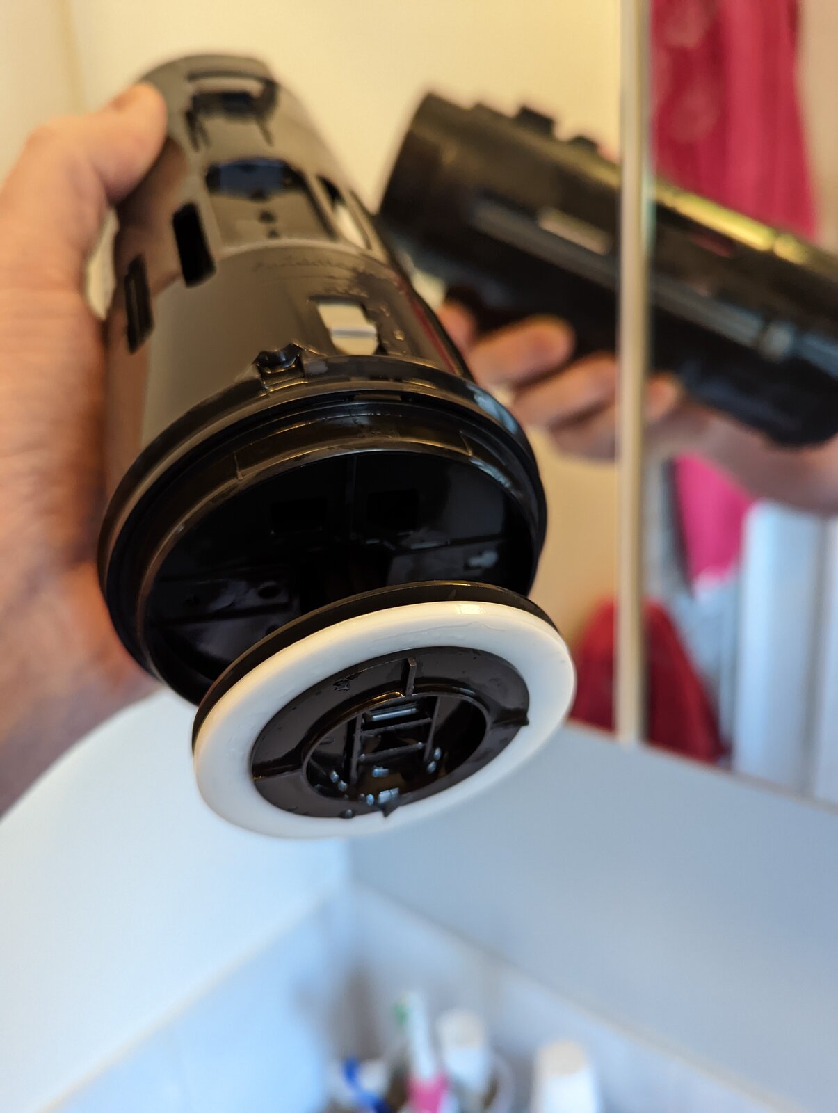

Odd whooshing noise
Would anyone be able to tell me which replacement part I would need, this is the current one and it just clips in to the base, one clip each side.

The white silocone washer on the left. Or the complete valve.
Look on fixthebog.co.uk for the same valve.
If the existing washer has pimples, pop them with a pin and squash the water out until flat.
Thanks, I had tried turning the washer around as it didn't look that flat, but that made no difference. I will give what you suggested a try, and then see what I need to order. Many thanks'
Many thanks, I replaced the large silicone washer and the issue us now resolved. Very much appreciated.
