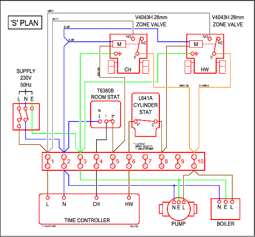

My understanding is that the BDR91 is just a switch, sending power to either the boiler or the 2 ports valve, everything else should be connected and work as any normal S Plan, unless there's a wireless controller/relay at the boiler. I think you need to go back to basics, remove the evohome temporarily and connect it all up as a normal S plan, check that it all works then work your way back to installing the EVOhome clean.

If it's not the BDR's, then testing of the rest of the system is straightforward. Power runs into the wiring centre, that runs to each BDR91, they switch the power out to energise each valve, on demand, when the valve is energised then the valve's microswitch switches the PermL out through the SL to the boiler/pump.
If there is strange switching going on and the BDR's aren't a problem then it has to be either a crossed/short wiring issue or one or both valves. The easiest way is to take it back to the start, disconnect the 2 port valves and test at each stage of calling, that way it can be seen where the problem is being introduced and live power test each component - PermL in (G) and SL (O) and work back from there.

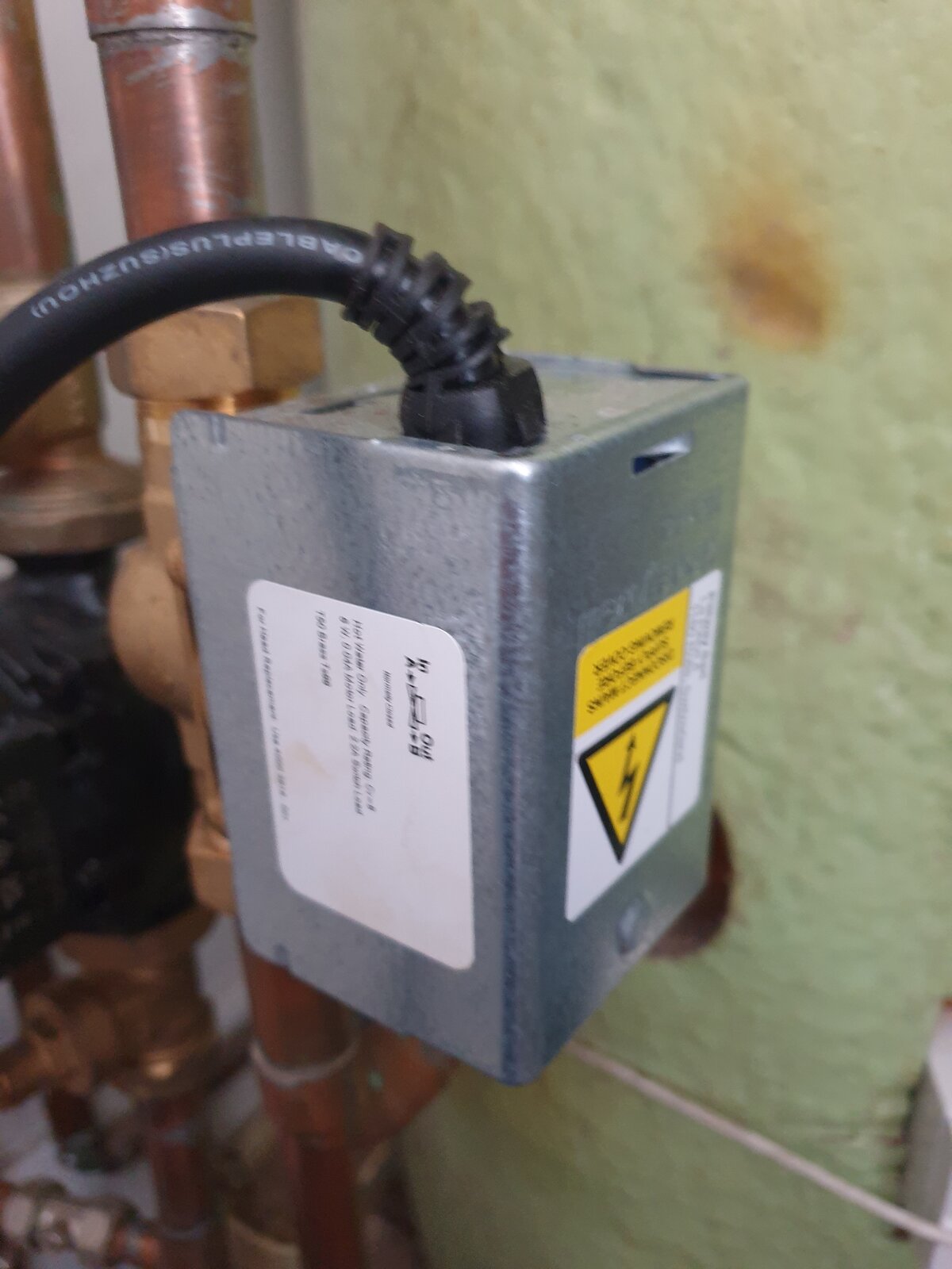

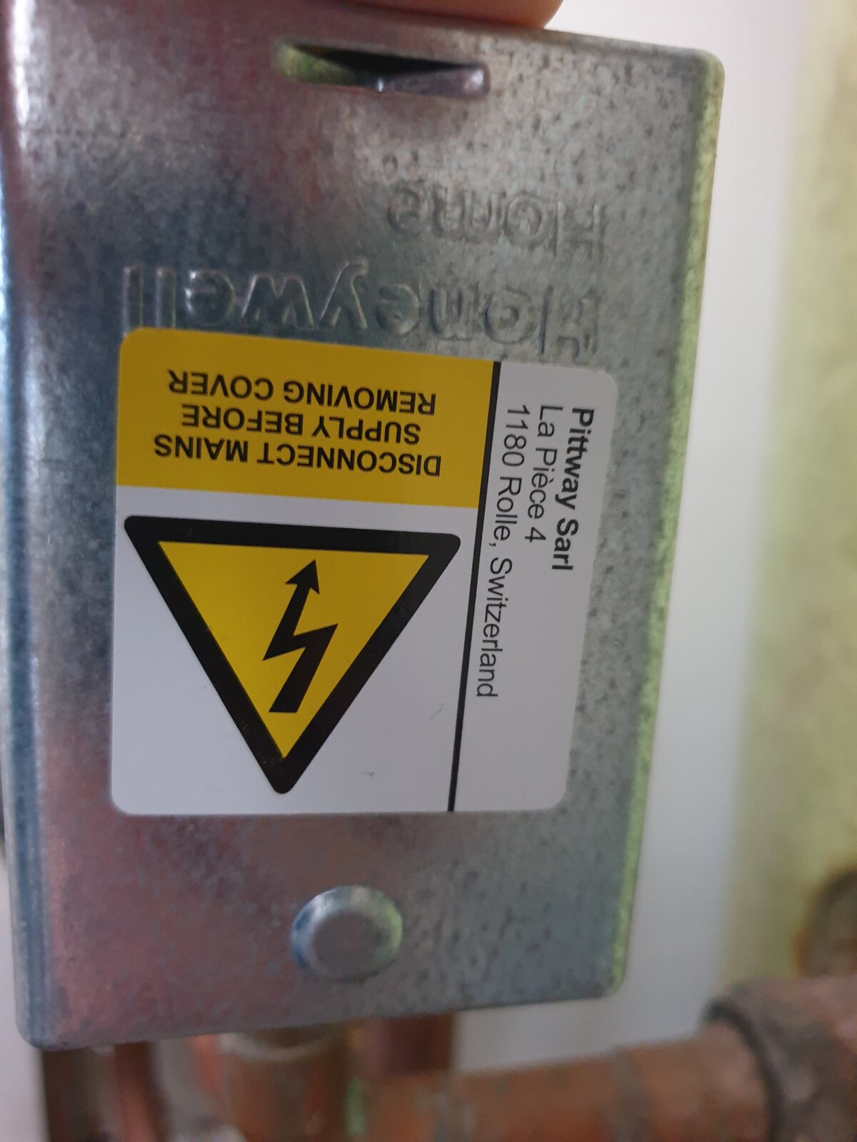

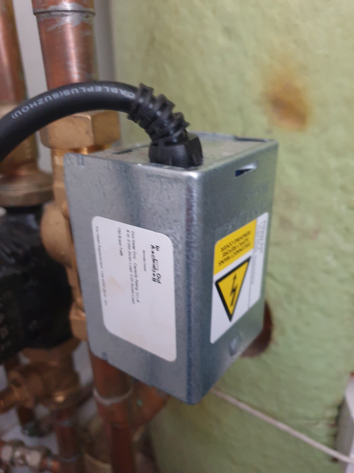

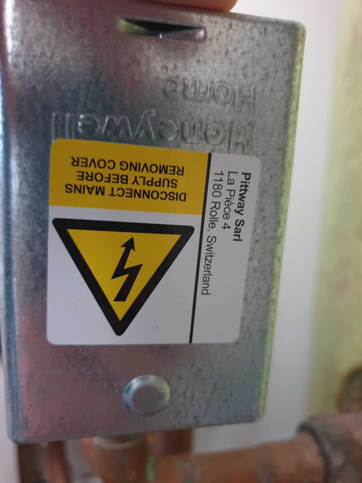

They are this type, don't know if they are good ones or not.
Cant see from the photo but if it has Honeywell stamped into the case below the warning label then it's as good as they get, if it doesn't then it may be a generic valve which tend to made of cheaper bits
They are Honeywell which are still probably as good as any, I'd say the chances of the two going faulty together are almost nil and looks to me like a supply voltage problem not driving them hard over,may still be worth checking the voltage with both energised even though both operating normally now.

Prudent thing to do is to check what voltage is on orange wire ( white would bE isolated if you have 6 conductors in the motorised valve cable) in each either heating or hot water demand. Brown and blue run the valve motor, grey would sometimes have 240 on it, other times a low voltage if the demand terminal is for non mains operation. When valve fully open, the switch within the valve operates and runs the boiler.
There are times when a priority schedule might be chosen which will require, say hot water cylinder be upto temperature before heating will come on
Easy enough to do when you know grey wire voltage needs to run the boiler when relevant switch in the valve operates.
BDR is a demand switch that tells the control system to get on with it. If the light on BDR is green, brown of connected valve will run till valve is open. Switch now energises and boiler will run.
