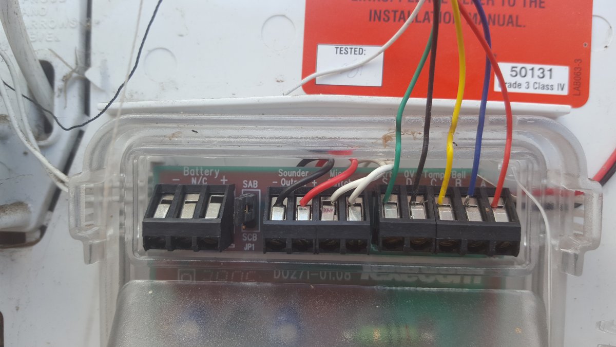

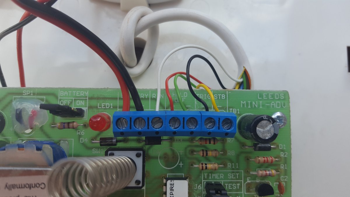

Hi.
I have an issue wherein whenever I connect the tamper from sounder 1 (Texecom Odyssey 1E) to sounder 2 (ADE Reson8), the siren in sounder 2 makes a strained 'squealing' noise (not the normal siren sound). The panel is a Honeywell/ADE Accenta G4 Mini. The LCD RKP shows 'Tamper Fault Lockout' at the same time.
The colour codes I am using for wiring are as follows:
Sounder 1 (Odyssey)
A = Red (12V+)
B=Blue (Bell)
C=Yellow (Tamp)
D = 0V (Neg hold off)
S=Green (Strb)
Sounder 2 (Reson8)
RTN- = White
HOLD OFF+ = Red
HOLD OFF- = Green
TRIG = Black
STB- = Yellow
Panel
T = RTN- (White)
A = Neg hold off from Sounder 1 (Black)
D = 12v+ from both sounders (Red)
B = Bell from both sounders
I have connected the tamper circuit so that the Tamp (Yellow) from the Odyssey goes to a terminal block in the panel. The negative hold off (Green) to the Reson8 is connected to the other side of the terminal block. The RTN- (White) from the Reson8 comes back to the panel in the T terminal.
Whilst troubleshooting I linked out the T and A terminals on the panel with both sounders connected as above and the fault disappeared.
I have verified that both sounders work OK as I connected them separately (as a single sounder installation) and there was no fault condition present when using either as a standalone sounder.
I have checked the tamper switches (that the lid screws keep depressed) on both sounders and they operate as they should as the circuit shows closed when using either sounder as a single sounder installation.
Might the issue lie with the Odyssey microswitch connections? (I am aware that if using two Odyssey sounders then a spare core needs to be connected to MSW1 and MSW2 on each sounder and joined back in the panel) but I was advised that it is not necessary to consider the microswitch connections when using a non-Texecom unit as sounder 2.
So I know that the fault is on the tamper circuit but I cannot isolate it. Hopefully I have just made some sort of glaring schoolboy error that someone will point out.
If anyone is able to assist me I would be very grateful.
Kind regards,
Gary
