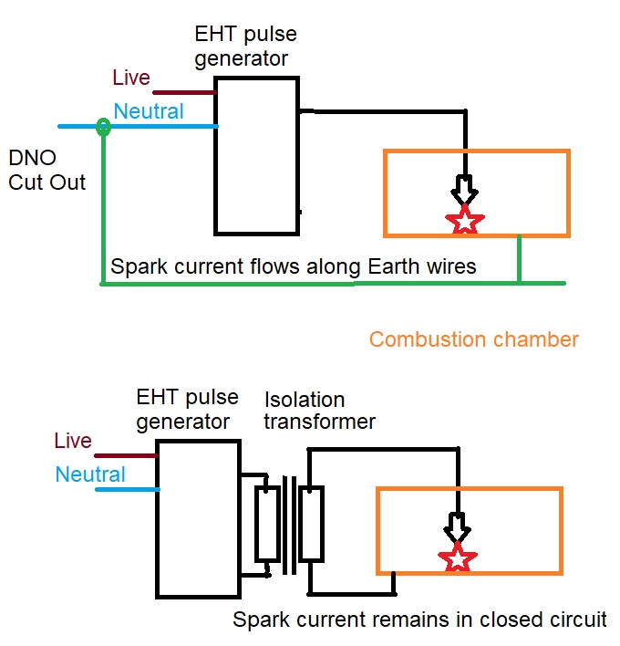

I think the problem is due to the ignition circuit involving the metal work of the combustion chamber. Hence the spark current flows through the metal work of the combustion chamber to return to the EHT ( Extra High Tension ) voltage source from whence it came.
If the spark current return the EHT source via Earth wires then the Neutral will be affected by high voltage spikes.
If there is in-adequate Earthing Bonding to the power source ( 230 V AC generator ) Neutral then the spark may be reduced in size and unable to ignite the gas.
If the EHT pulse generator feeds an isolation transformer then there is virtually no disturbance to the Neutral and an assured return path for the spark current,
Disturbances on the Neutral may be the reason why RCDs are tripped by a boiler that does not show any Earth leakage problems when tested.

Seems that it is using a closed circuit.
It does look that way with a tag on combustion chamber connected to one of the EHT terminals and thus not relying on a return path via the earthing/ bonding of the combustion chamber
