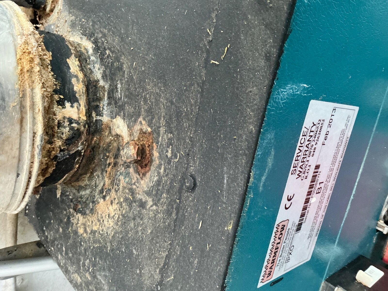

What is the nut in the picture for as mine seems loose and moving about.
Probably a flue sampling point. They often have a spring loaded stud to seal them but if that has rotted then someone probably just used a bolt to 'seal' it. The part below would replace it,.
