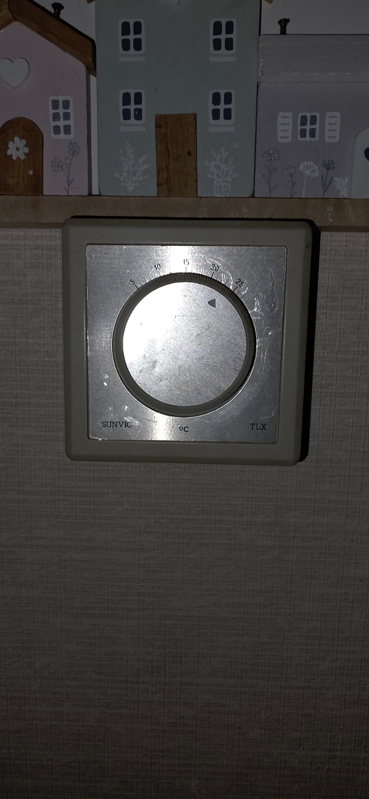

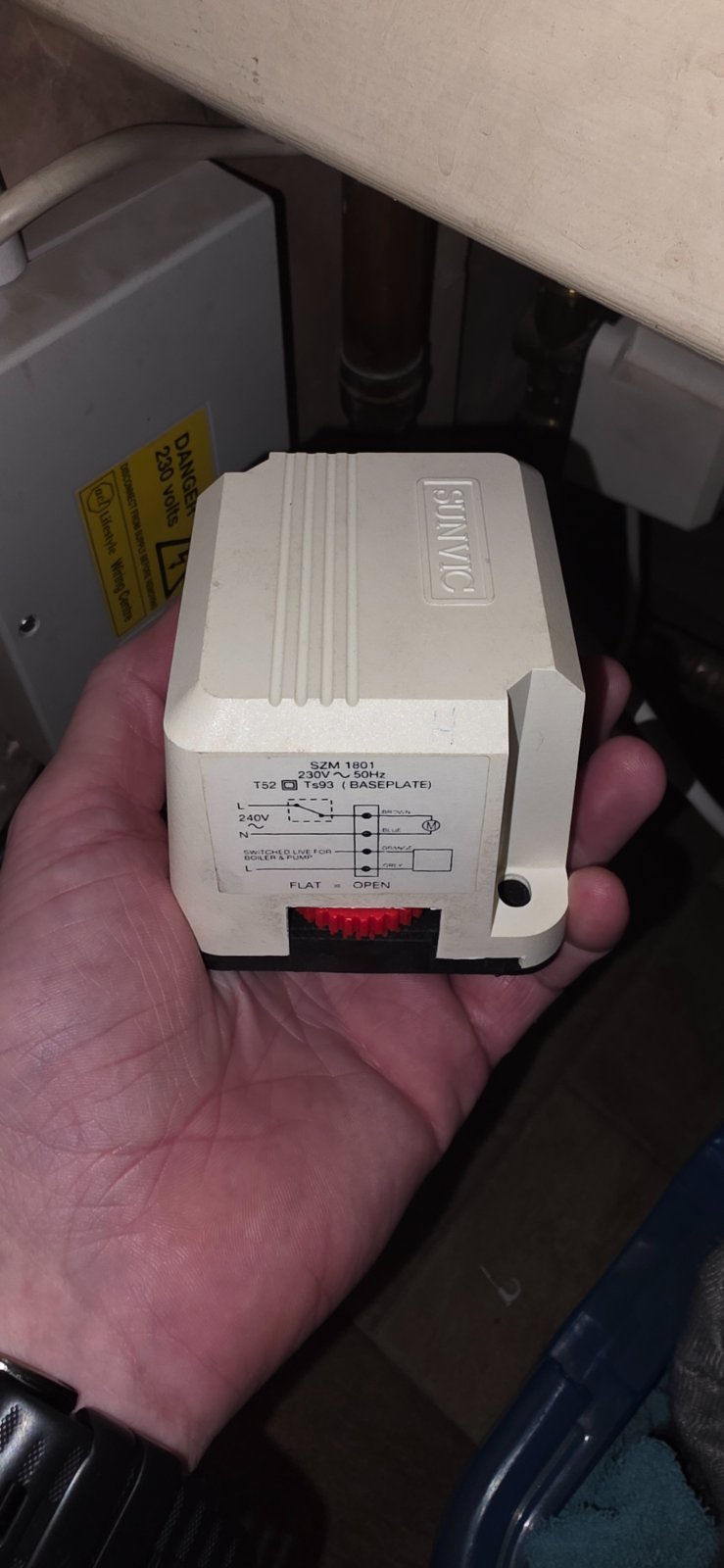

Hi,
I have an oil central heating system. The burner fires and heats the water no problem, but when i want to heat the radiators the actuator that controls the radiator automatically switches to the off position, If I manually turn the wheel to the on position it will stay on for a few seconds then again it will switch off. If i take the actuator off and turn the value on manually and turn the hot water on the burner will go and it will heat all radiators as long as the water needs heated. Wondering could anyone point me in the direction of what the issue could be? I have attached pictures of the actuators and also the thermostat which is in the hall of the house.
Thanks in advance
It is called a motorised valve, it has a micro switch inside, so the boiler will only run after it has opened.
I have tried reading the description, but can't work out if valve at fault, or what supplies the valve (thermostat and programmer) what tools do you have to test with?
Thank you for your reply, sorry i wasn't to clear in my description. I am competent with electrics and have a multimeter there and most tools if there is anyway you can suggest to find the fault? I should say i have already replaced the programmer and have the same issue.
As I see it, the top connedtion is a switched from your room thermostat the 2nd one is neutral, the third is a switched to boiler and pump whilsthe bottom is a permanent live. If that is how it is wired, then I would be inclined to suspect the actuator. The only other complication that may affect it is if the permanent live is commoned with the switch live. Assuming the hot water valve is the same model, could you swap them over and see if the fault follows it.
Hi, thank you for the suggestion. The hot water and radiator values are the exact same model so let me swap them around and ill get back to you shortly. Appreciate the reply
Ok, I have swapped over the actuators. So the situation is still the same were the water is working as it should but the heating value keeps turning itself off even after i manually move the wheel to open. Any other suggestions. Thanks again
Another update. I tested the switched live for the radiator value with the heating turned on, putting the thermostat up full I am still getting zero volts. This leads me to think the thermostat is faulty?? Can anyone recommend a direct replacement for the sunvic TLX 2356 thermostat as they are no longer made?

It's a MOMO actuator, Eric. The OP's description, sounds a little confused, but I would suspect the actuator....
If both of those actuators are identical models, I would try swapping one actuator, for the other one, as a quick way to eliminate that. Failing that, then the actuator is simply not getting the signal to open.
If the fault didn't follow the actuator, then the problem is with wiring. You mentioned you have changed the programmer; from what to what?
As the actuators are motor open/motor close, opening manually will be overidden by the controls. In the heating mode, follow the current path through the junction box . I suspect you may find a faulty room stat.
