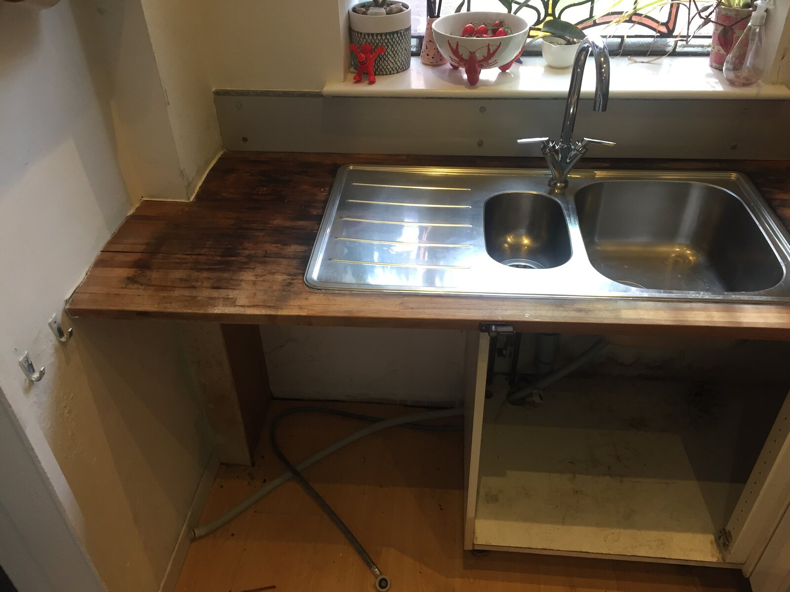

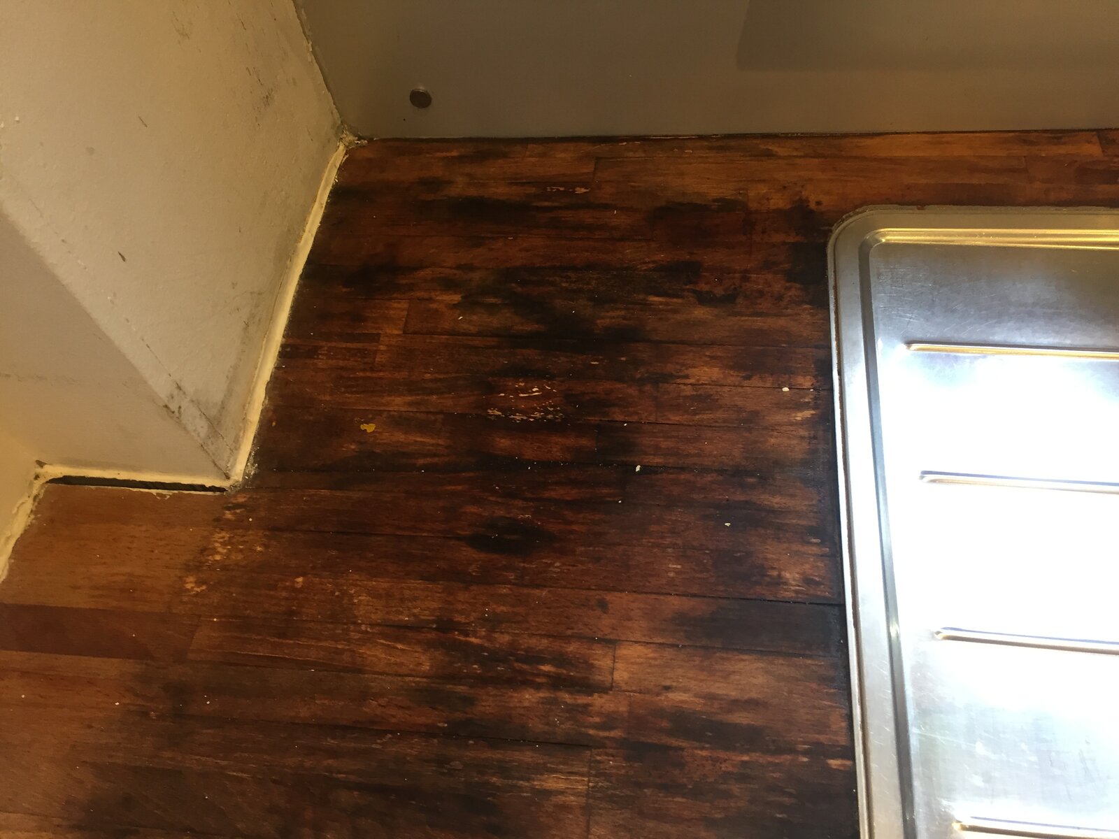

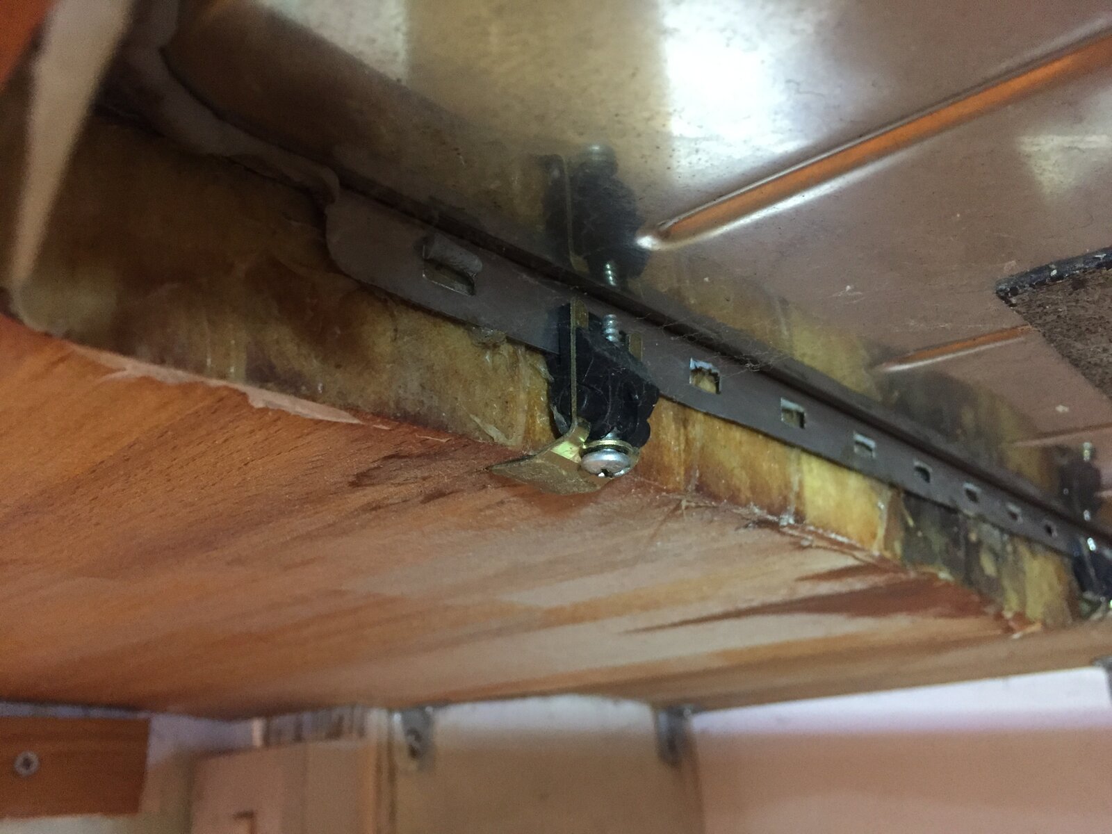

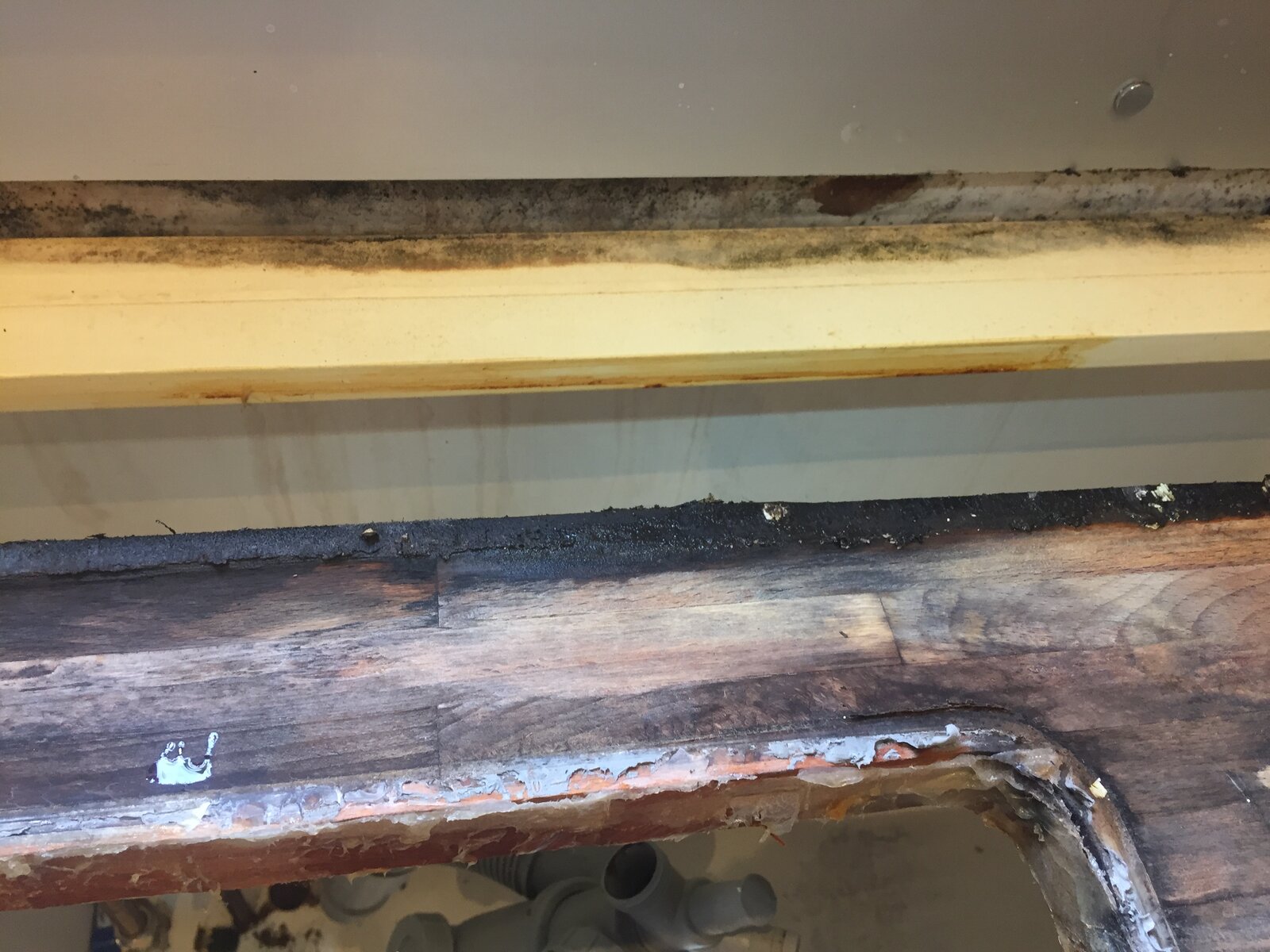

I know this is a decade on - but I’m in the process of replacing a worktop where the underside was not sealed. You can see from the photos I have uploaded that the whole thing has warped out of control and is black and mouldy. Interestingly, the instructions that come with the new oak worktop from B&Q indicate that only the top should be oiled - I will not be following them.
