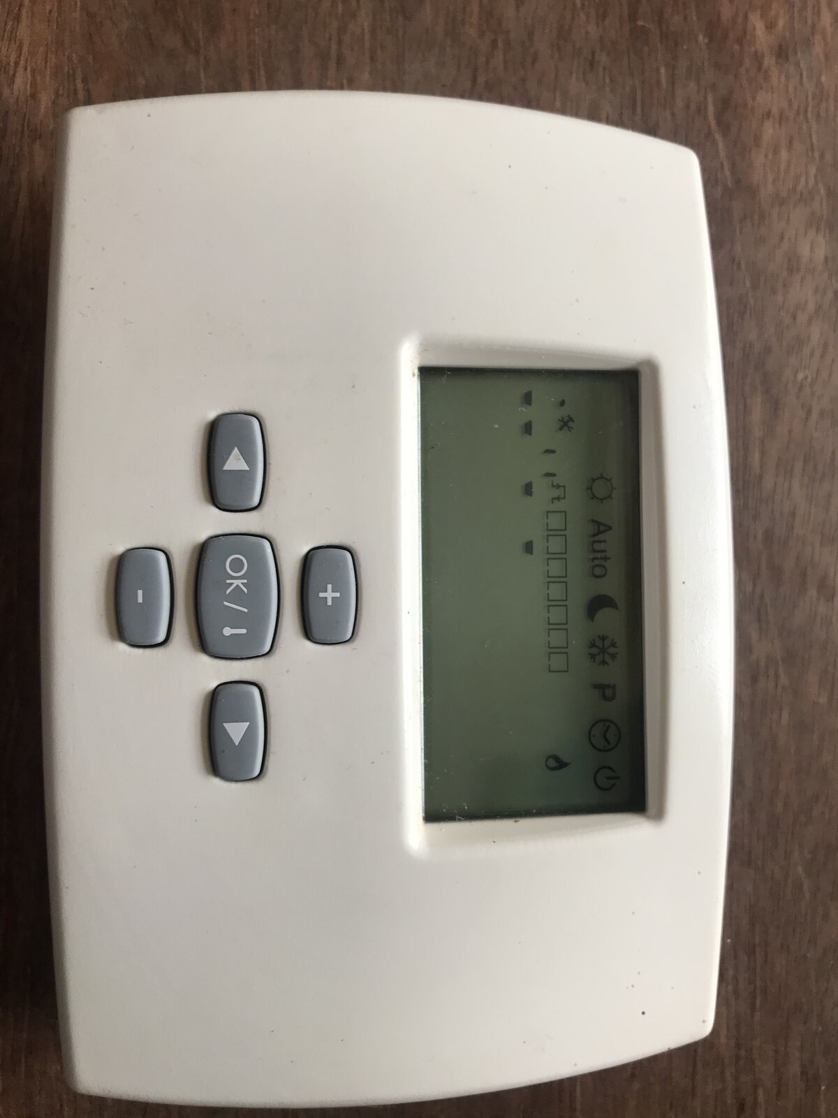

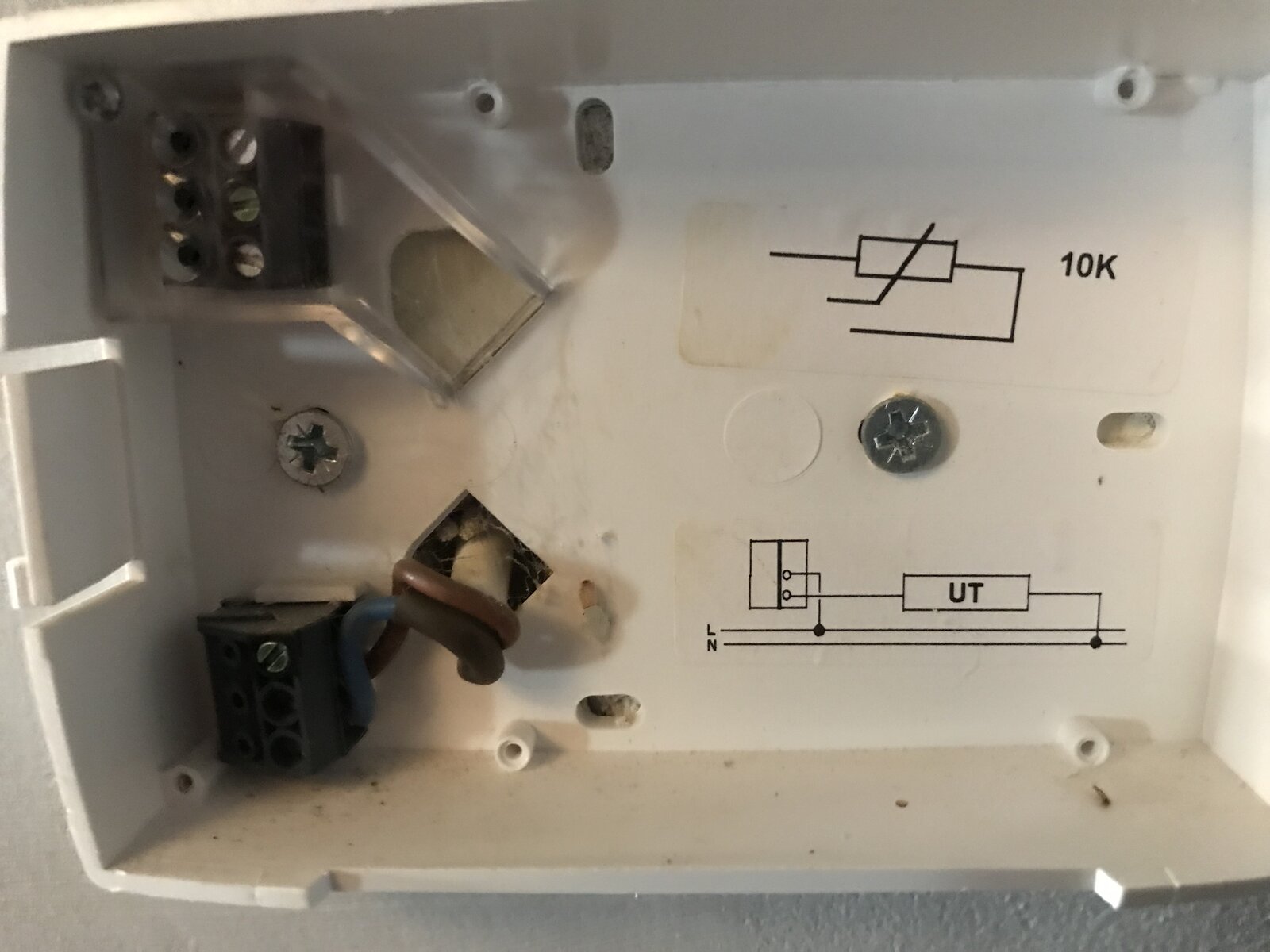

Hi
Trying to replace wired programmable thermostat as in photo.
There is no branding on it but the QC label says it’s a Watts Milux P3350.
I can’t find that on Google but the new Milux stats seem to have 3 wall connections whereas mine has only 2.(brown blue mains)
Any advice gratefully appreciated.

I think it should be fine - the newer stats also have a NC (normally closed) connection to the relay; this would allow them to integrate into cooling systems (A/C units), in other markets.
What is the model of the new thermostat you were you looking at?
Thanks RG.
Think I’ve solved it, looking on the Milux website it seems that although there are 3 terminals it is fine to use 2.
Many thanks for your attention
