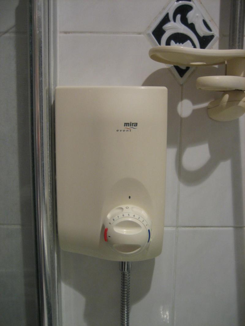

Hi,
I've got an old Mira Event shower with a combined power and temperature knob, like this. All the current models seem to have two separate knobs.
The shower works fine but has started making a loud angry noise in use, like some bearing has gone.
I'm looking for information on how to service it. At the moment, I can't even get the cover off. And if it needs a new pump/motor, can I still get parts for it?

Yes, thanks, that's the one. I still can't find any installation / servicing instructions for it.
It looks like I need to remove the knob before I can get the cover off, but I can't see how to do that.
Jay.
You're right, I just needed to pull it a bit harder! Thanks!
Jay.
You need to lever the finger grip dial off first then the rest just pull off.
Make sure you note where each dial setting was before removing.
The cover screw you'll see after removing dials.

Hi Elaine,
Yes I did fix it. First I tried replacing the brushes in the motor, but that made no difference. So I replaced the whole motor, and that made it much quieter.
Jay.

Hi Mike,
Yes, that's the right pump. I got mine from the same people. I can't remember exactly what was involved in replacing it, but I don't think it was too hard. You just need a screwdriver, and maybe a torx bit, and a bit of patience and common sense. Turn the water and the electricity off!
