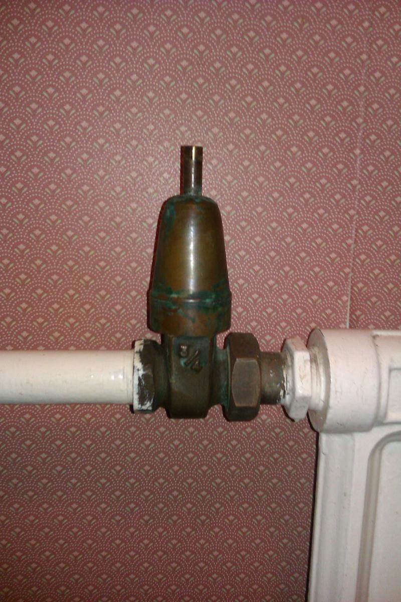

I came across a Radiator Valve i've not seen before as the picture suggest it is leaking and i want to know if the central brass bit can be undone so it can either be repacked or change the innards
All advice would be appricated
yes remove the brass cap/shroud and there's a packing gland as usual.
Use a strap wrench so you don't damage it.
