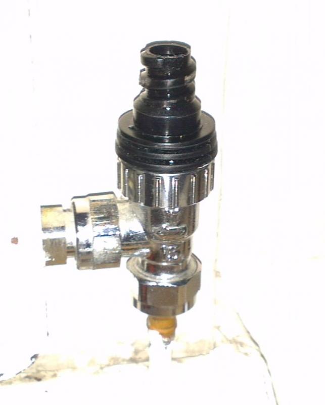

Hello. I have a cold radiator with a Drayton TRV fitted, not one of the current type (TRV4). I have taken the head off, leacing a black plastic adaptor piece that very much looks like a tap hosepipe adaptor left on the valve body, presumably concealing the pin, that I'm hoping is stuck. How does this plastic piece come off? Thanks.
Sounds like the body has been taken apart rather than the ring being unscrewed.
Turn the silver knurled ring anticlockwise as you look down to remove what's left of the head. You may need to use grips if it's tight.
If it's a TRV3 you may be able to get a Drayton conversion kit so you can use a TRV4 head. Wickes are advertising a Drayton TRV3/TRV4 Integral Convert Head for £28.
I would try Drayton first: customer.care 'at' invensys.com
Thanks for all that help. I took the wrong piece off, I thought that the silver knurled ring was part of the valve body, so now have to reassemble the top! Plunger for the TRV is stuck in. A bit of a scrape around the edge and the application of WD40 has lifted it a bit, water flowing very slowly though as the valve body has got hot. How far does the plunger normally come out? Thanks.
Get a pair of pliers and GENTLY move the pin up and down, that might free it up a bit. DON'T pull too hard on the pin.
If you spray it with some GT85 (from a bike shop) it might stay freer for longer.
Thanks..just enough was showing to pull it out with some pliers..heat restored now..many thanks...
Pin should only move a few MMs. Press down on the pin with something metal and let the pin pop up. Keep doing this until it moves freely.
To get an idea of how far the pin should move, take the head off of another valve that's the same model (carefully! :wink: ) and see how far the pin moves on a valve that works properly.
The plunger doesn't need to move very far, just a couple of mm, so it's possible that you have a balancing issue - did the radiator work properly before the TRV seized?
