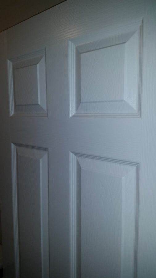

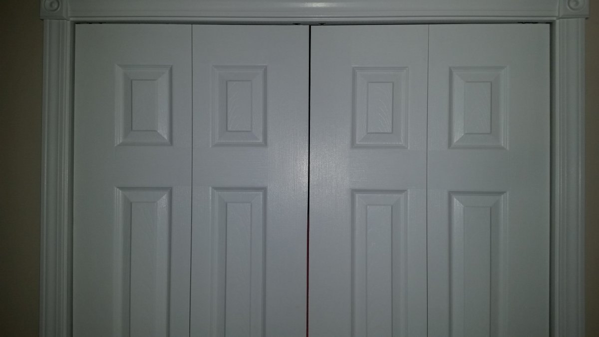

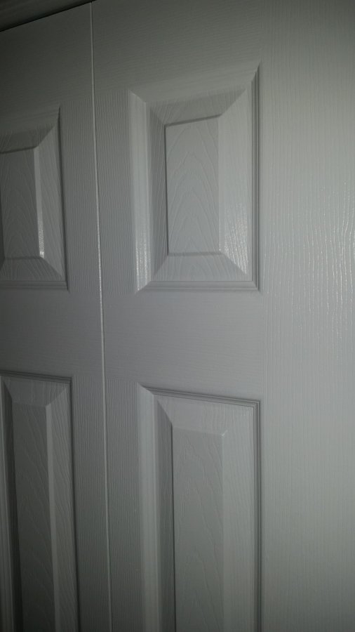

Hey all,
I'm just posting a few images of some doors I've painted in my house over here.
The water based/acrylics are pretty much used everywhere and, in my opinion, the one I've just used has been the best of a decent bunch. Yes, that's right, the best of a decent bunch!
I don't do much hands on painting these days (I give the orders and 'relax' :() but have tried a few different ones in our own house, all being relatively easy to use, with good results. The pros working here all seem to have their own preference, but I think I'll stick to this one from now on.
Obviously, not living in Blighty any longer, I can't really compare the paints here with the progress of the water based ones over there, but I know they are better than those I was using before I left.
I'm just wondering if the finish compares to any of the ones you guys use these days. I gave each door two coats with a dampened synthetic brush and it went on as easy as can be. The finished product looks great to me, considering I'm a bit 'old school' in preferring oil based paints for woodwork.
If the water based paints over there are not getting any better, I can't help but wonder why, when they are fine here, and we do have strict VOC regulations here too.
Apologise if the images aren't great but I just quickly snapped them with my phone, in bad lighting - I'm not sure why the bi-fold doors look different colours because they are not! The finish is High Reflective White, which is an acrylic gloss produced by....a big U.S. paint company whose initials are S.W.! :sneaky:

I note that Mr H's doors look like the 'eggbox' style. I've found most alkyd hybrids go over these type of doors quite successfully. I find the challenge comes more from flush doors or smooth finish doors. The dulux u/c is pretty damn good and the gloss is pretty good as well now. It's taken ages for them to get it to a decent standard and obliteration is still an issue. Sikkens satura is good but it's a real pain for runs and drips. I did use some bedec aqua advance in black and that was very easy to apply, but it was only on windows with no broad areas. OB gloss is still terrible for yellowing and really isn't an option for me. It's also interesting that such a small part of the sikkens range is available in the UK. They have a far bigger range that's available in mainland Europe, i can't help wondering that Akzo deliberately make a lot of sikkens products unavailable here because so much money is spent on the fluffy dog. IMO Dulux is the best marketed paint rather than the best paint, a lot of their range is average and getting quite expensive. I also can't help wondering if the dulux trim paints are derivatives or re-badged sikkens products?, their gloss and u/c did get good very quickly after the disasters such as that eco gloss crap they used to produce.
Yes, the doors are the typical pressed/moulded kind. I have to admit that, before I left, I still had a bit of trouble with those doors when it came to water-based paints. I couldn't get one that would cover well and dry properly - they would either dry fine but have poor opacity or cover well but dry patchy. I did eventually manage to get acceptable results but was never 100% happy. I completely agree that flush doors are much harder - I ended up using a 4" Purdy, virtually soaked with water to do them, but still had to complete each coat in under 2.7 seconds to get anything like a decent finish. :D
I just feel that the paints here apply far easier than the water-based ones I'd used over there ever did and wondered if it was because they are universally improving. It does sound as if they are getting somewhat better over there.
