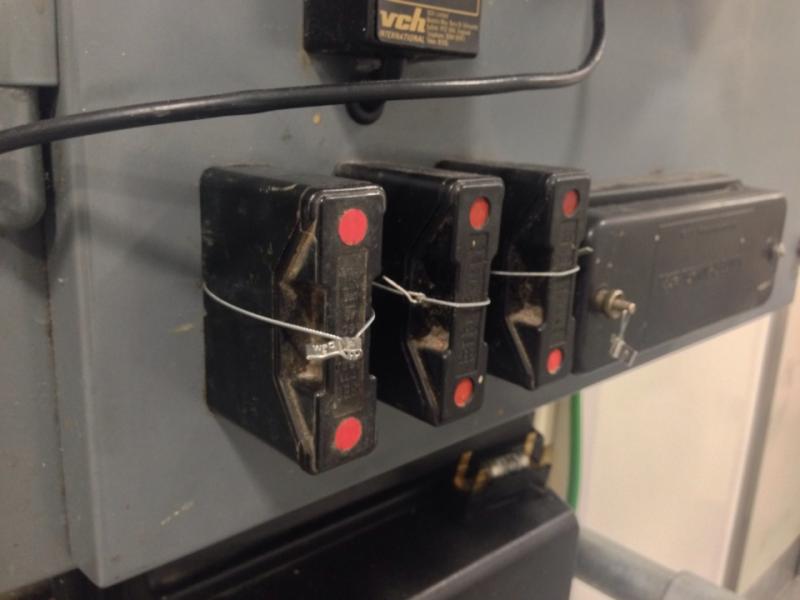

To cut a long story short, there is some damage to a CT metering RS20 fuse carrier, DNO are saying it's suppliers equipment, Supplier are saying it's DNO's.
I was under the impression anything after the cutout was the responsibility of the metering / supply company. I would call the DNO equipment the Delta and then everything in the grey cab supplier. If the fuse had popped with the damage I'm sure the supplier would have replaced it immediately as they wouldn't be metering L1.
Any advice would be appreciated, MOP's were also saying DNO need to attend to pull the fuse if they are going to repair which everyone knows isn't the case.
I have the emails to + from people in the suppliers support dept but am reluctant to post them publicly but some aspects may make more sense to someone who works in the field.
Real question is, whose gear is damaged?

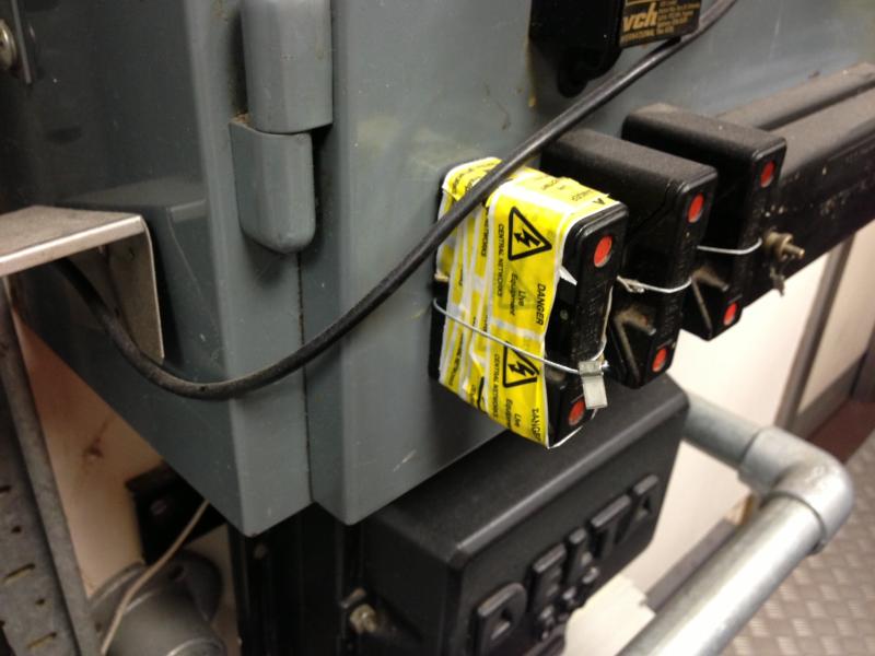

Hours of going back and forth between YEB/northern power/whoever they are this week and meter plus and it got sorted, took three visits.
1) for a DNO chap to come and tape it up (removing my cardboard that I'd taped over it with) while the metering company get round to fix it
2) For a metering chap to come out and decide it was a DNO issue is and to make some telephone calls and tell his managers he cant do it.
3) For another metering chap who is ex-YEB to up with a rubber curtain to allow him to work in close proximetry to live parts.
In case its not clear in the pic, the setup on this site was a single metal enclosure with hinged door with the cutout fuses inside and metering on the door, instead of the standard cutout with metering enclosure above
