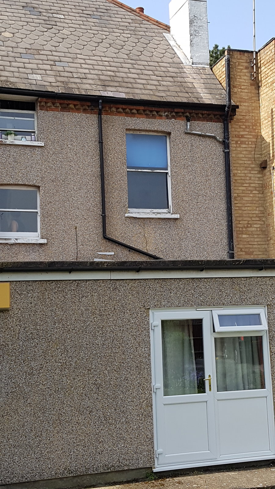

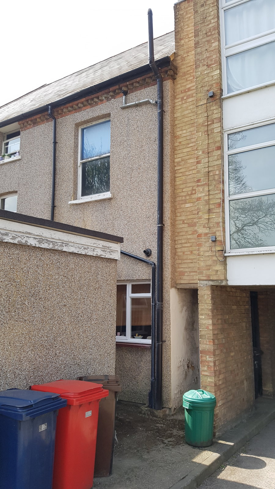

I was just wondering if anyone had any opinions on what I propose to do. There is a vented stack on the corner of the house running to a kitchen waste pickup drain. The only foul waste that runs into it is our kitchen waste (sink/washing machine) pipe.
I was wondering if it's acceptable to just extend the kitchen waste pipe to the pickup drain and bypass the stack. The connection to the stack keeps failing, I think due to the dodgy angles the various contractors have used in the past and I'm just tired of getting it sorted. Any thoughts welcome. pictures attached.

Is your kitchen in the attic space? is it the gray waste pipe to the right in the 2nd pic? Why have they fitted 2 45Degs? All they needed to do was lengthen the vertical by about 50mm and then a straight run into the stack, through a 40mm boss. I think all you need is a proper plumber to fix it correctly, as there's really no need to remove that stack and once the job's done right it should last as long as you need it to.
You wouldn't want a 40mm pipe dropping that height without venting, better running into the stack, otherwise you'd run the risk of syphoning in your kitchen traps.
Hi Madrab
Yes our kitchen is in the roof space, as is the whole flat (45° ceilings). The kitchen floor is on the same level as the gutter (yeah, does look weird having a waste pipe at that level) and yes it is the grey pipe that looks like a child has assembled it.
I take your point about syphoning, and I get that a short run to the stack would be better so thanks a lot for putting me straight. Again you’re right, we’ve had a succession of “get it going” plumbers but now I think I’ll either get a proper one or do it myself if I can get hold of a ladder.
