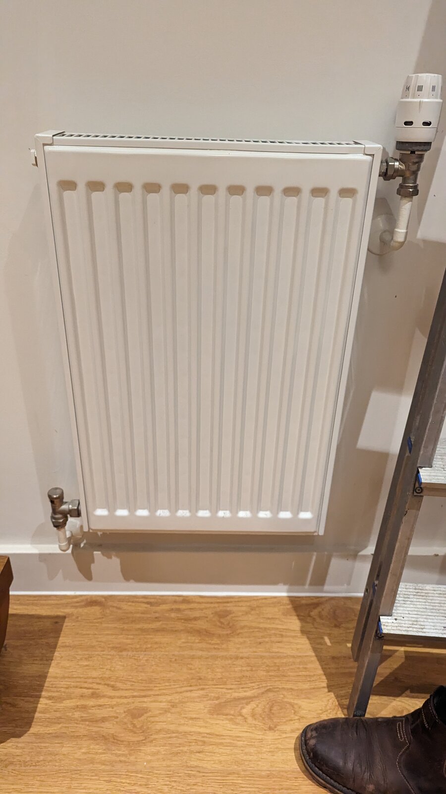

Hi all, I am new to my 2016 flat and only just tried the heating recently.
The radiators all seem to work, except one in the hallway that takes ages to get going.
After some time, the top gets very slowly hot
TRV is at the top right, outlet (?) is at the bottom left.
it's almost as though water is ever so slowly warming up inside, but it isn't evacuating out the other end. (or is super slow)

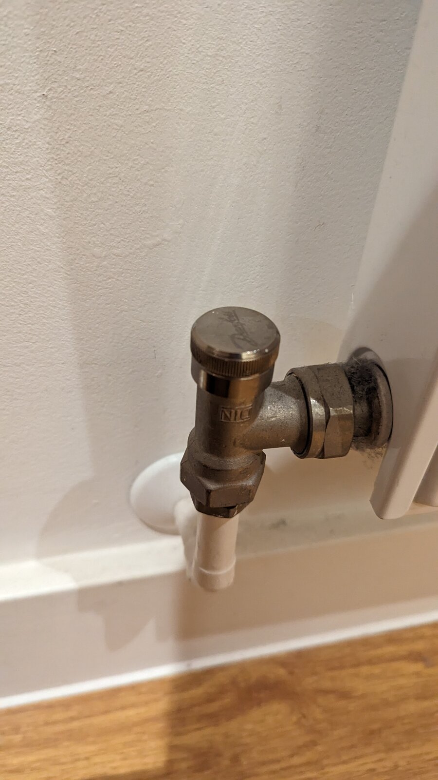

So I think it must be the valve (?) at the bottom left?
Do I need to open the bottom valve somehow? if so, what should I do? I've only used TRV's before
-not sure if relevant, but this week we had a guy move a radiator along a wall and replace with a new one (more stylish) so some fiddling has gone on with the system, but the one I'm complaining about shouldn't have been touched.

Remove the white actuator head of the TRV. There is a pin in the centre of the valve body ,see if it moves up and down freely, leave the actuator removed,and see if rad heats fully
This symptom is indicative of inadequate flow through that radiator. The cause is more difficult to determine at this stage.
Suggest you report back after following @terryplumb 's advice. Useful info is:

Me again. finally had a chance to do testing.
With all rads off, the dodgy rad was slow as hell to warm up.
But I then went and did what Terryplumb mentioned, took the TRV off and noted the tiny metal spike didn't depress easily.
Gave it a bit of effort and it sprung into place. Seems that it has fixed the problem. But if there's anything else I am sure I will be back.
