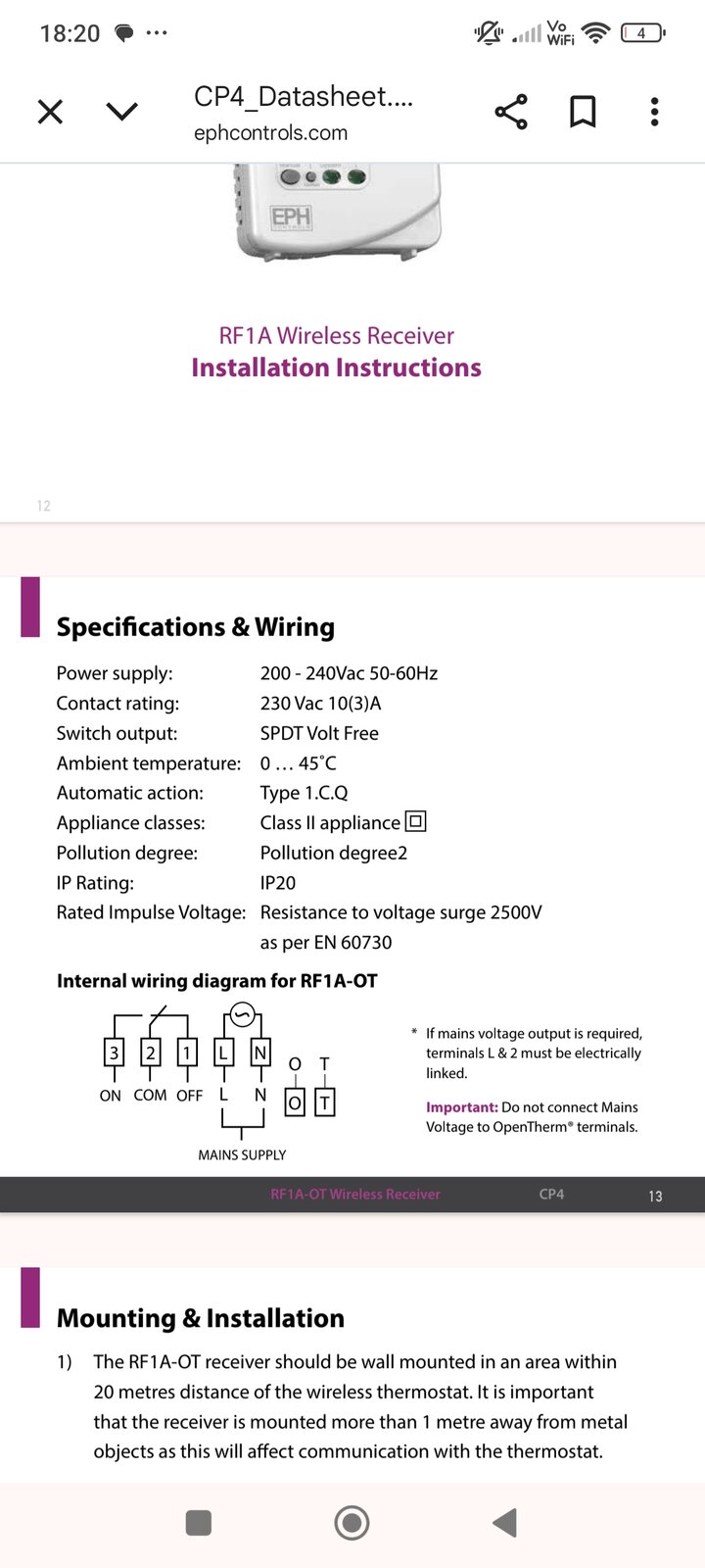

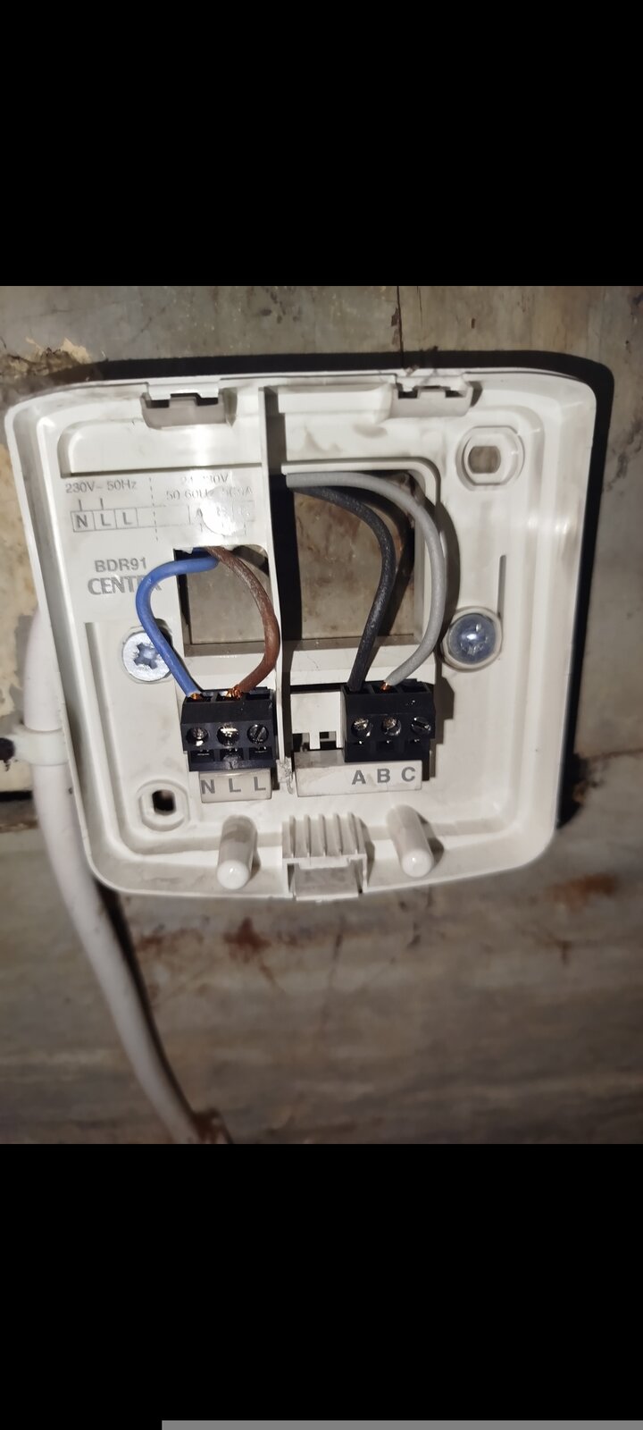

Will this stat swap for an open therm stat. Or is open therm low voltage/ open therm will need another wire taking back from the boiler to the receiver with low voltage? Thank you

Thanks I know open therm modulates the boiler down when it is close to the desired room temperature. Is this similar to load compensation? Which most new stats are now?
Aye, similar to load compensation but I believe it’s supposed to be better.
Thank how do you wire the open therm then, take a separate low voltage 2 core back from the open therm ports onto he boiler? This being a 2016 boiler, may not be open therm compatible?
Ideally yes, as the way it is now could introduce induced voltage
Opentherm has been around since 1996. Why ask about it then if you’re unsure if the boiler supports it? What make and model is it?
