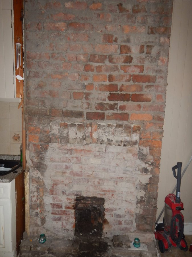

Hi all,
I have planned on opening up an old fire place to install a gas oven in a chimney breast and blocking it up above. I haven't planned on adding an extractor as there is a vent in the corner where I can fit an extractor fan.
No lintel can be seen on found above the mini lintel at the opening. I plan on adding a concrete lintel at about 1.6m using acrow strongboys.

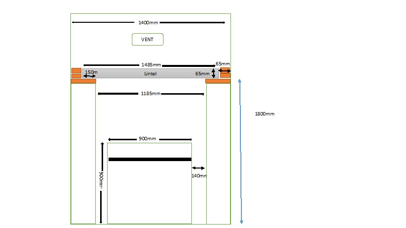

The chimney breast is 1.4m, I had planned on a minimum of 150mm on each side for bedding. As such I had planned on having a brick length on each side so 1400 - (215*2) gives me a total opening of 960mm. Is it sufficient to have a 65mm cut down brick each side of the lintel?
Can I have the lintel spanning the entire length of the breast without the cut brick on each side? Or should I consider having a smaller opening?

1. Your lintel should typically be installed at 1.7m to 1.8m height from hearth level to underside of the lintel.
2. What are the Mfr's installation dimensions for the gas oven ie. the width of the building opening required?
3. What does the Mfr's instructions say about extraction? Extraction ducting must be planned in advance esp. the terminal.
4. Do you intend to install any other appliance or a unit or fixture in the opening?
5. A gas supply will be needed - a GSI will also be needed for any gas appliance. Plan the gas pipe run.
An elec supply is needed - safety zones must me kept to.
6. When you open up you must remove all soot from the fireplace and have the flue swept.
7. A vent must be fixed thro the chimney breast into the flue - there must also be a vent at the stack terminal.
8. "a vent in the corner" what do you mean?
9. Use a plate or backer board to cover the flue opening at the lintel. The flue vent must be installed just above the plate.
10. Carefully examine the c/b and its return walls for any signs of dampness.

Could you make & scan a rough sketch (with dimensions) of what you propose?

Hi Ree
Yes a free standing gas cooker with hob.
Looking at cookmaster CK90 hob or Rangemaster 60cm 10732, based on my drawings I should have enough room for the CK90.
The "vent in the corner" is louvred vent fitted to external wall.

Thanks for the diagram - its much clearer than the average contribution.
Believe me, extractors are almost a necessity above a hob, esp in an isolated cooker position.
Apparently you dont have any other elec/mech extractor in the kitchen. You should have one fitted esp. if you are doing up the kitchen.
The lintel can be raised - the significant dimension is 760mm above the hob to the extractor or any bridging. This can be fudged a little.
I'm sure you appreciate that the cooker will project from the face of the c/breast.
Given the built-in advantages of a re-circ extractor, the cheap prices, & the ease of installation its definitely worthwhile.
