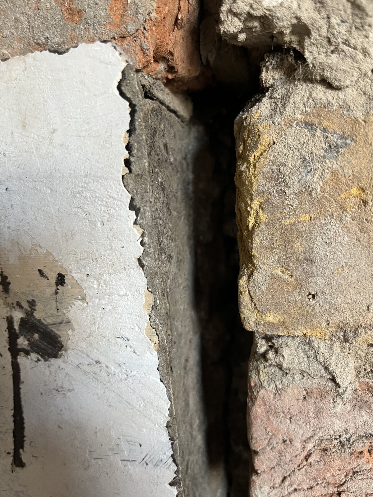

Looking to open up this chimney breast to sink a 100cm range master into it.
Have just taken off some render to see what I’m dealing with and a bit worried the current chimney breast is being held up by 2x2’s..
There seems to be a fairly large concrete block propped up by some timber, on top of that there’s an arch of brick, some of which are loose to the touch, and some cracking above going up to the ceiling. No lintel that I can see. Should I be worried about this? Nervous to keep chiselling the concrete render off in case the vibrations make the house fall down at this point!
Either side of the arch is a piece of wood, presumably where an old lintel sat?
Ideally I want to go a bit higher than that, and if possible make the opening wider - on googling I had thought this could be a DIY job but on revealing the current state of play, I’m now questioning this! Any advice appreciated

Started removing below the arch but the big white slab seems quite deep and solid so I may need to find another pair of hands before continuing, it’s hard to see here but I’ve chipped out the cement either side of it and it’s deep!
Yeah I’ve stopped - as I was moving the big block, the arch and the entire course of bricks above it were moving, all the mortar between the bricks is crumbling in the arch, I have to say I’m not feeling at all confident about taking anything below it out without another lintel in first

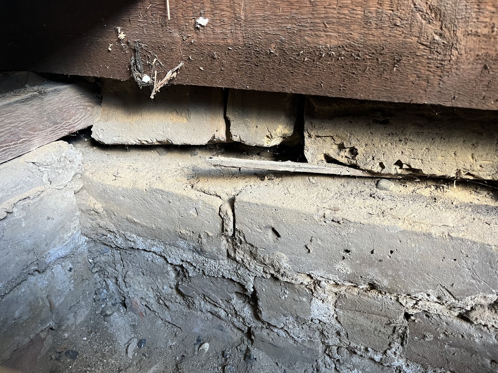

Also noticed that some of the bricks under the hearth look like they’ve fallen in

It will need propped and another lintel installed before you remove that lintel. That arch will not hold anything.
I'm not a builder, but likewise - I would be very wary of the that crack and the arch's ability to hold up under load.
The arch only holds itself up, under pressure from each side. The sides appear to be spreading, as evidenced by the vertical crack. Remove the support under the arch and the crack will likely widen and the arch fail. As suggested above, it needs a new lintel.

Put a couple of strong boy props in just above the arch and fit a lintel then you can remove the stuff below.
You can use expamet lath over the crack and cement render to strengthen the breast.

I've mentioned the hearth in your other thread.
