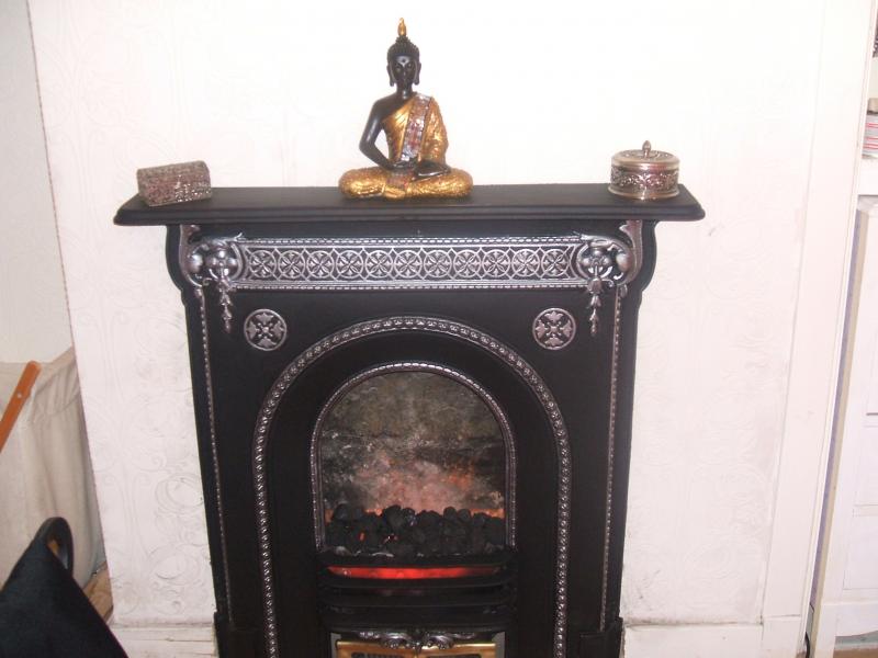

Hi I have what looks like a a wall that was chimney for a fire, have a hearth shape on floor in front of it, its been closed up and has an air-
vent in it, i would like to open enough to fit a cast iron fire surround fluch to wall, and an electric inset.
The wall runs all the way through my neighbours bedroom too, I dont want the wall to collapse! Can I re open it?
ps I dont need much depth only about 6", im assuming it will still be empty behind the wall?
Will I need to close it off at the top if its open inside, dont want spiders,mice etc getting in!
thanks, jeanette

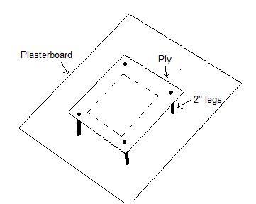

It's very unwise to block up the flue, even if you have an electric fire. It will attract damp into the brickwork. That's why the air-vent you already have is fitted. You could try this devcie that I've fitted to a couple of fireplaces successfully. Allows ventilation without letting dust fall into the hearth.
It's fitted horizontally up the chimney.
More simply you could move the air-vent higher up the chimney breast and block up the flue above the fire.

I took off paper and the vent, chipped away plaster, there is an opening behind the vent oblong, no dead pidgeons thank god, but heaps of soot and rubble. Im finding it hard to break through, i assumed it would be bricks, but seems to be concrete, im using a hammer and chisel, but barely chipping away at it, do I need to use something different?120816/15466_23451465.jpg[/net] [/img]

hi
all done and dusted (literally), took a bit of bashing, just attach the surround now, thanks everyone!
