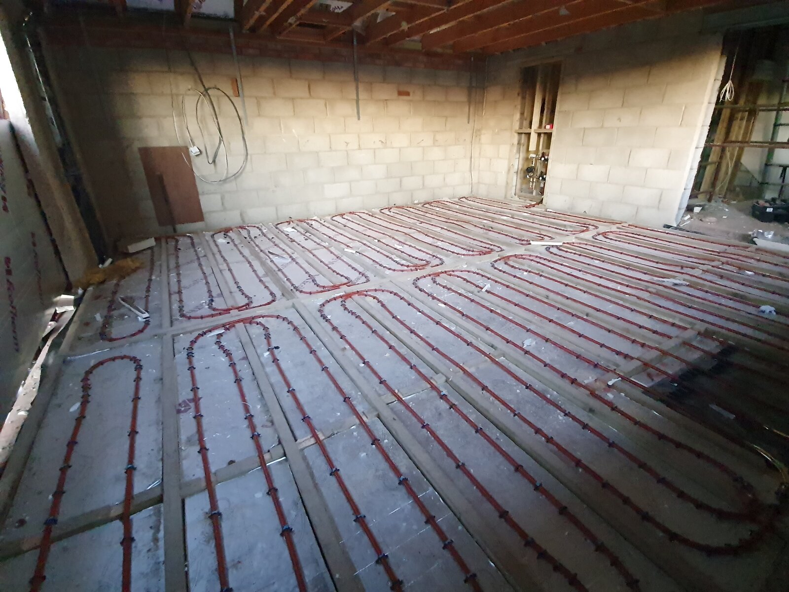

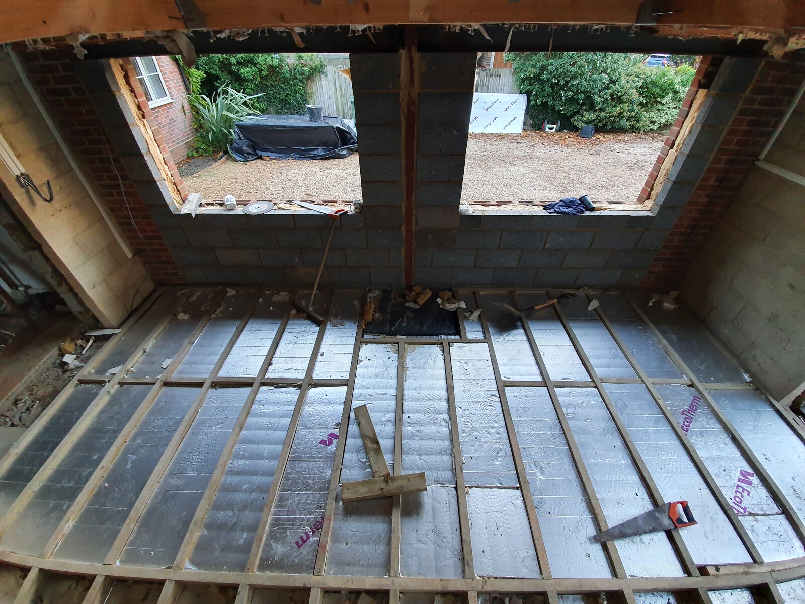

@Exedon I found these images of the insulation and underfloor pipes being laid. Any thoughts?

Pictures very useful pipes look about 250mm apart?
Can you give us room dimensions in metric please! Window / door sizes how much and type of insulation in ceiling and walls sketch showing dimensions to show which are external walls would be good.
@Exedon based on number of pipes in the pictures and room length I estimate 200mm apart for the pipes

I’m curious about how this is installed.
I assumed that it would be pressed into an insulated tray, then your flooring on top.
Looking at yours (clipped on insulation)
I was thinking it was going to be screeded over.
I’m asking the question now, won’t there be large air pockets around the pipe work that will be getting heated up and not passed straight through the floor?
Will this have an effect on efficiency?
I’ve no experience with suspended floors and ufh so would be interested in hearing Exedon’s opinion.

Underfloor in Suspended floors is quite common typically involving insulation then a reflector plate with pipework clipped. in.

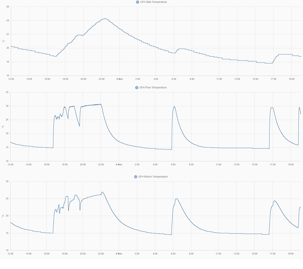

I don't know if this will help but here is a graph of mine. This is laid in 55mm liquid screed...heats the slab from 19 to 24 degrees from 17:00 to 22:00. It wasn't running continuously. Im very new to UFH and this is the first time I have it in a property.
Also does the return temp reach the same as the flow temp fairly quickly? That would mean not enough heat is being drawn from the pipes...
