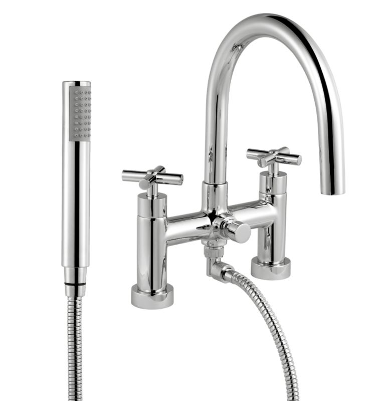

My gf's mum has just had a new bathroom installed. The new bathroom has a new mixer tap on the sink and mixer tap/shower head on the bath.
The house is quite old (1890's) and the bathroom room is located on the first floor, in what could be considered the roof of the property. They have a small header tank (50 cms high x 60cms long x 50 cms wide) above the bathroom which feeds the hot water tank on one feed, (located in the bathroom) and then sink and bath cold supplies respectively, on a second feed.
The problem is, there is only about 8 inches between the bottom of the header tank and the top of the shower head, so there is no pressure on the cold side of the shower. The water dribbles out. The bath cold tap isn't too bad, and the sink tap is ok, but not great.
What solutions are there to increase the flow rate, pressure of the cold side of the system?

Hi there dj,
It sounds as though there is a couple of issues going on here.
Firstly, poor flow through shower head due to lack of "head" from cistern in loft and no great distance between the 2.
Secondly, it also sounds as though the wrong type of taps have been fitted.
Most modern taps these days are designed for high pressure system ie combi / unvented and as your system is gravity fed this would cause low flow as not enough pressure to open taps up.
With regards inscreasing flow. Check type of taps on "basin" and change to low pressure if needed.
You say you cannot increase height of current cistern in loft or fit bigger one, is there room to put in another similar size cistern and link the 2.
You would then be able run new hot & cold supply to bath through a pump in the airing cupboard.

Thanks for the reply.
There possible is enough room to have a similar sized tank further down the roof space and that would probably be the best solution.
I was just looking at pumps and notice this one seems just the kind of thing thats needed:
http://www.plumbworld.co.uk/triton-t450i-12-bar-single-1651-17447
However, it says only to be used on a mixer shower.
Would this be suitable to be plunbed in after the head tank feeding the basin and bath/shower mixer
The bath/shower tap looks like this:
0000003634462_001c_v001_zp
But has a different head on it.
Thanks again.
