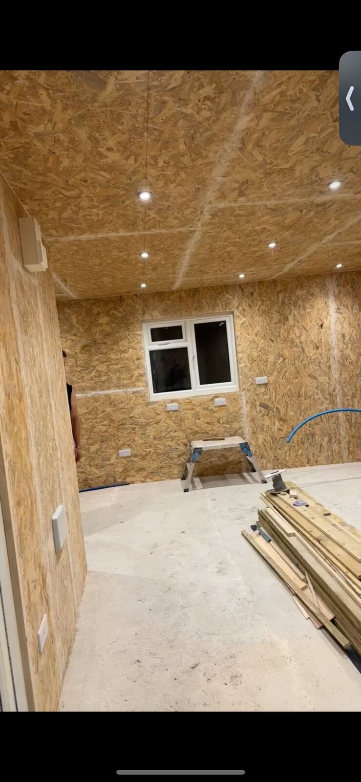

Hi all,
I've recently had a new office/garden shed built and the interior walls & ceiling are finished in OSB. My question is what would be the best way to protect the wood from moisture and give it a durable finish? thanks in advance.

Durable against what? They can be left as if you don't mind the look. Or just painted if you want them white/coloured. Or boarded over with plasterboard if you want a nice finish.
BTW they're OSB or sterling boards not particle board.
edit: are you in the UK, they look like three pin plugs but hard to tell for sure?

My main concern is moisture, we will be painting but wanted to know the best way to go about it, e.g. primer, filler, sanding and paint.

If you want cheap and easy, emulsion.
But masonry paint is more durable, and will withstand cleaning, for example in a garage or workshop.
Why do they need protection from moisture? Is it unheated and prone to condensation? Or are you washing down in there?

we want to create the smoothest finish really (I know not ideal with OSB). We will be using it as a bit of a dog room/wash room aswell
You could run a sander over it all to get it a bit smoother, silicone any joints and then what about just a weatherproof wood paint? Something like Ronseal at the lower end of the budget you could just slap on the OSB. Or maybe something from the likes of Sikkens at the top end with suitable primer etc.

He wants to wash dogs down in there so presumably that means they'll be getting splashed by water at least.

This is what we are thinking of doing at the moment, for a primer I was looking at Zinsser B.I.N, followed by a couple coats of Bedec barn paint
you could just use a stain varnish as the different woodchips soak in differently and makes a good look, bit like rag rollering. try the look on a spare peace. or try a thin miss coat of emulsion colour to suit.
