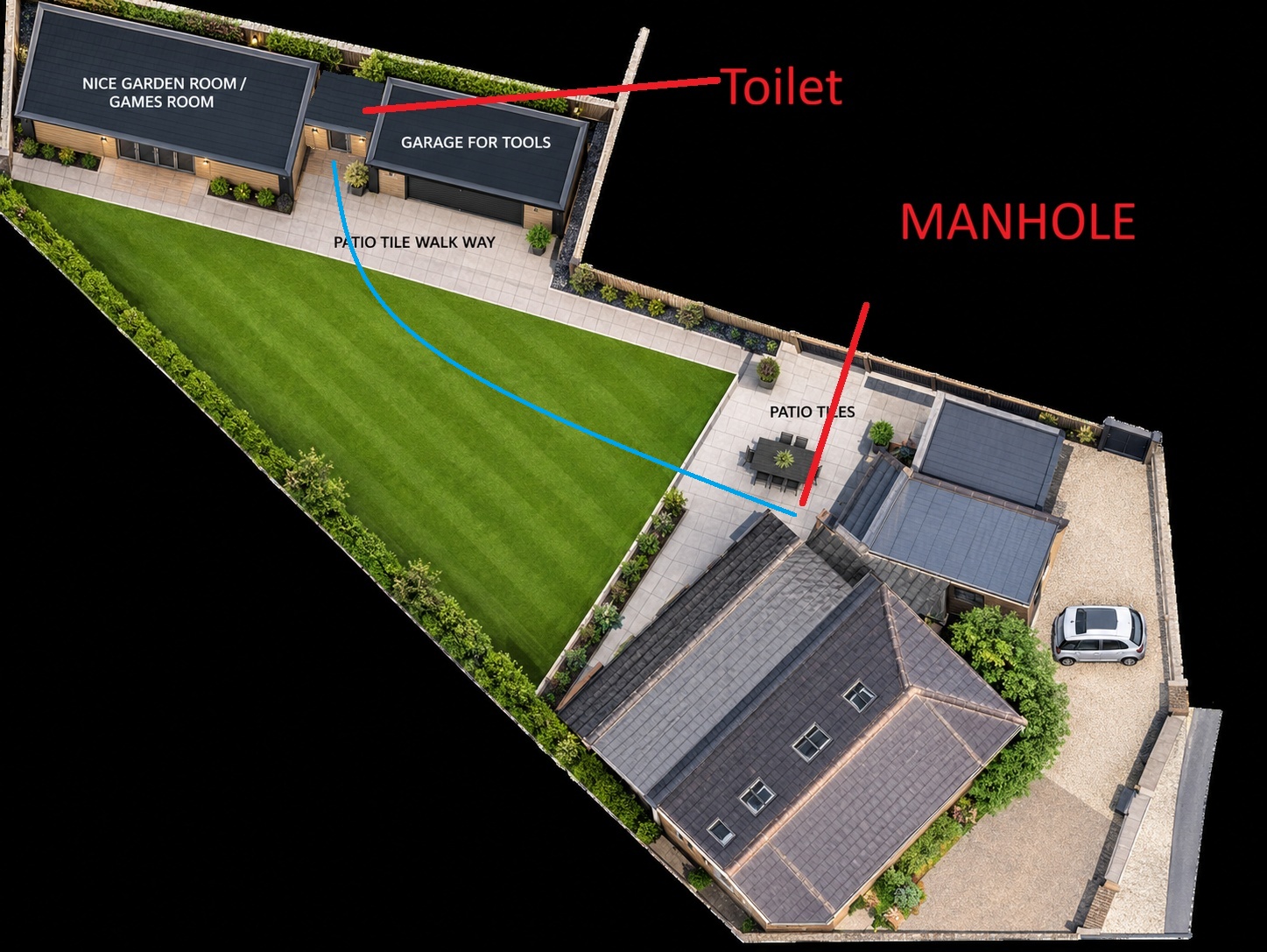

Hi all
Picture is for illustration purposes only, the garden is still being built, garage, bathroom not built yet, so able to dig trenches etc.
Now,
I am planning to install a new toilet facility at the end of my garden, located next to my garden room/tool garage which have already been built.
The total distance from the proposed toilet location to the main house manhole is approximately 29 meters.
• The Challenge:
The pipe run will pass underneath a flat lawn. Because of this layout, I cannot guarantee a standard gravity fall (such as a 10mm drop per 1 meter) across the 29-meter expanse.
• Fixtures: Initially, this will serve a standard domestic toilet and a washbasin.
From research i have narrowed it down that i need an underground lifting station such as the Sanifos 110 (Grinder version) the most appropriate unit for a 29-meter flat horizontal run or the stronger sanifos 280.
Sadly i can not find user experiences/posts or any thing online where people have used them, to get advice.
But would really appreciate if anything has other suggestions or a better idea
