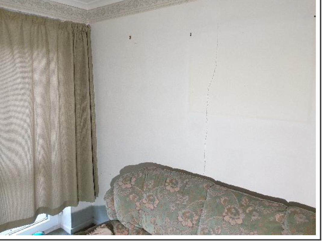

Looking for some advice please on this probate property to be purchased. It's going for £225k in West Midlands as a 1950s three-bedroom end of terrace with a ground floor extension, with a flat roof, split into two rooms (sitting room and utility room). The property generally needs modernisation, new kitchen, bathroom, fixtures and fittings, including skimming and new flooring.
We've had the level 3 survey report back and have some conerns as the reported issues were not obvious to us. We were told the cracks on both sides of the interior wall of the extension were non-structural by the estate agent when viewing the property, but the survey seems to say otherwise. The extension was built with planning permission in 1970-1980, so is 40+ years old, does it seem likely there is a leak based on the cracks at all?
Extension first room interior wall:

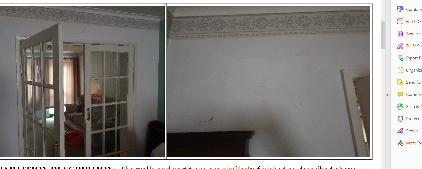

Extension second room interior wall:

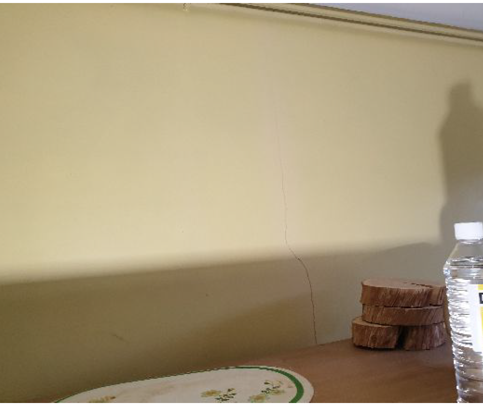

Crack on the connecting wall - the original build into the extension:

1. Related to the extension cracks, the belief the extension was built over a drain and that the drains may be leaking. Surveyor strongly recommends we get a drain survey and structural done but we can't justify the cost if we'll just be abandoning the property.
2. Diagonal cracking to the exterior wall above the living room window due to timer windows being replaced by UPVC, the surveyor believes there are no lintels above the windows, but we don't understand how the property would be built without some level of support?
3. Electrics - RCD in place but the box is plastic and not up to regulations as should be metal.
4. Roof sarking felt was found to be slightly damaged and mortar verge to the gable end will require repointing soon, under cloaking suspected asbestos.
5. Vertical thermal cracking to where the extension meets the original build, surveyor believes this is of little worry, but if it continues after repair, to install an expansion joint.
6. Wrongly discharging down-pipe onto the flat roof, this is from the rear gutters of the original build discharging over the flat roof.
7. Exterior wet rot to the joinery of the flat roof.
8. Render taken too far down so DPC is ineffective to the original build. No DPC to extension.
9. Survey mentions that it appears walls have been removed from between the living room and kitchen, but seems no building permission was granted for this.
10. Small trees and bushes within influencing distance of the foundations but been advised to not let them grow any taller than the distance to the property.

regarding the internal crack in the extension wall on both sides, would this be considered major? Surveyor tells us one thing but seems friends say the cracks look normal. They seem to suggest it's a leak but surely after so many years a leak would be obvious, please pardon my ignorance.
extensions are built on a different foundation to the original house, so there will be differential movement. Usually you don’t see it because there’s usually a return where the extension goes, so internally you don’t normally see a flat wall with a join in it.
If the crack is even from top to bottom and not too big, it’s just settlement / thermal contraction.
If the crack is tapered, say much wider at top, that indicates the extension is suffering subsidence - which is not your situation.
Its got nothing to do with a leak, sounds like estate agent bull.

There is nothing in that report that looks bad or out of place in an old house. The wall cracking is indicative of thermal cracking not foundation movement.

That cracking might or might not be due to leaky drains, but I would rule out the other possibilities first. As a starting point, is it just the plaster cracked or does the crack transfer through to the masonry. First of all, check outside - looking for any cracks or indication of movement? If nothing, consider hacking off plaster to about 600mm either side of the crack. If there are no cracks in the masonry, make good the plaster and that's it. Obviously, you'll need the agreement of the vendor. That might seem unlikely but in an empty probate property it's not impossible. If this issue came up once, it will come up again and they might be happy to get it resolved one way or the other and/or not lose the sale.
The lack of underfloor ventilation could be an issue. At the very least the air bricks should be properly exposed and cleaned out. Ideally you would also get a look under the floor to check condition. Again, this might be possible in a probate property. I'd do some negotiating if I were you.
