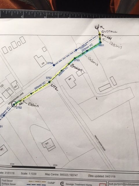

We have a bit of an issue with a broken pipe in our front garden. We live in a semi-rural area of Essex, on a slight hill on a busy road. Since the new year water has been emerging from a muddy bank just past our property and streaming past our front lawn (there is no curb, lawn joins the road) then downhill to the nearest drain. It is noisy, messy and dangerous in the current wintry conditions.

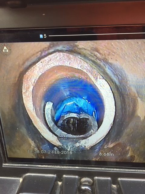

Essex Highways paid a visit, jetted what they could and but a camera down. There is a 300mm gully under out front garden which runs parallel to the road, which surface water drains to. When the camera reached a section under our drive, it showed the pipe had collapsed and the camera could go no further. When trying to put a camera in the next drain cover which is where the water is escaping from, they could not find it under the woody growth. It seems that once surface water hits the broken pipe, it backs up and emerges from this hidden drain cover.
Plans showed the gully belongs to Anglian Water. However, they said that as no houses use the gully in question for drainage, it is actually down to Essex Highways to repair. Essex Highways dispute this.
So, we are going round in circles, no one is claiming responsibility for the broken gully. Our front garden is saturated, our drive is noticeably dropping in places (I believe the pipe has been broken for years and all this rain has finally brought things to the surface so to speak). We moved here two years ago, there was a dip in the lawn along the travel of the pipe I filled in. I was told it was an old ditch that was filled in years ago so thought nothing of it. The house also rumbles when heavy traffic goes by and is getting increasingly worse.

I'm pretty sure if it only does Highway drainage, then it's Highways responsibility. If the drain takes water from properties as well then AW are responsible for the main pipe, Highways are responsible for their gullies and connection's to the main pipe. Essex have sort of admitted responsibility by getting involved in the first place, normally they are quick to offload to AW if its not their issue.

Local MP, papers etc will be the next step. AW could find no evidence of discharge to properties, that's their stance. EH say the gully is on record as belonging to AW and will not budge. All properties around here have septic tanks so I'm siding with AW here.

What you can see on the CCTV is a bodged previous repair.
Looks like someone has slipped some 4" clay into 6" and sealed it with a bag.
