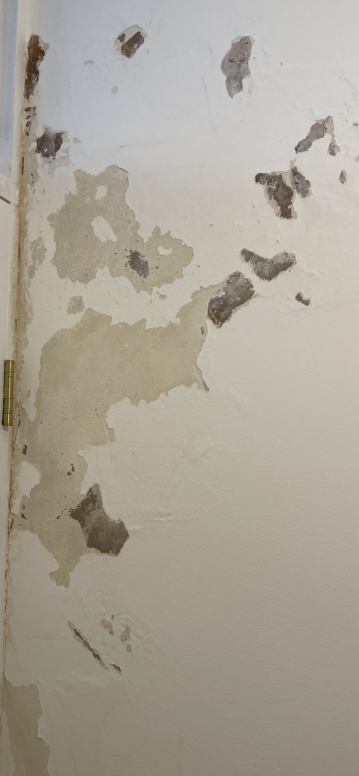

Happy New Year to all,

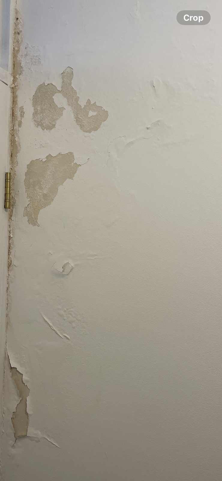

Wanting to deal with some bubbling paint issues I’ve had for past year or so and hoping for some advice/pointers.
Downstairs bathroom and utility room, was painted about 20 months back but the bubbling didn’t occur until a year in.
Looking online and thinking it could be efflorescence?
Utility: The white painted wall is an internal wall under a flat room, no outside external side to impacted wall.
Bathroom: The green painted wall is an externally exposed wall under same flat roof.
Thanks for any help and assistance.

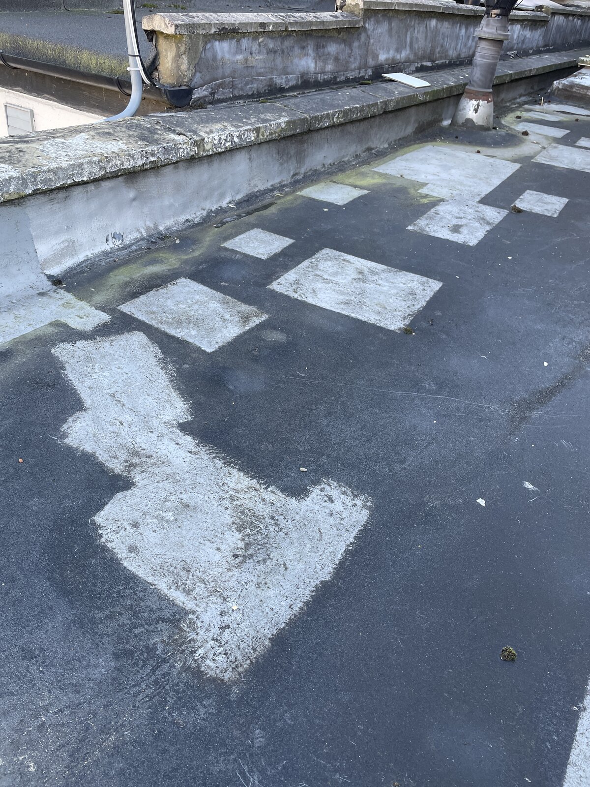

Show us the outside of each wall, next to its associated inside surface. Include all gutters and downpipes.

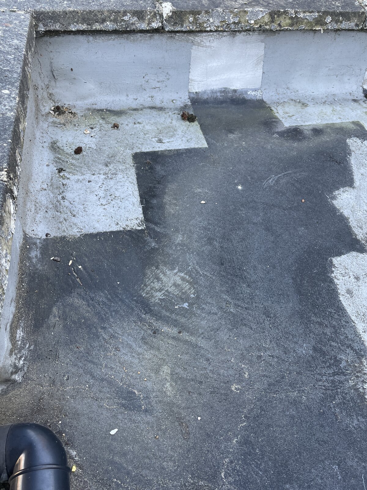

Also show the surface of the roof, especially all seams, leaks and damage.

Thanks for the reply JohnD.
The surface of the wall had a slight fluffy residue so wasn’t sure.
Any ideas about how best to fix?

The flat roof was constructed about 30 years ago but was repaired summer of 2022 - asphalt flat roof.

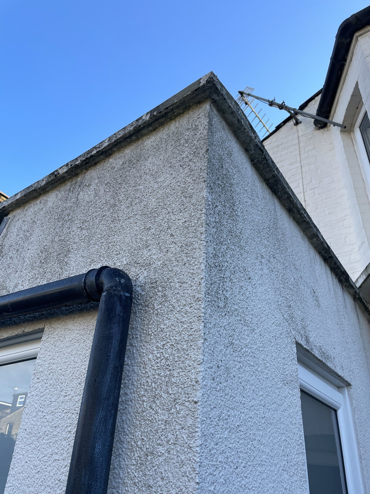

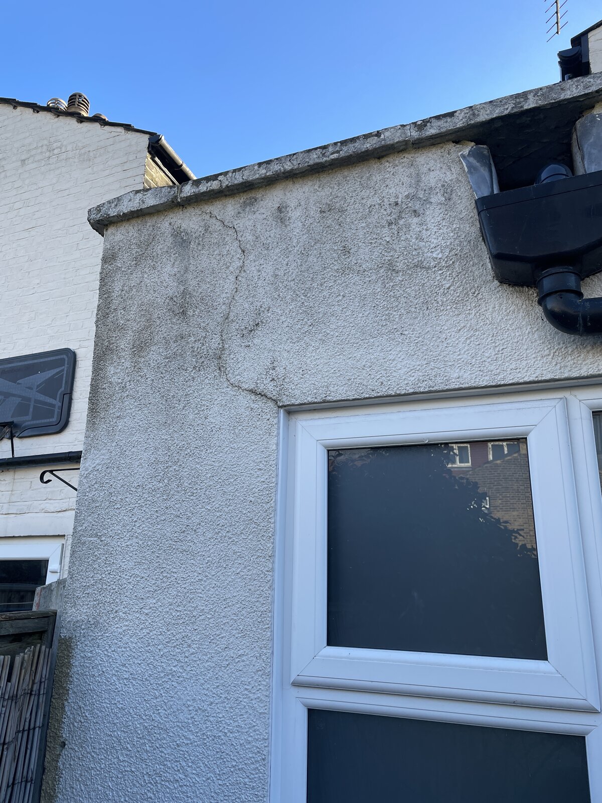

Outside of green wall:

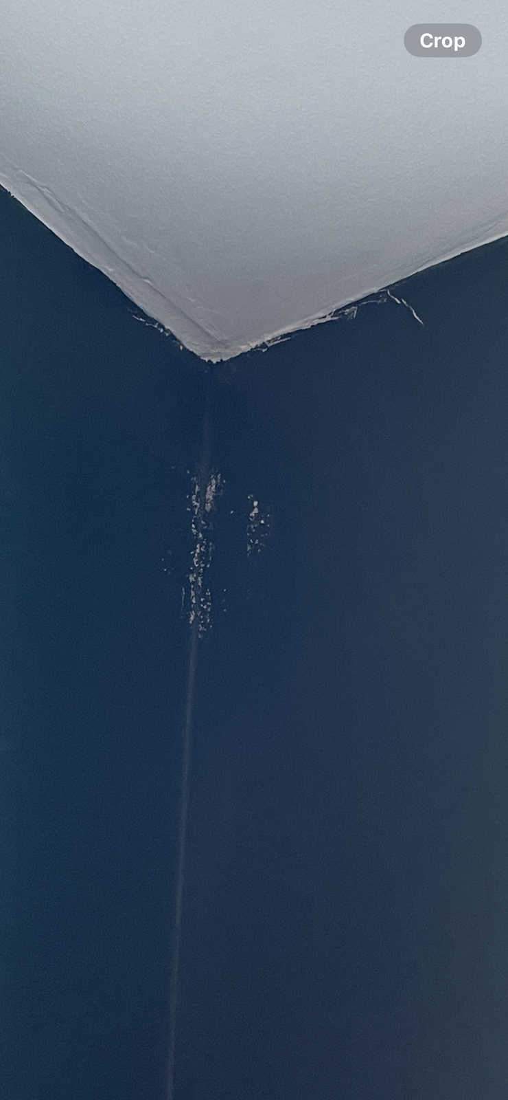

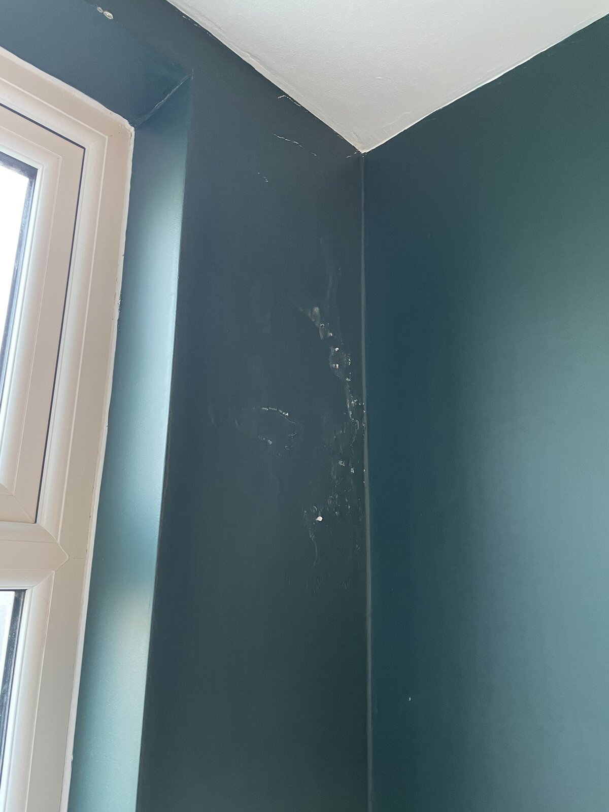

Corner Green Wall:
Roof:

The green one appears to be rainwater getting in through cracks.
The dark stains on the render are from long term rainwater spilling over.
