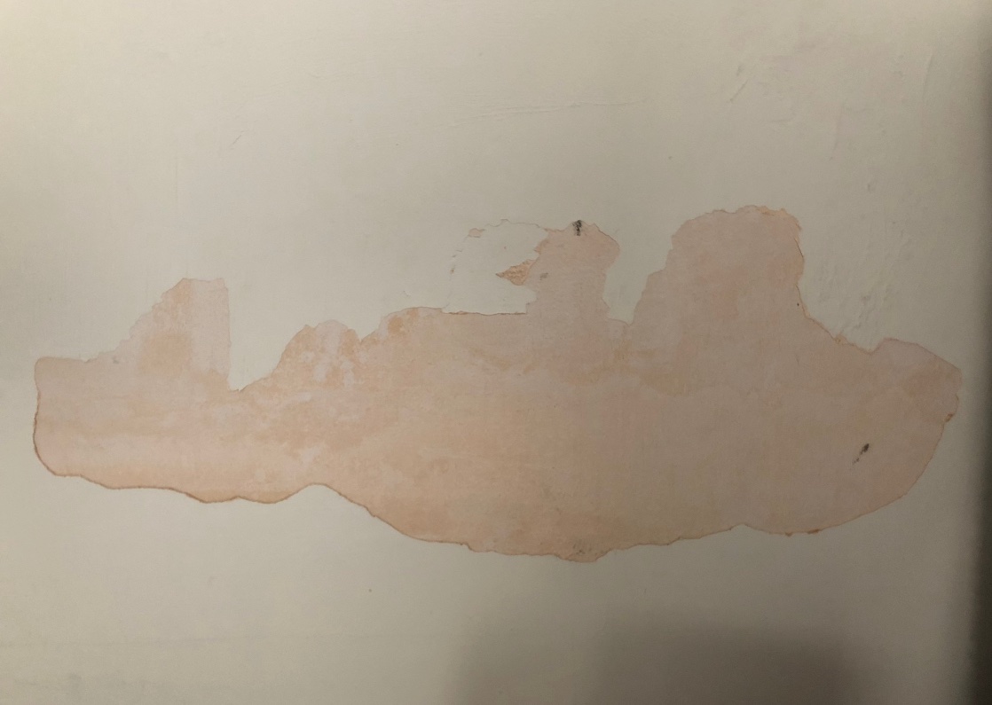

I’ve got this paint peeling while rolling so I’ve scraped back as much of the loose material until the edges seems strong enough. I’ve got some Zinsser peel stop, do I just apply it on the edges & mist coat the middle or Zinsser the whole patch? Also I’ve heard about filling it, what exactly am I filling & at what stage do I apply it?
Ceiling or wall?
Solid or plasterboard?
Lack of insulation so it's a cold spot so condensation forms at that spot?
I would use toupret powder to fill as is.
See what happens.
180 grade sandpaper on some flat wood and sand smooth.
Give it a mistcoat of emulsion and see what happens.
Other option is to use peel stop around the edges
Then fill and sand. Paint

Plasterboard wall. I’ll give the peel stop a go as I’ve already bought it. Should I sand the edges flat before applying it then apply filler? Also I’ve seen the peel stop being used on the plaster instead of a mist coat, is that ok to do?
Yeah.
Peel stop is a sealer. Get that on then fill and sand to make smooth
