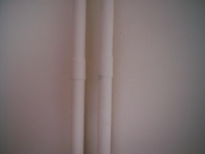

Hi all, I have a recurring problem with a central heating pipe in a bedroom, when it was painted within a very short time the paint discoloured and started to flake and bubble, I chatted to Brewers staff for help and the chap there recommended rubbing down to bare metal, washing off with meth's and then repainting, it was felt that the problem was caused by flux contamination, ( the problem is in one specific area on a joint in the pipework) I followed his instructions but after only 1 week the staining has appeared again, any ideas that would help?

The paint is emulsion paint, good old magnolia! It's not a leak, I rubbed it back to bare metal following the Brewers recommendation, had it been leaking I'm sure I would have seen it. The stain is green, I would love to upload a picture but I don't know how.
A green stain on copper pipe is either from flux, if a soldered joint, or from water, or both. a water leak may be invisible if it evaporates away and seems dry. The leak mat be coming from avove where you see it.

It's a leak.
It would be preferable, but surprisingly difficult once a pipe has had water in it, to open up and resolder, but you can bodge it by buying of tube of Fernox LSX sealant from a pluming place; polishing off all the paint, limescale and other detritus from the joint, and pressing a little of the sealant very firmly onto the joint so it bridges between the pipe and the fitting, and is pressed into the step where the pipe enters. Clean off any excess with a cotton rag because it will set alsmost immediately. You can inspect and paint the next day. Put the cap back onto the tube immediately or the tube will set from contact with the air.

OK JohnD I'll give it a go, I must confess I am surprised because whjen I had it down to bare metal I left it for a day to see if anything was weeping out of it but nothing showed, however I bow to your greater knowledge. Watch this space for results.
You were right JohnD, I removed the old connector which was leaking cut the pipes both sides back and spliced in a new bit with new connectors, all good now.
