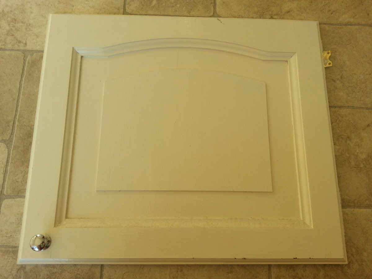

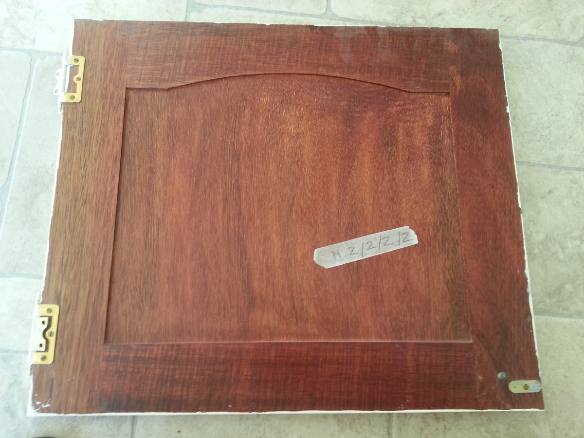

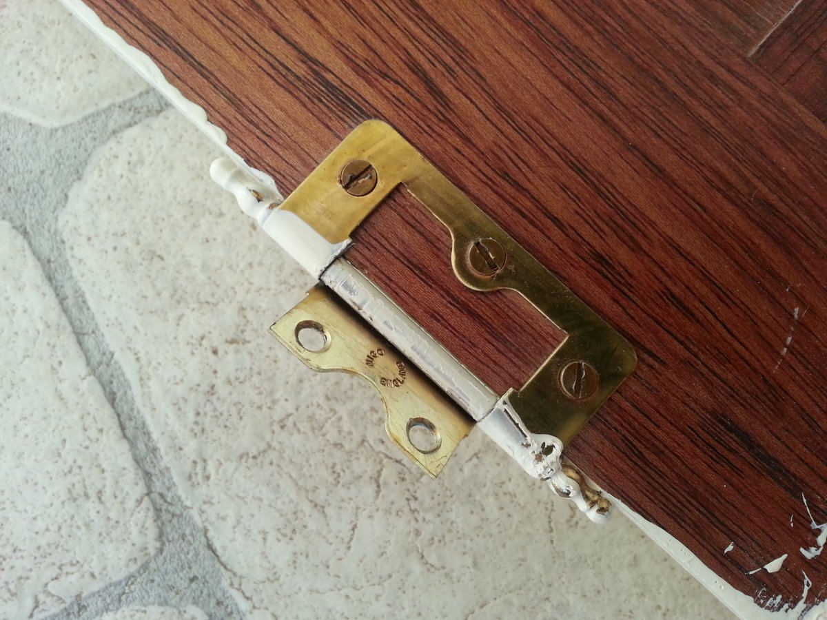

Here you can see the front, back and hinge of the door. As you can see, the previous occupants decided to just paint the front of the doors (badly), the back is still decent wood, so painting that should be quite simple.
As regards the front...
How about
1. Sand some parts if necessary - runs etc.
2. Liquid sandpaper (front), especially grooves
3. Zinsser primer (front and back)
4. Top coat (x2) of our choice
Already a long process for each door! In terms of parts 2 and 3, paint brush I assume?

You know, when you said intricate, I was expecting intricate! *Cheeky grins*.
Personally speaking I would sand the lot, undercoat and then 2 topcoats. I wouldn't use BIN on the front myself as it's not really needed with this job as it's already been painted (therefore primed). I understand you wanted to apply BIN because it doesn't need prep but it is expensive.
Up to you of course! And I know you don't want to spend a lot of time, but some things can't really be rushed if you want a long-lasting & neat finish. Good luck with it all! :)
I must confess, when I got them from the shed I did think they weren't as intricate as I remember. The tall doors are a little different and the top rail (fixed in place) is more so.
I already have a large can of zinsser. The coat now is gloss, so they'll need something no? Either a good key, a deglosser or the zinsser?
Would you take the hinges off and try to get the paint off them? Not sure if there's anything I could drop them in, a-la breaking bad, or if taking them off is a risk.
Yes, you need to do something to the gloss so the next paint adheres. Up to you which method.
And yes, I'd take off the hinges. Even if you don't bother to clean them, at least you're not going to make them worse when you paint and you make life easier when painting with them off - fewer possibilities of drips too.
Cleaning hinges, I guess you could try paint stripper if want an easier option? Doesn't work as well as it once did since they changed the chemicals - think it was because of EU regs.
