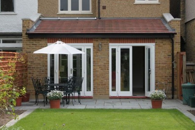

quick question. we're finally ready to start building our extension, all the paperwork (covenants, planning permission, build over agreement, drawings) is ready. we already spoke to the builder and the project is straight forward.
the only "issue" is that we want to build parapet walls. this is because the neighbour is building an extension as well and since we get along, we both want to maximisie space, avoid awkward steps in the walls and gaps between external walls. the plan is to end up with something like this:
basically two parepet walls to continue the external walls of the house, brick/block onstruction, good insulation etc. I also want to build muy roof ("flat" roof, warm construction) between the walls. all well, but I've remembered discussions around thermal bridging with damp stains on the ceiling.
I've heard that you can replace the upper inner parapet wall with a stud construction that you fill with insulation to basically create a continuous insulation barrier between inside and outside. does anyone have any more information about this? diagrams would be helpful.
alternatively, some other options I can look at. also, I won't be able to have cavity trays, will I? the water would drain on the neighbour's side of the wall...
