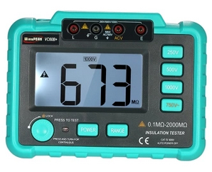

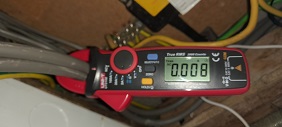

The insulation tester uses in the main 500 volts, VC60B.jpg and will give us a good indication to if a modern RCD/RCBO would trip, and is used on dead cables. The clamp-on ammeter however is used on live cables, and again shows the leakage if used in the correct way. Diffrence line neutral 8 Feb 24 reduced.jpg these will show faults, but in real terms, don't show if there are no faults. But one can quickly, specially with the latter, see if a new consumer unit can be fitted without a full rewired when also looking at types of cable where they terminate in the old fuse box.
