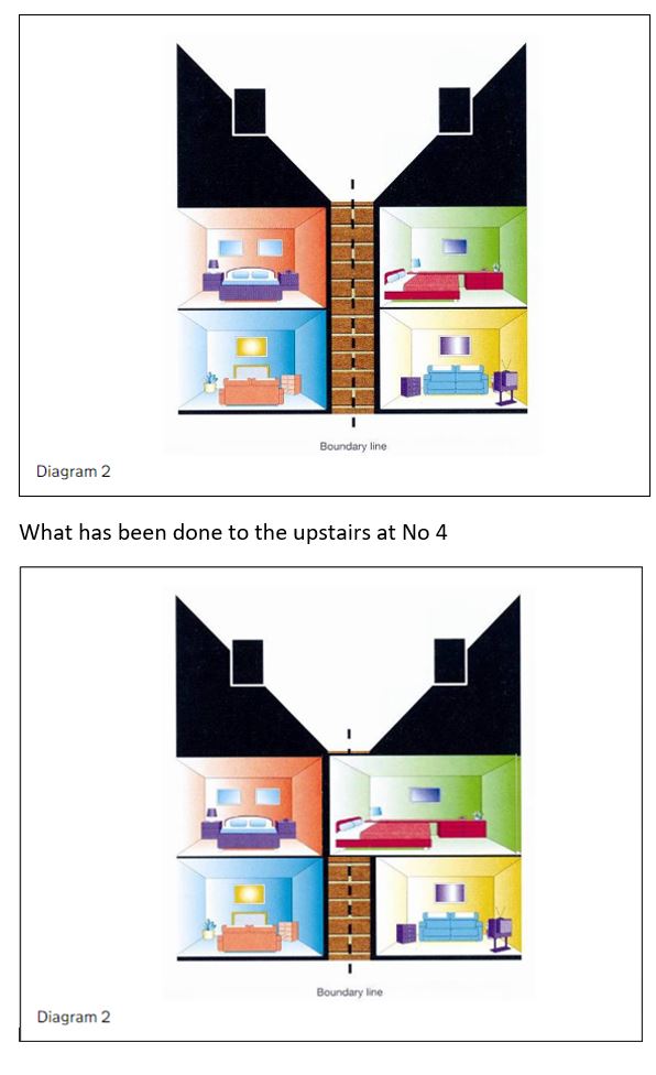

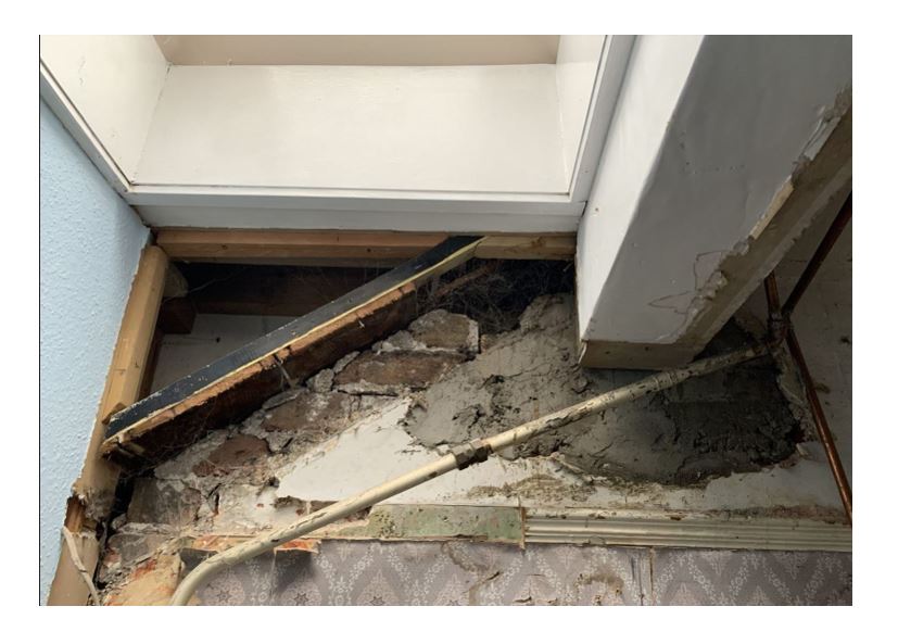

The result of the work is that as the two properties share the upper floor joists and they removed all the old plaster to expose the beams and walls, they never filled those joist holes again and simply boarded around them. This now means that sounds easily transmit between the properties, whether its people talking loudly, baby screaming, dog barking, etc.
All that is preventing transmission is 12.5mm plasterboard on their side.

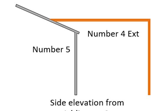

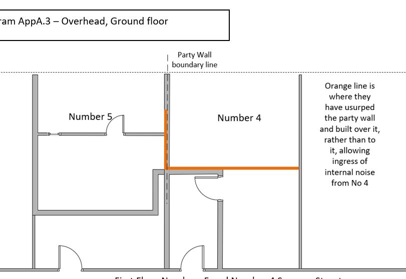

The rear extension is only a timber frame, erected over the party wall upstairs to the outside edge (ie, my side) and plasterboarded. my featherboards are cladding the rear from one wall to the partywall and should be 2 bricks deep yet their internal wall is built over this edge. This means there is only a piece of baton and plasterboard between us at the rear of my property upstairs so we can hear each other talking quite easily.

So, you need to consider the issues from a different angle. The sound transmission problem is very difficult to address, because there are no regulations involved, which gives you very little to go on. Where you certainly have some ammunition is the trespass of the overhanging wall. Assuming that the wall is a shared wall - and you must check and be 100% certain of that? - my advice is to write to them and state categorically that their wall is trespassing on your property and must be removed immediately. That's just the start of the process, you may need to follow up if you get no positive response. At the very least it does as jacko said - it registers a boundary issue that must be declared if they want to sell.

You say, "The rear extension is only a timber frame, erected over the party wall upstairs to the outside edge (ie, my side) and plasterboarded."
So, the outside face on your side is flush with your side of the rear dividing wall? If it is, then it is against the rules. My ex-FIL built a type of 'lean-to' in his back yard, many moons ago. His neighbour said he could extend the height by building the wooden side wall on top of the back yard wall. Just after he had built the lean-to his neighbour moved out and someone else moved in. They object to the council about the way it had been built. FIL had to take it all down because he had gone past the boundary line. At the time, (1970's), the council said the boundary line was traditionally taken as the inner face of a wall/fence on your side of the property. No one 'owned' the width of the dividing structure, be it a single skin wall, wooden fence, of trees.

I have attached some diagrams which may assist but, its advice for next steps i am after. If i formally start legal action (that i cannot afford) then it could be expensive very quick, a friends daughter in London is at 50k fees thusfar on her issue. It also would immediately take value off of my property too wouldnt it as it would also show as a dispute my side?

I wouldn't advise going legal, for the very reason you state, costs can get out of hand. I think the best you can do is register your complaints with local authority building control, and also the neighbour - making it clear that the overhanging wall is trespass and you are not going away. I say don't go legal but it might be worth paying a brief to send one letter - to give it an official edge. At least it will cause some waves and put the dispute on record. As jacko said above, disputes must be declared and it can be very serious for the vendor if they are not. Putting it in writing and making it official means the neighbour can't just ignore it. Well, they can, but maybe at their cost.
They have clearly broken the boundary rule and as there is no form of insulation, (sound or thermal), in the dividing wall then they've probably broken some other rule. It would appear by your diagrams that they haven't had any form of building control/planning permission, or if they have, they have clearly broken the rules.
