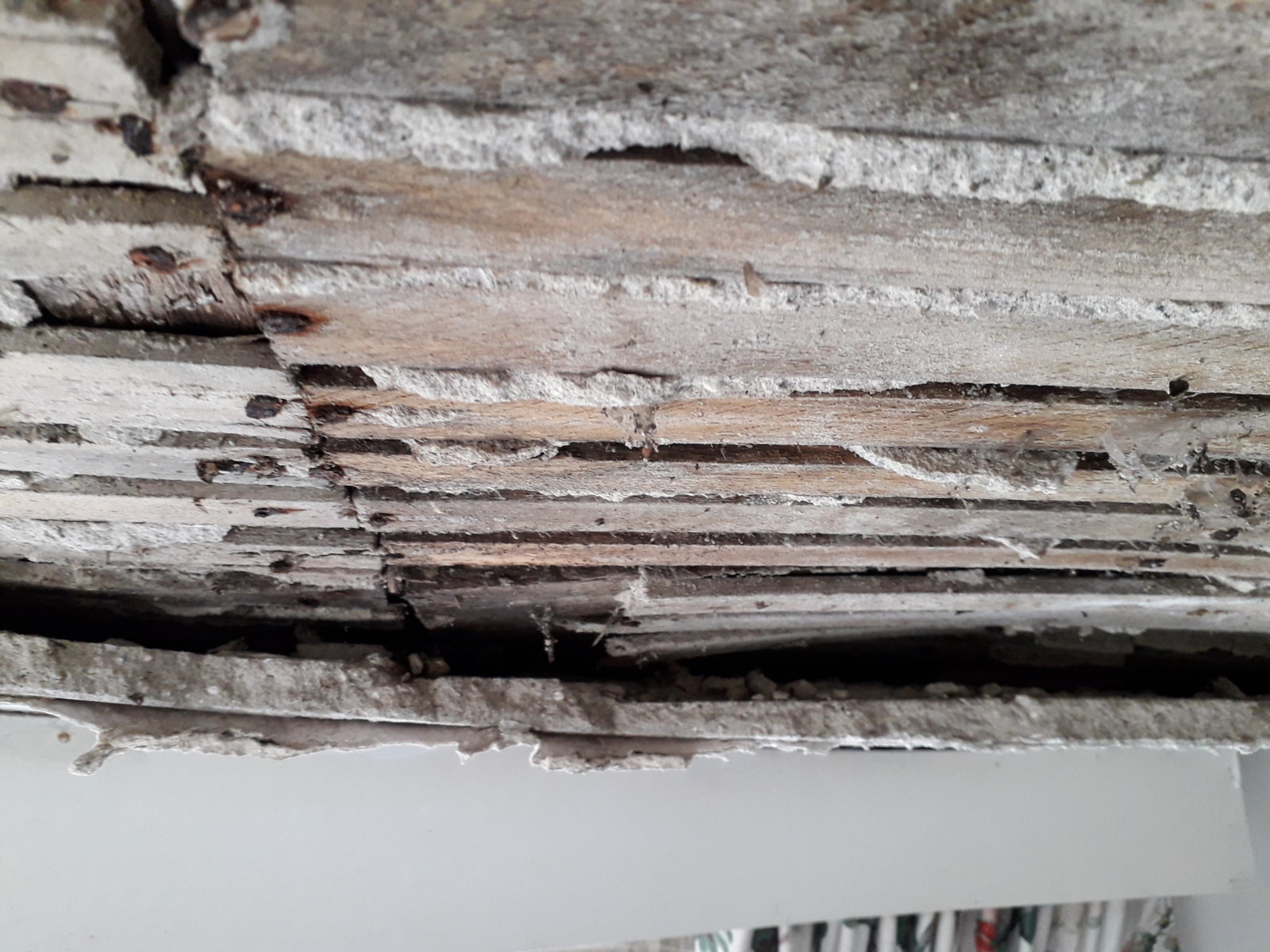

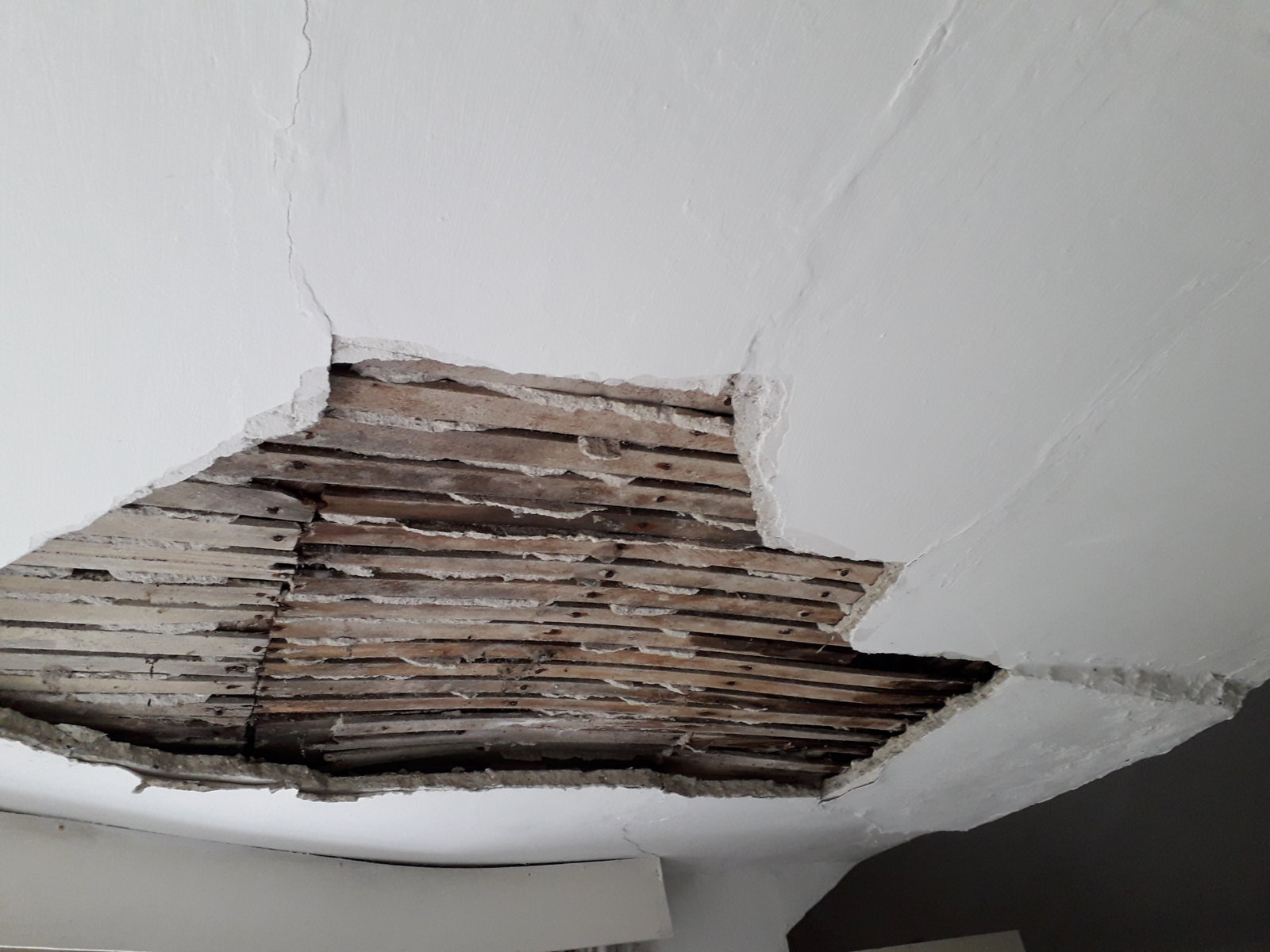

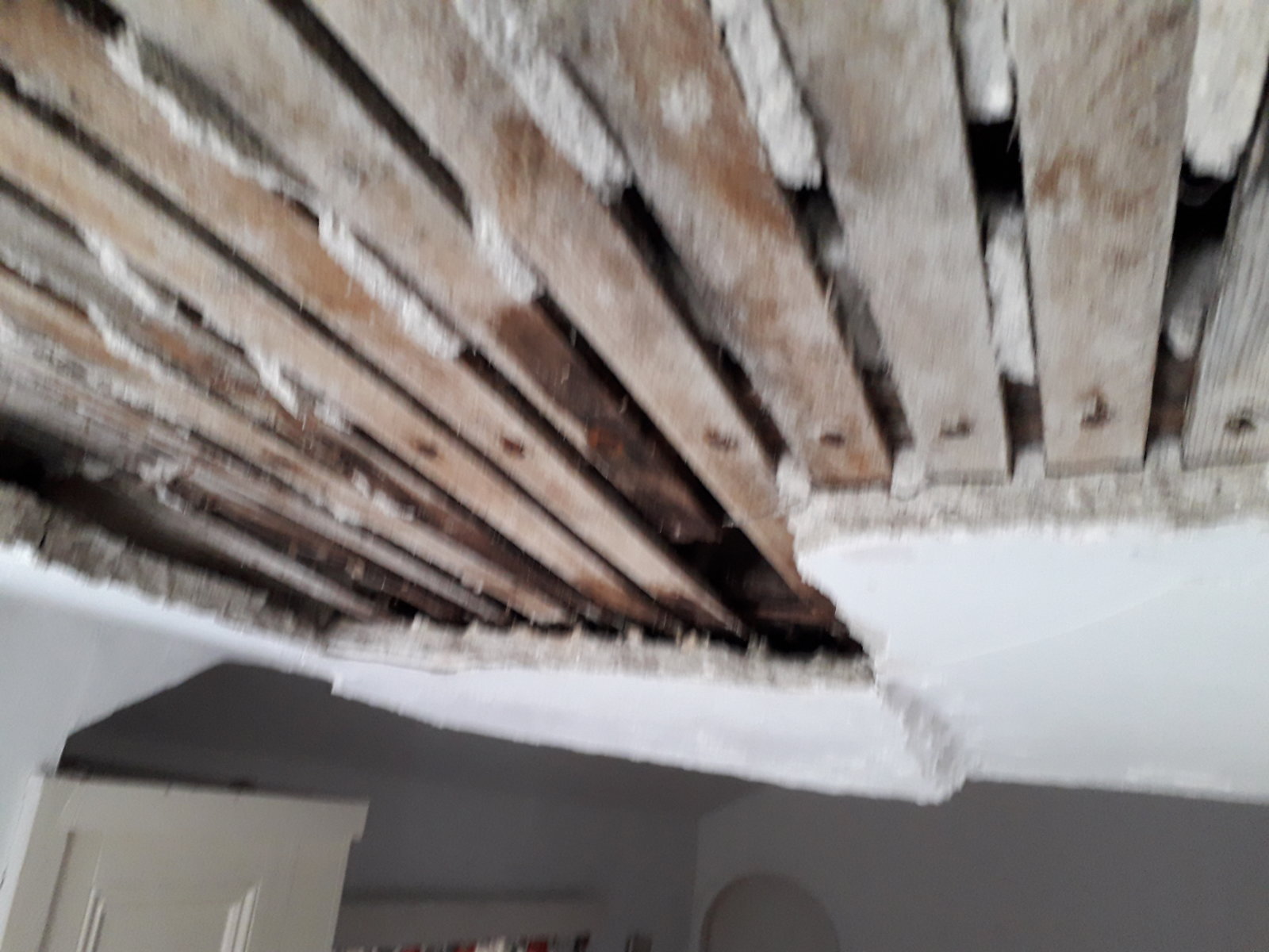

There are beams to which are attached what I would call "latts"(?) and there was a thick (half an inch) layer of rough plaster.
I would say it is a 3 by 5 foot area .
The remaining plaster is hanging below the level of the latts (not dangerously) and so the area to be repaired would need to be quite a bit thicker to be at the same level as the rest of the ceiling .
I don't want to take down the wider area as there are pelmets and electrical fittings involved
Any advice.?
Here's pics

Looks like a Georgian / Victorian bay window ?
The ceiling is Lath & Plaster, the plaster will have horse hair as a reinforcement.
It would appear that there has at one time been an ingress of rain water from what may be the flat roof above, the lath nails are rusted.
The entire area of the bay [if it is indeed a bay] will need to be carefully taken down and replaced with two layers of Plasterboard and a skim coat of plaster.
As an aside? there does not appear to be any insulation above the ceiling now would be a good time to get some in there?? and? what state is the roof above the ceiling in now?
