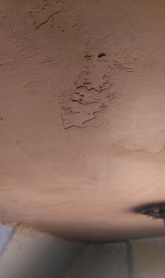

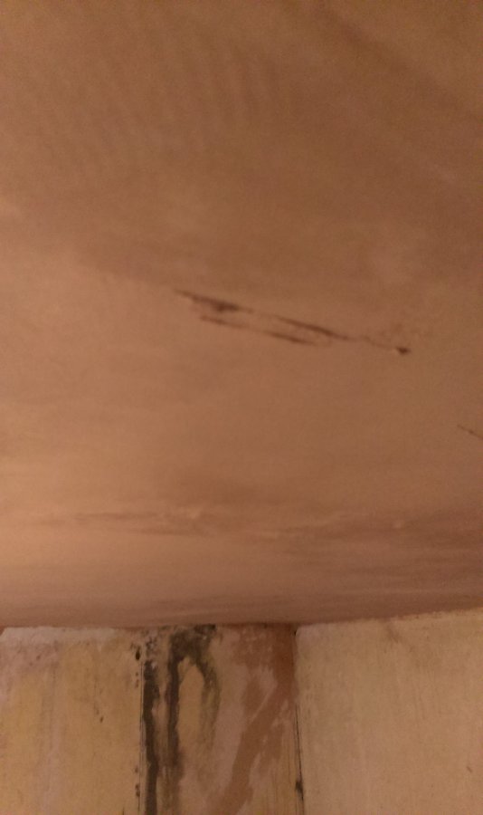

Hi, i have skimmed my ceiling - it was old plaster that had partially collapsed. I did a bonding layer in the repair patch to level woith the original lath & plaster ceiling. Then i PVA'd the whole ceiling and applied the 2 coats of skim (multi-finish). near the end i dolloped a big load into my eye! and after a wash rushed the last bit of the ceiling and did not get around to doing a final polish trowelling before goint to A&E to get my eye properly cleaned :(
Today, i notice that there are some areas that are not up to standard due to me not finishing the polish coat :( how can i rectify these areas? should i just mix up a small amount of skim and re skim the bad areas and the polish?
I hope the photos show the areas well enough...

We've all done that. If it were me I'd PVA the ceiling and re-skim. Quicker than messing around with it.
In that case scrape off any high spots, pva where the hollows are and use Wickes plasterboard adhesive as a type of plaster filler. Allow to dry and sand lightly.
Thanks again Joe-90. I have some B&Q ready mixed joint filler for some plasterboard areas - i will use that after a light sanding of the hight spots, then sand after it has dried...

Happened to me once luckily there was another spread onsite who finished my ceiling for me while I went to hospital , looking at your photos you can see you struggled with it, looks like you have a lot of snagging to do not just on the last bit all depends how fussy you are best tip I can give a novice is use a sponge float and plastic trowel if you wanted to go again ,there's an awful lot of filler your going to be using on that lid

i think i might try the filler on the areas that i am not happy with, and if it still doesn't look great, call a professional

The above is sound advice, and will obviously do the trick but given your efforts pre-accident i'd go with the suggestion that you get a professional in to skim over.
Your edges where the ceiling meets the walls also looks rough - a plasterer could deal with that as well.

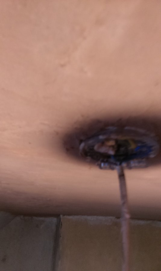

FWIW: the light fitting looks as tho it could do with replacing - dont mess with it change it out.
