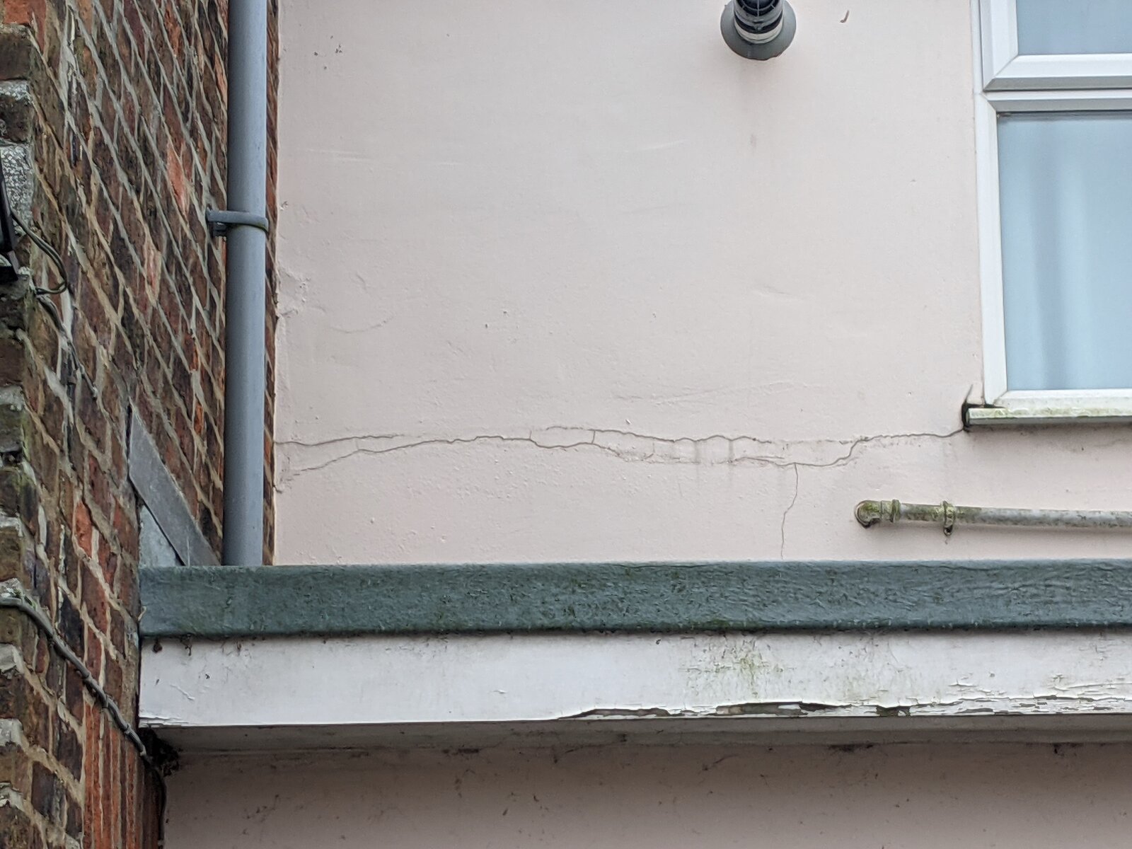

How do I fix the crack on the attached pic?
Also how do I get the colour right?
Exterior caulk/flexible filler. But due to the nature of render you’ll always still see it as you can’t sand it down. Colour will also show unless you repaint the whole wall.
As above but I would paint the whole bit- it will also help the (exterior) filler
