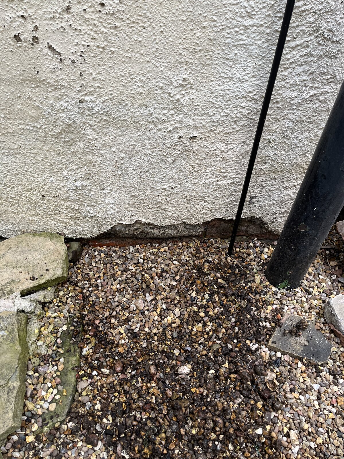

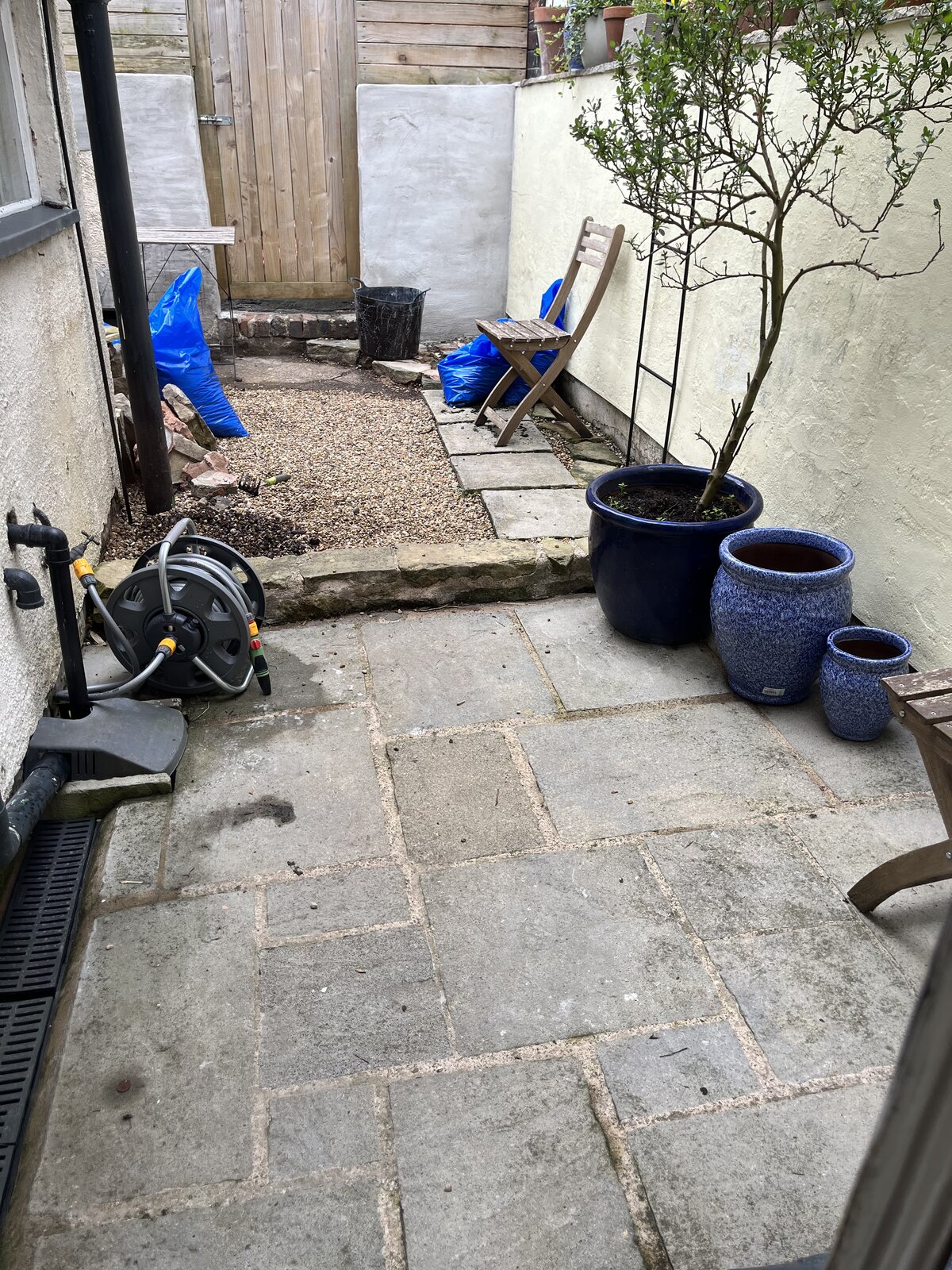

Hello, I have recently moved into a Victorian terrace with a small back yard which has a small patio area and a slightly larger pebble-floored area. The patio area is clearly sloping towards the house and has a drain to deal with the runoff.
I would like to replace the pebbled area with patio and am trying to find out whether I should keep a border of pebbles or if I would be better putting a drain channel flush to the wall, as already exists on the existing patio section. On removal of the pebbles, I believe the distance between the DPC and the floor is 150mm. The drainage channel I am looking at is 50mm so the distance with the drainage channel would therefore be 100mm, which I understand is below the recommended, but surely this would still be better than the existing pebbles which is barely 50mm below the DPC? Or am I mistaken?
First time doing anything like this and so am wanting to get it as right as possible and open to anyone more knowledgeable to give any advice!
Pictures below

Not my area of knowledge however.
I think your better off with drain.
Gravel works around houses keeping water away from masonry but you can put a drain in no problem , as you have pipe to take away.
I’d be comfortable with 100mm, I think the drain helps run off water as you say but the min height is to deal with bouncing rain I think
