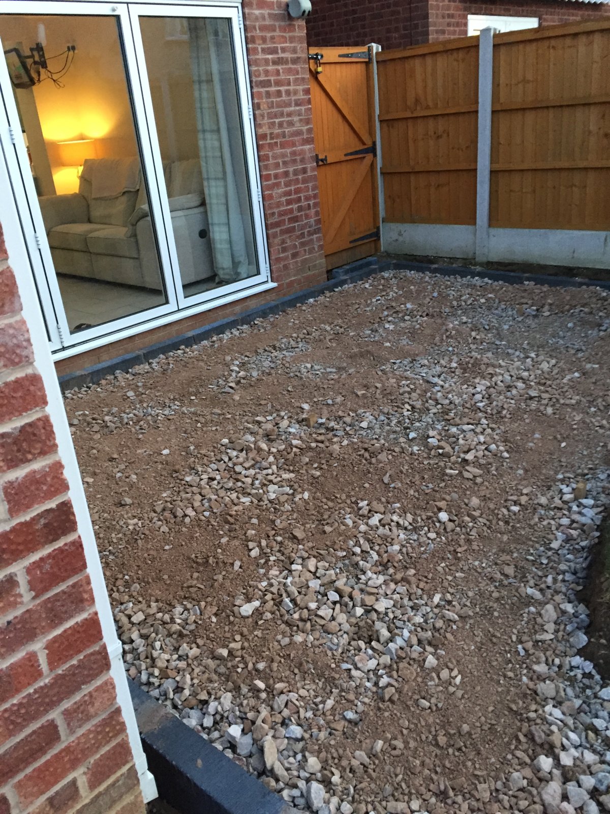

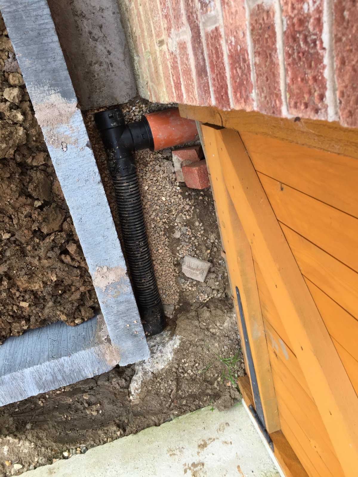

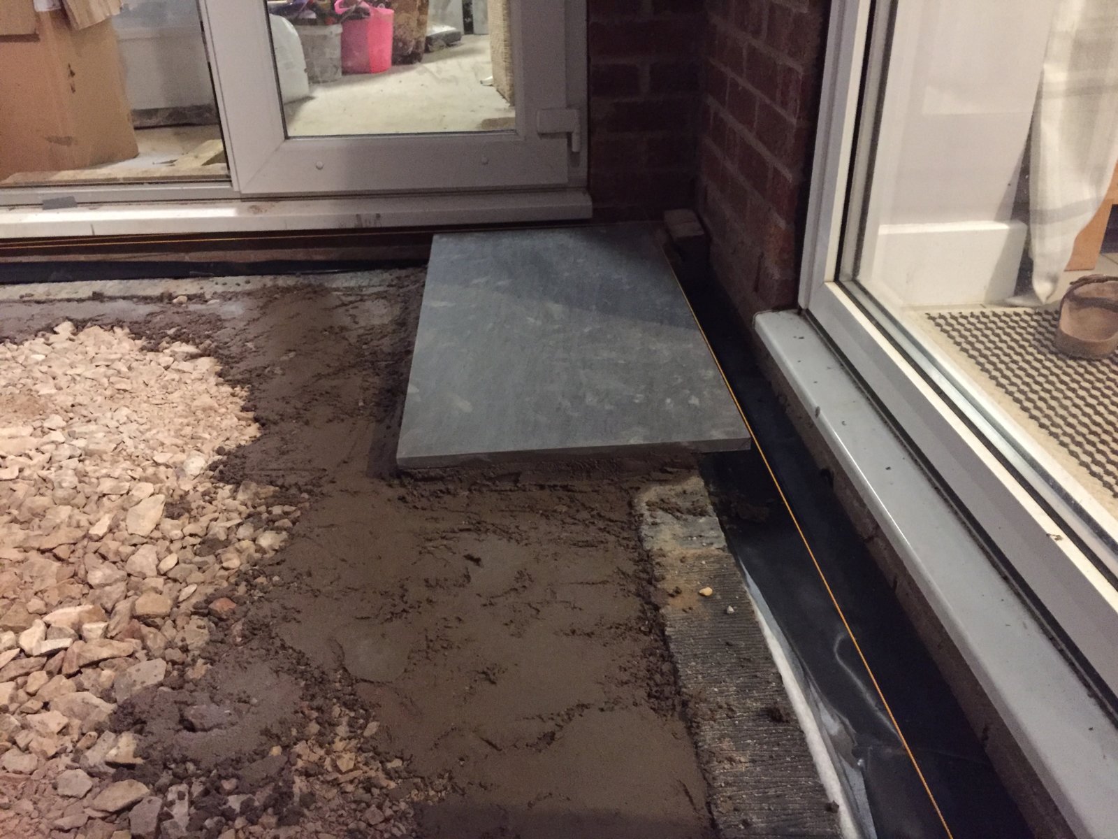

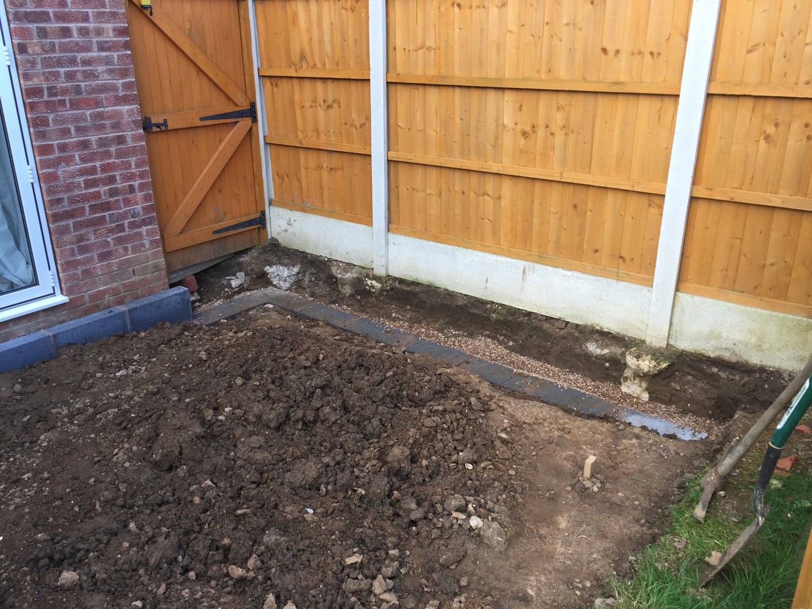

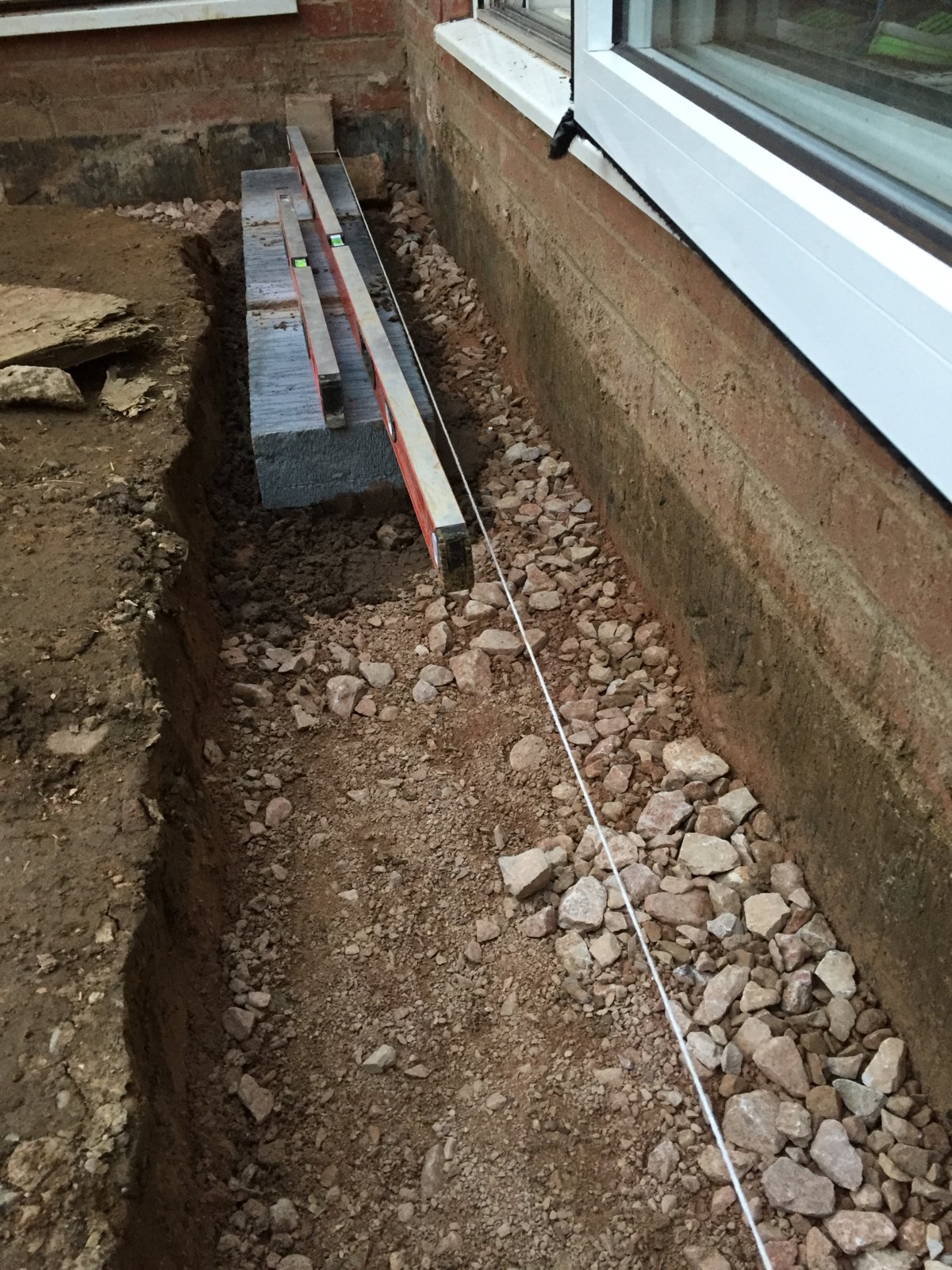

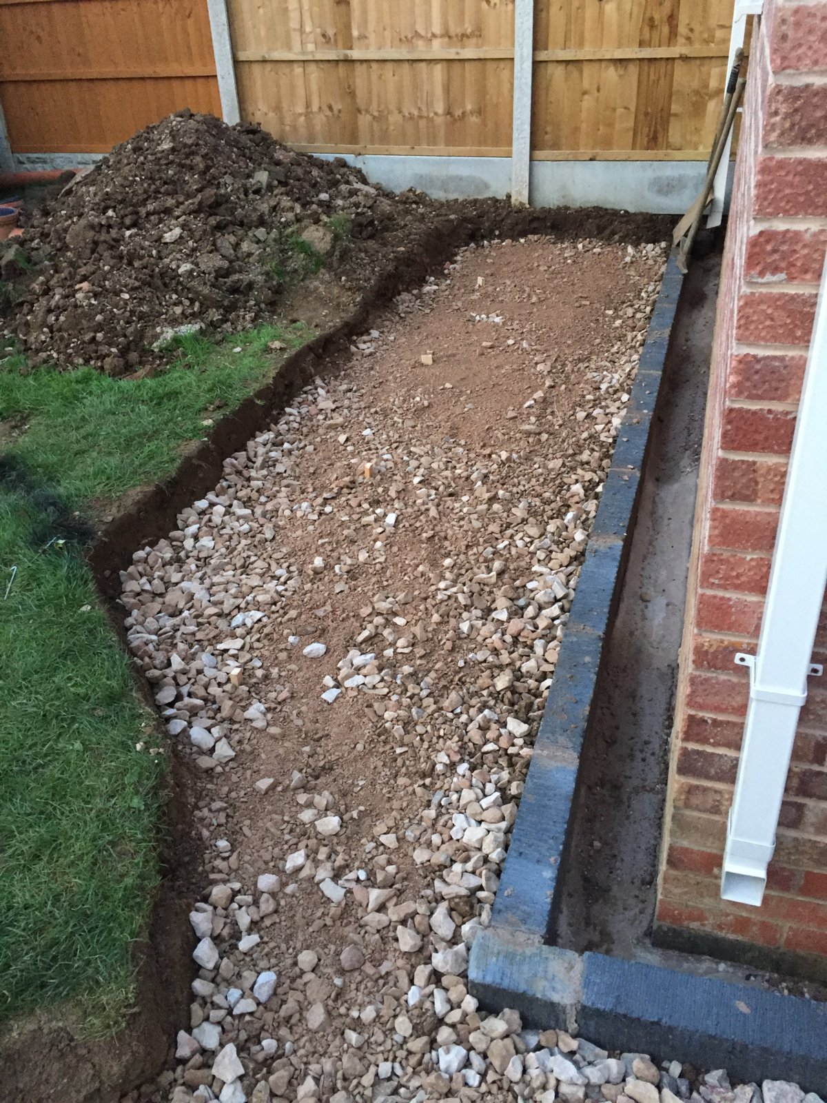

Here’s a load of photos of my project so far, if anyone’s interested!

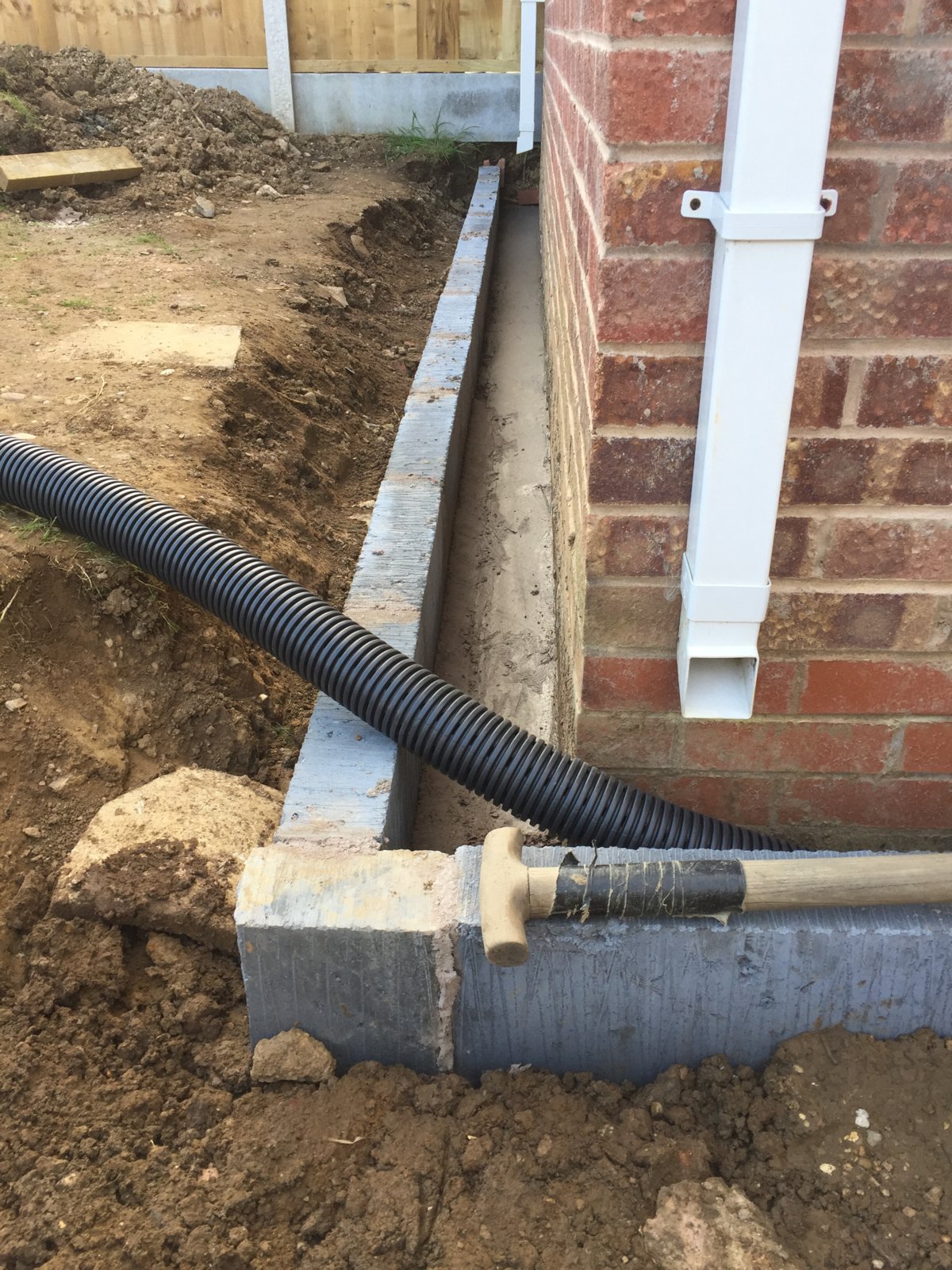

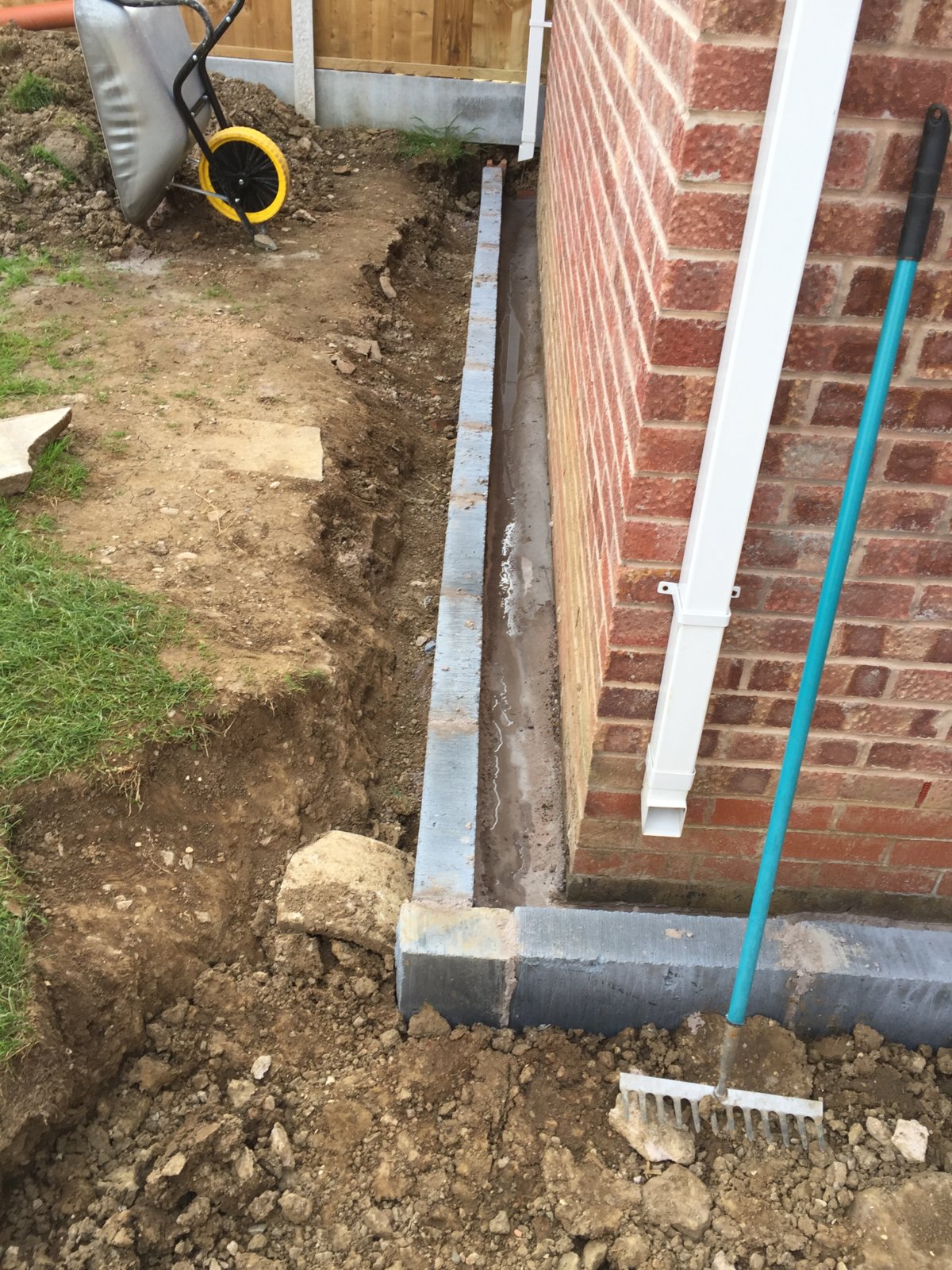

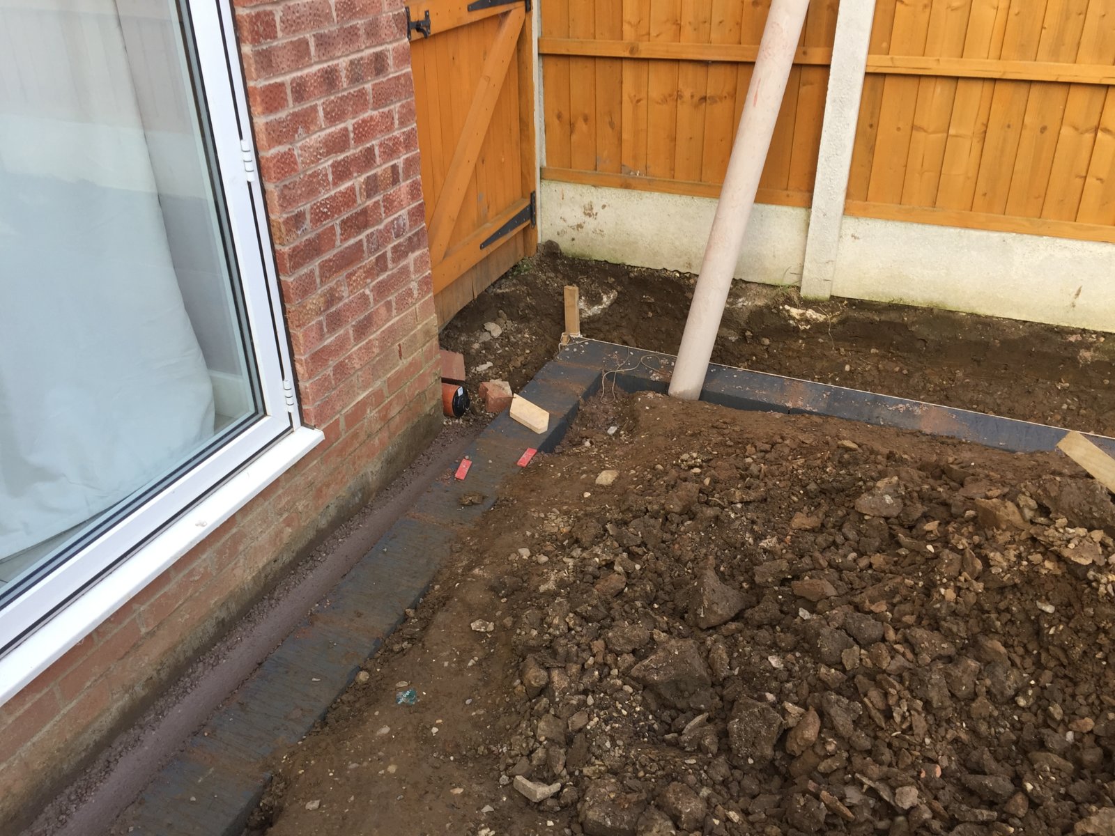

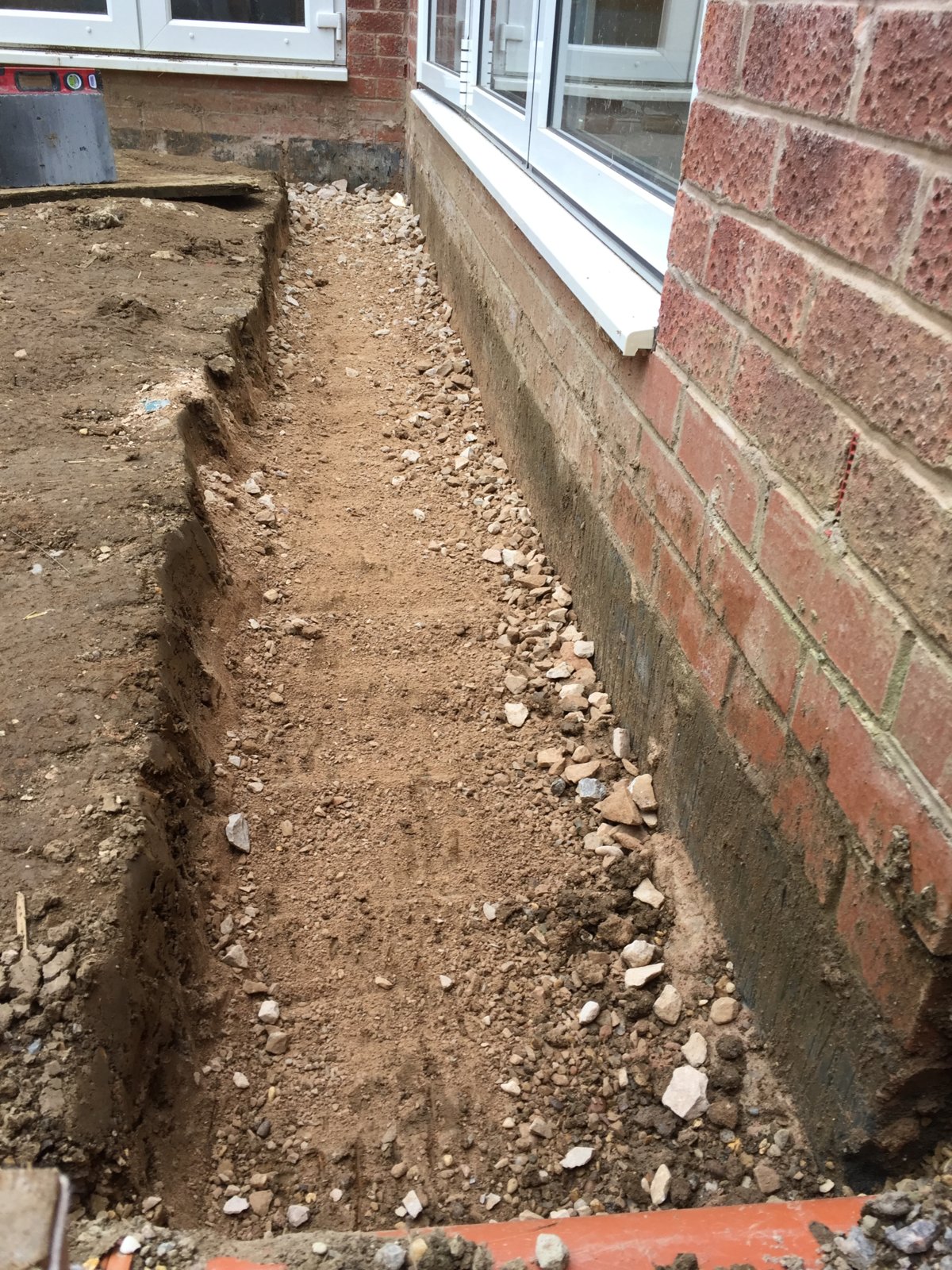

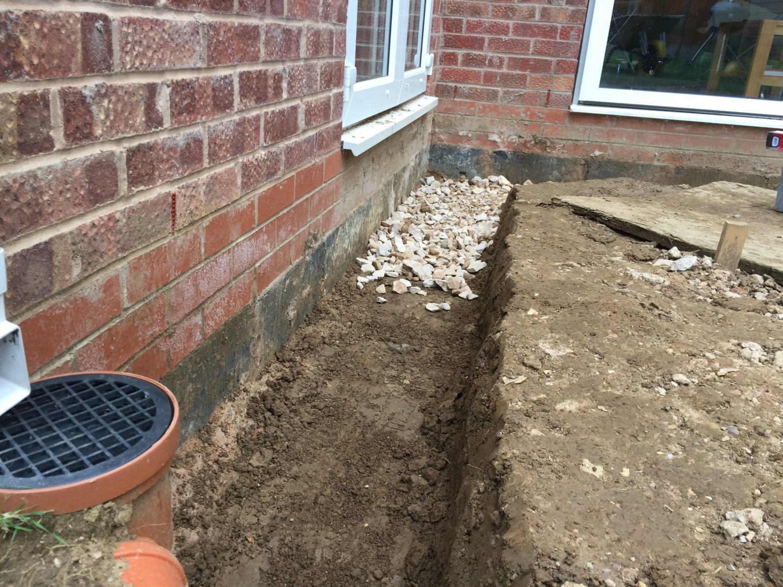

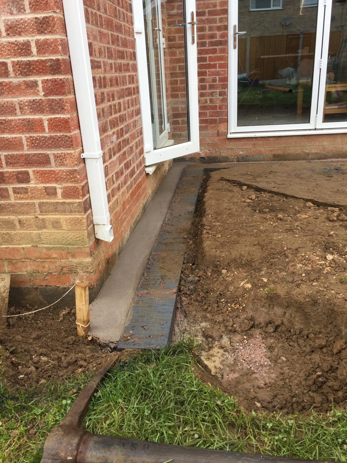

I dug out a channel between the house/garage and planned patio area and built a small restraining wall with breeze blocks to support the slabs.
The channel is graded towards the surface water drain down the side of the house. I mixed some concrete and sloped the base of the channel away from the house.
I then bedded a perforated land drain pipe in the bottom of the channel and connected it the the surface water drain pipe.

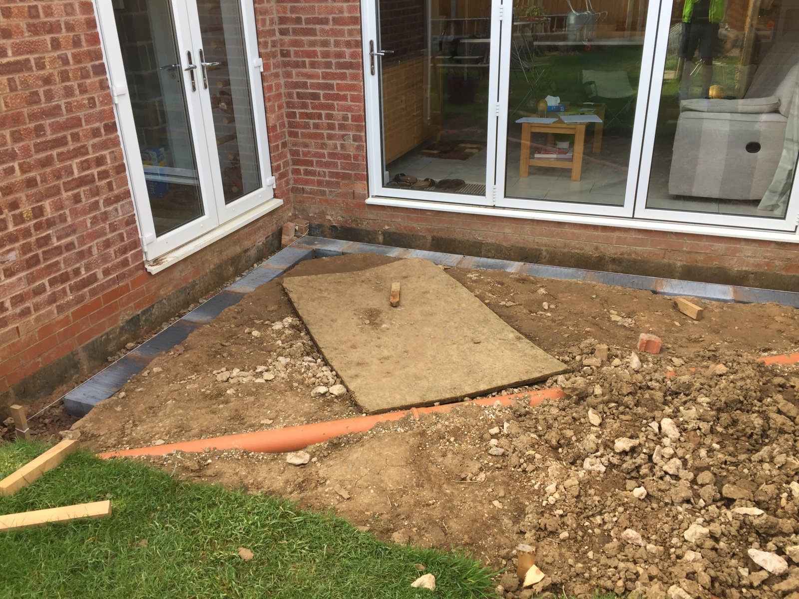

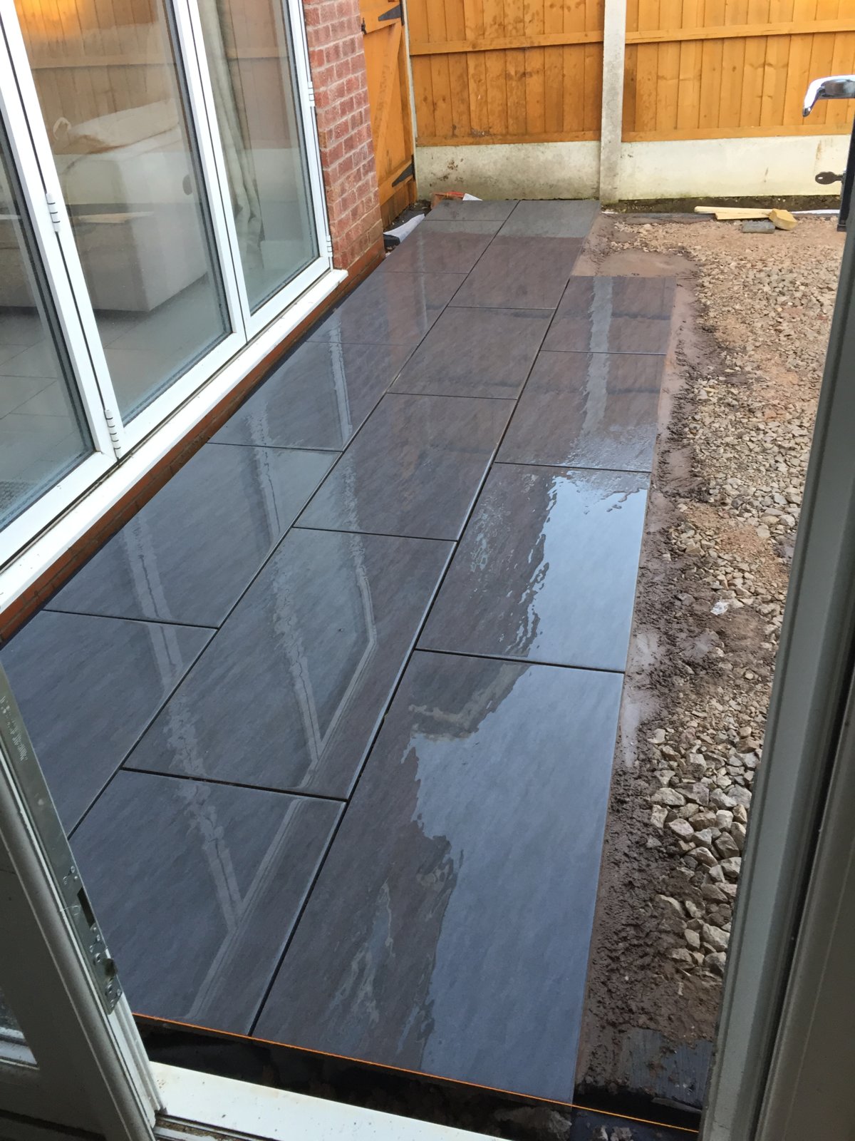

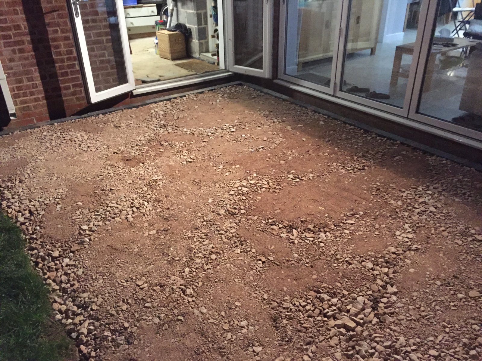

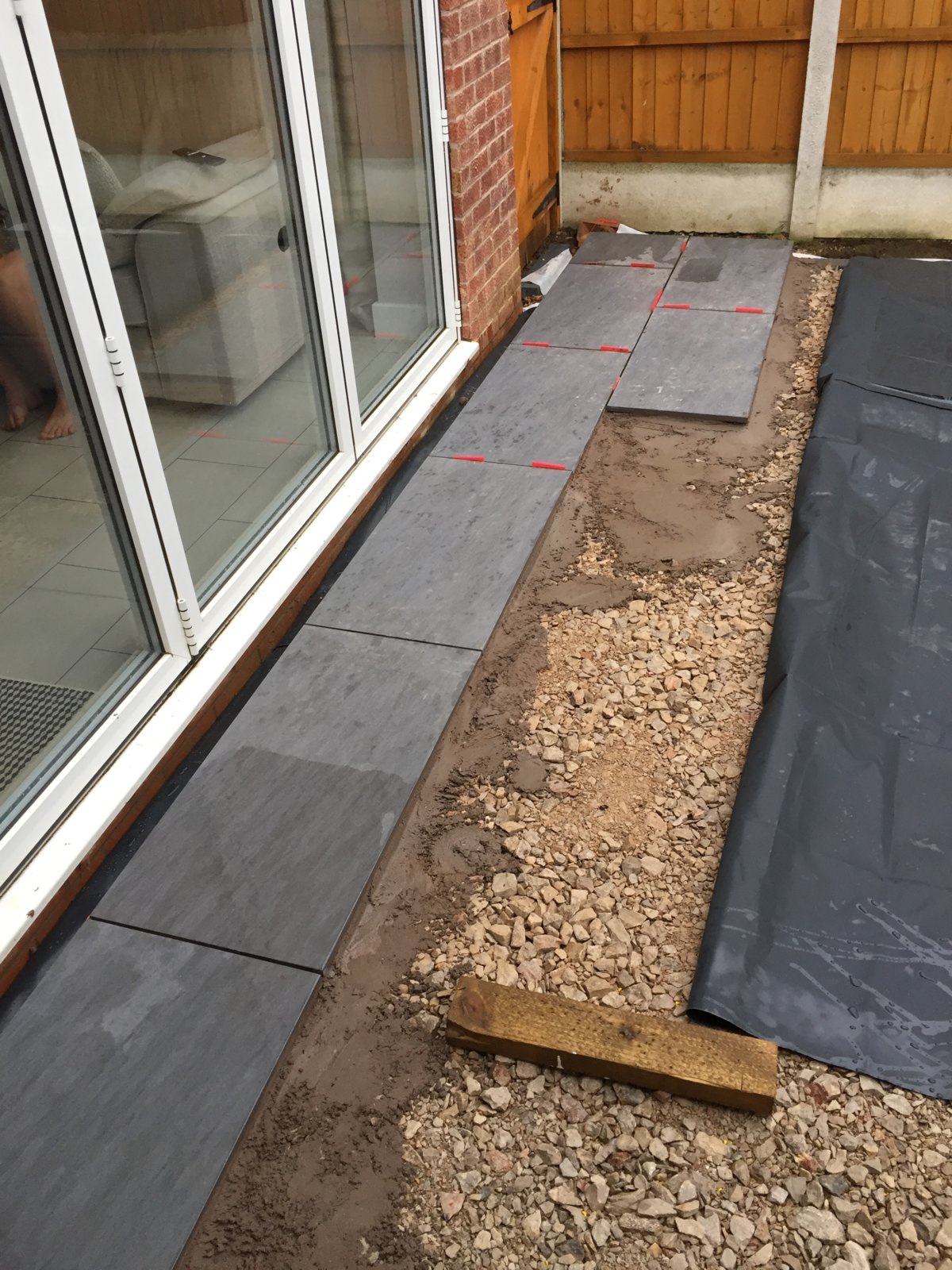

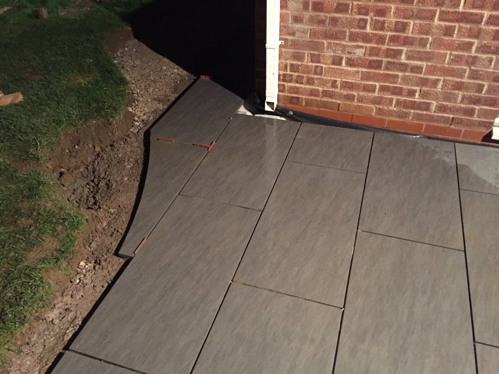

I proceeded to dig out for the patio so finished level would end up level with the DPC and creating a slope away from the house & garage.

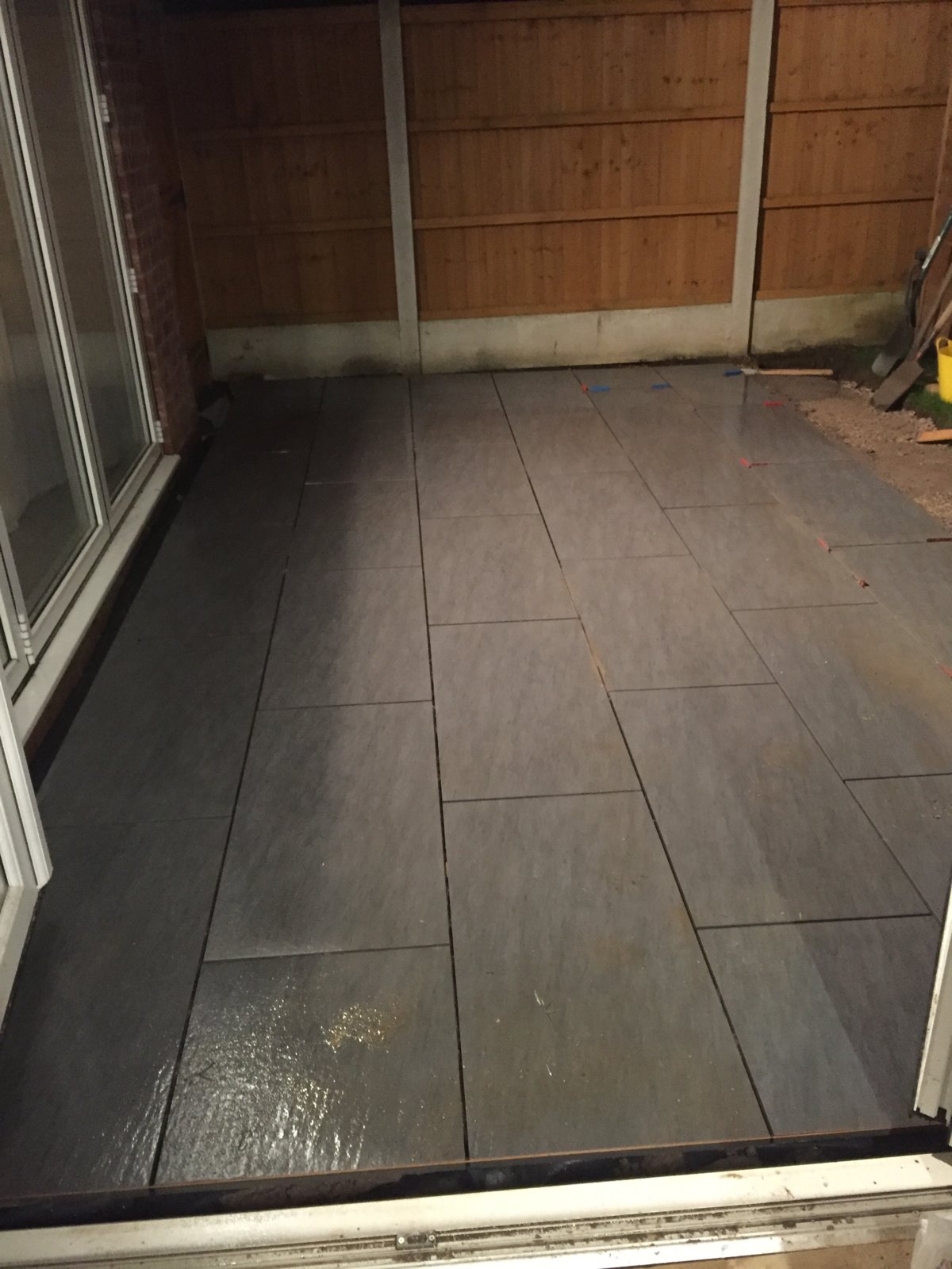

Then I filled with hardcore and compacted to level with my dwarf wall (obviously still making sure my falls were correct) and started laying my 900x450 porcelain slabs, overhanging the breeze blocks but still leaving a gap to the brick walls.

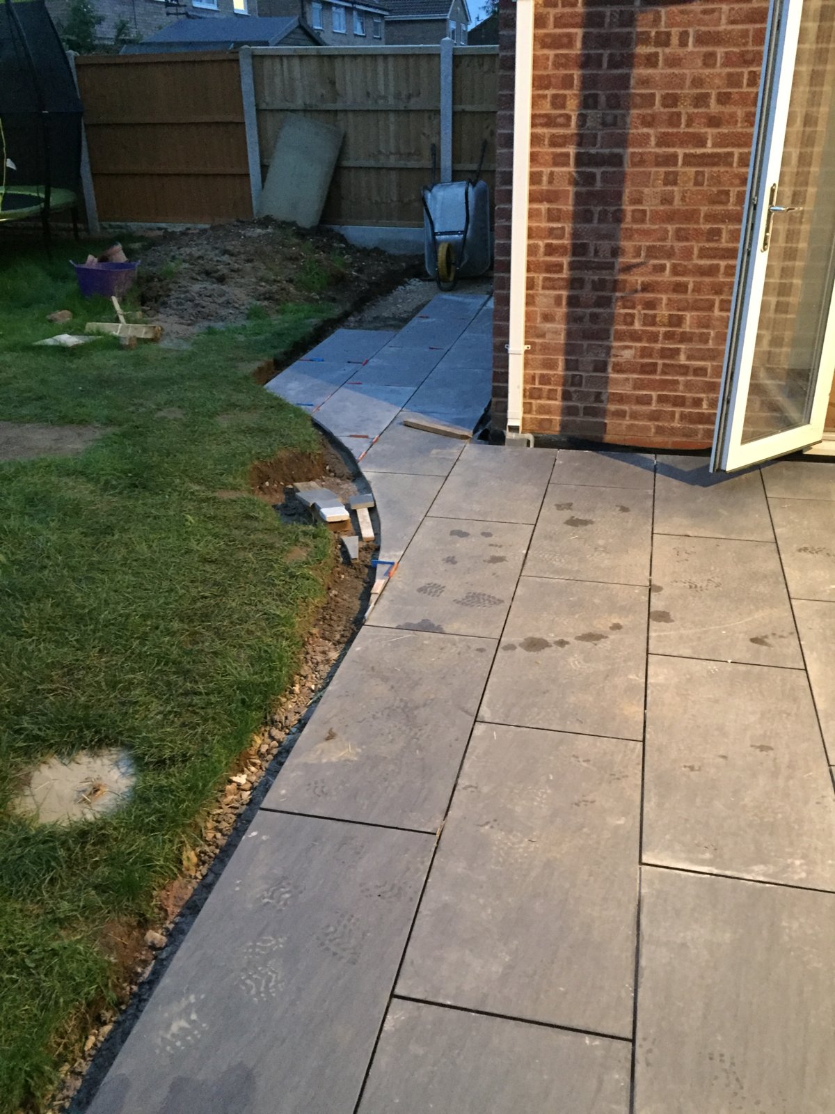

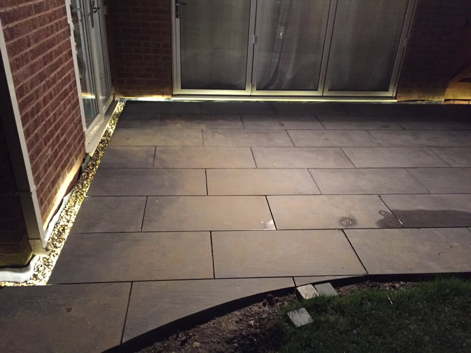

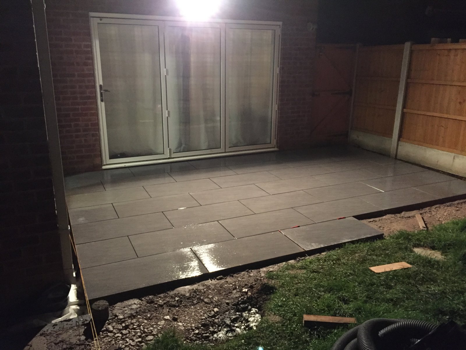

I wrapped the the perf pipe in geo textile fabric with washed gravel and backfilled more gravel. I also fitted some DPM between the house/garage wall and the gravel.
Obviously it is not finished yet, but it’ll have to now go on hold till next year.
Thanks for all your help and advice.
I don’t know if the drain is an overkill or not, but after all the rain we’ve had in the last few weeks there’s no standing water anywhere.

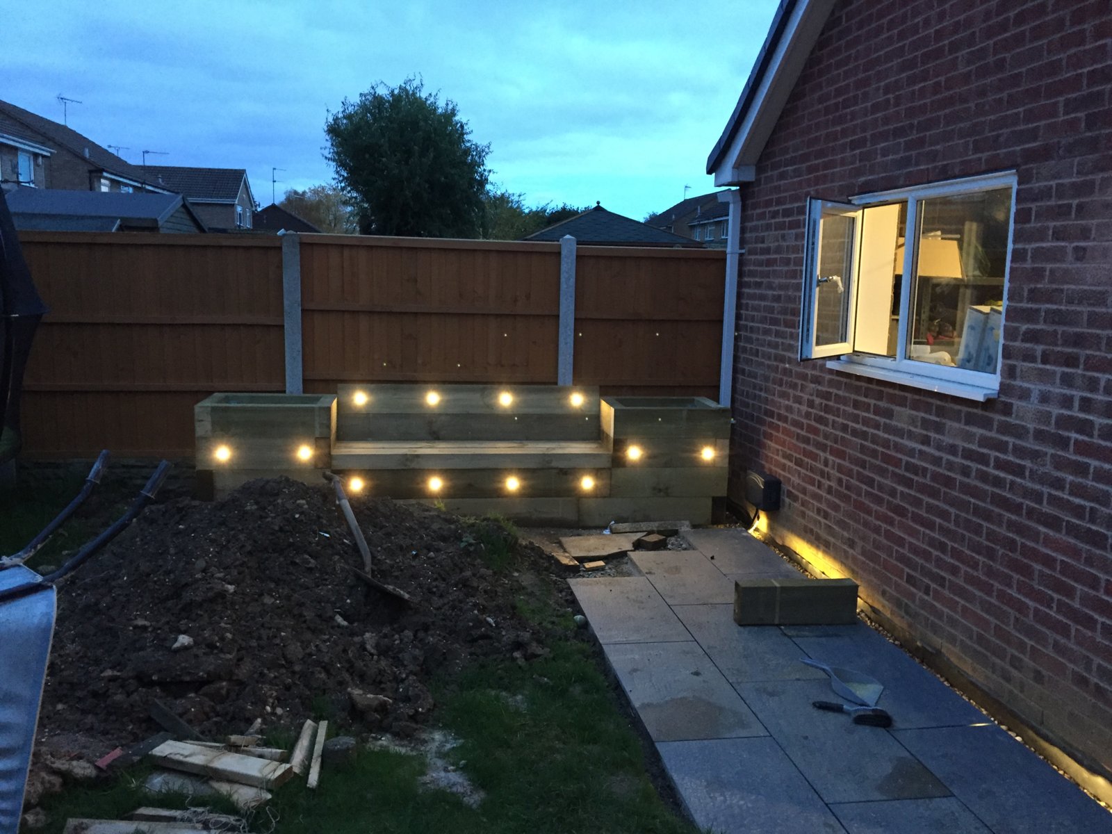

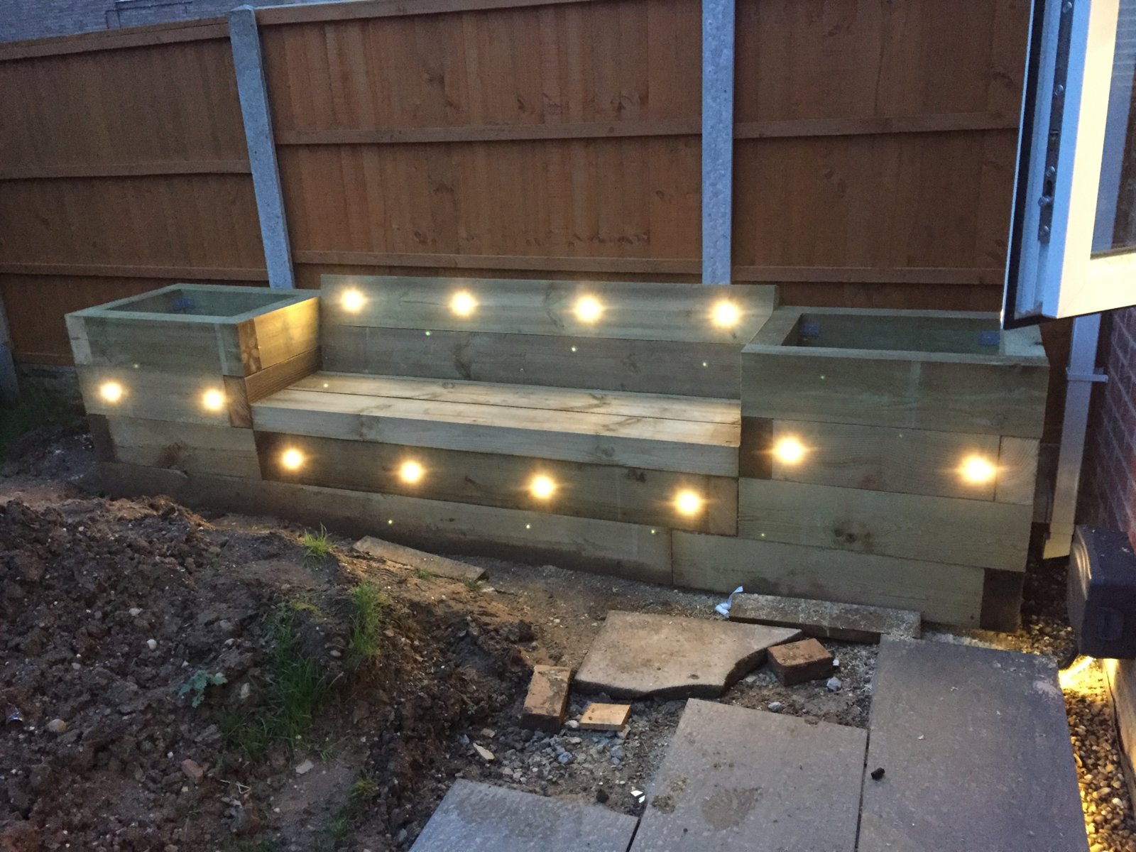

I’ve also built a sleeper planter bench and added some lights
