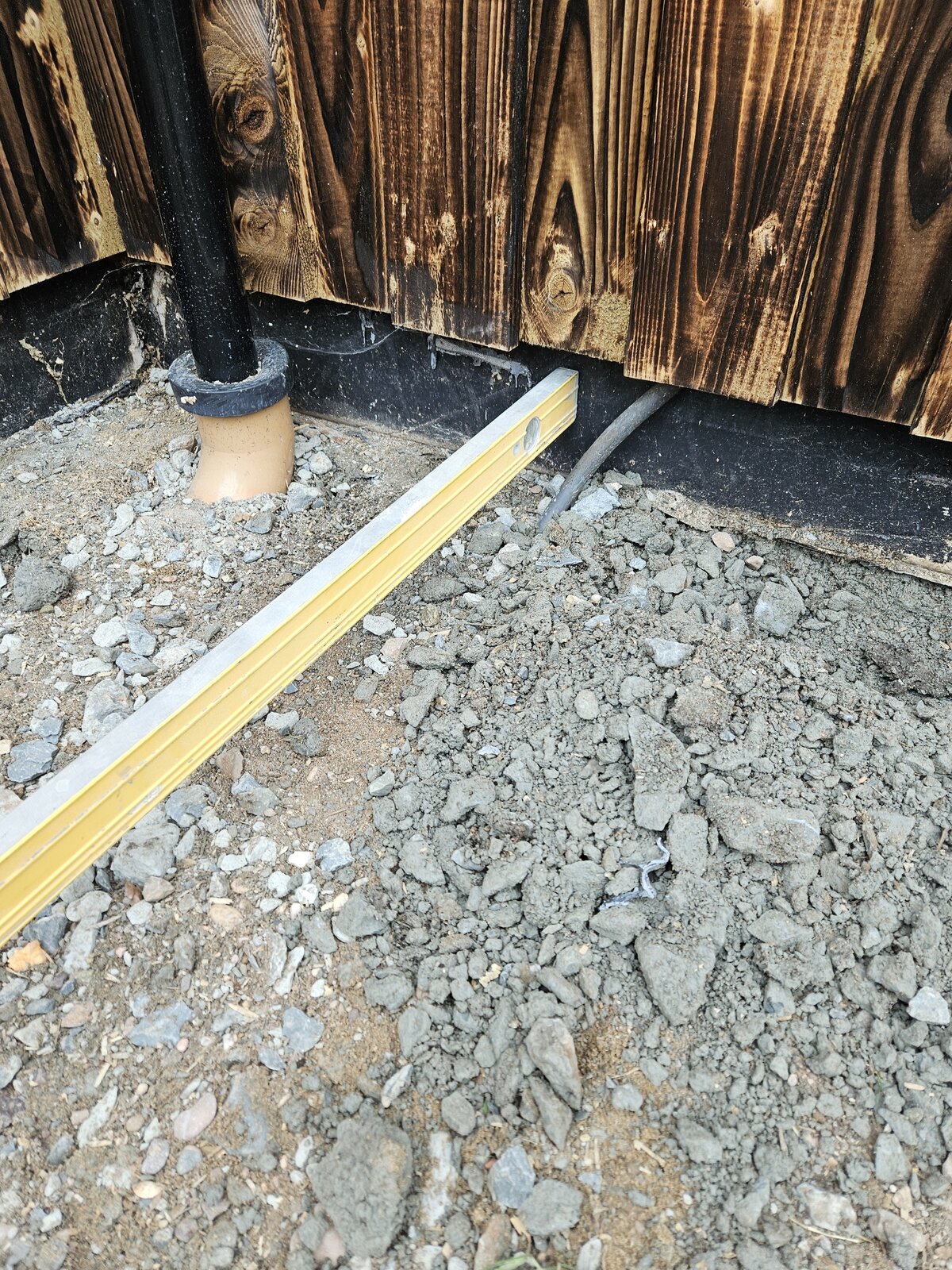

Question, our new patio we're putting in joins onto our shed and will be at the height of the bottom of the spirit level, it's 100mm from the bottom of the shed and the DPM, would it be okay to put the patio in at this height? Should I put in a gravel channel around the outside of the patio between it and the shed? Cheers

It's not clear from the image, where the surface water will go, once paved. If the paved area is locked in on all sides, then it needs falls to a gully. As does the run-off from the shed roof.

Shed roof runs into down pipe and into surface water drainage, patio will be sloped away from shed into drainage channel opposite side of the shed
