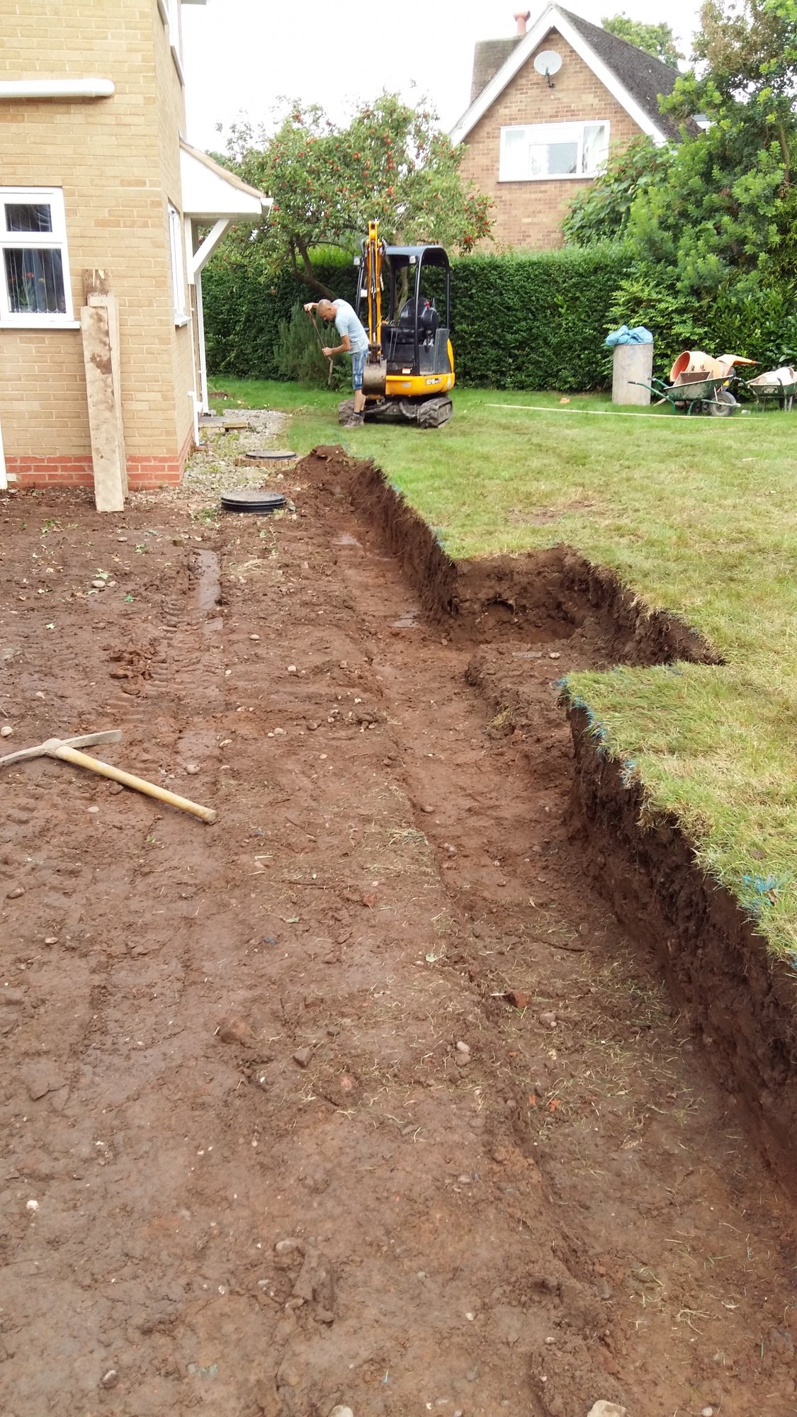

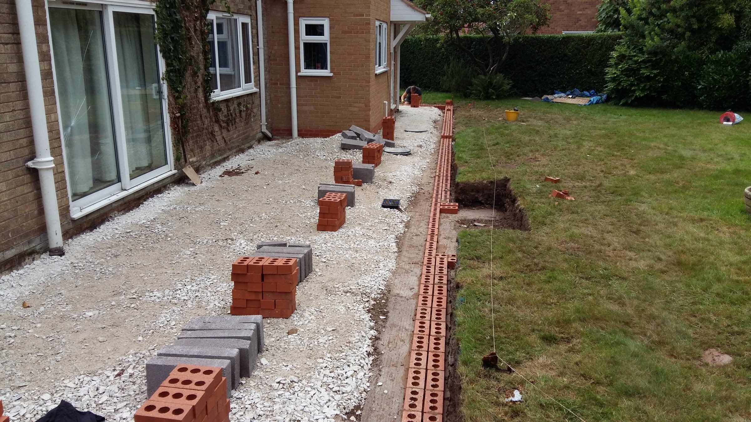

Solid bedded.
Jointed using the bedding mortar.
Point as you go.
I'll post some piccies of our current jobby in the a.m.
That looks a top job. How come you need to use a Hcore base if you are also screeding fully with a sharp sand mix. I would have thought a screed base would be enough for foot traffic.
What do you seal the patio with ?
It's better to have a granular sub-base even if you think you don't need it.
You can shape it according to falls.
It will accept a certain amount of rainwater and not leave you with a muddy shoithole.
It will help draw the moisture from your joints and bedding and allowing you to get on the slabs and point the same day.
There is a product at our local BM that I'm looking at using. I'll keep you informed. I've never laid this type of slab before.
Thanks, I do pride myself in my slabbing. I set the walls out so that they just work in slabs + joints. Looks better for it too. I used moderate falls because the slabs are so precise and not riven. I even worked out the gully position so it fell on a slab joint. Ill finish around the chambers on Monday and complete the steps up to the lawn.
